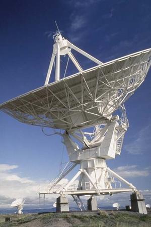

Why stop with BUDs? Why not three of these?
