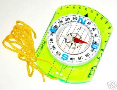

Yes, you need a heading compass, similar to the one attached, set/aim to the correct heading and eyeball around 45° (depends on your location as well) up from the horizon. It is a generalized best guess method without a great expense. In 15 years I have never had any trouble with this method.
