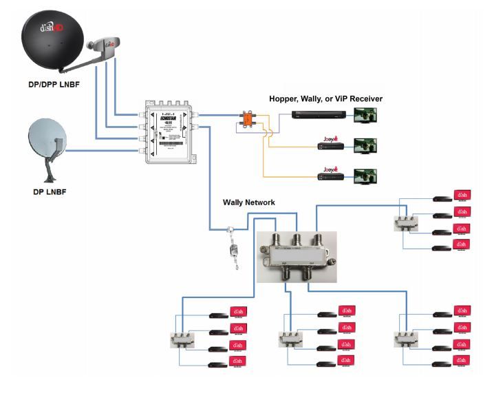

https://manuals.solidsignal.com/DPH42_Installation.pdf

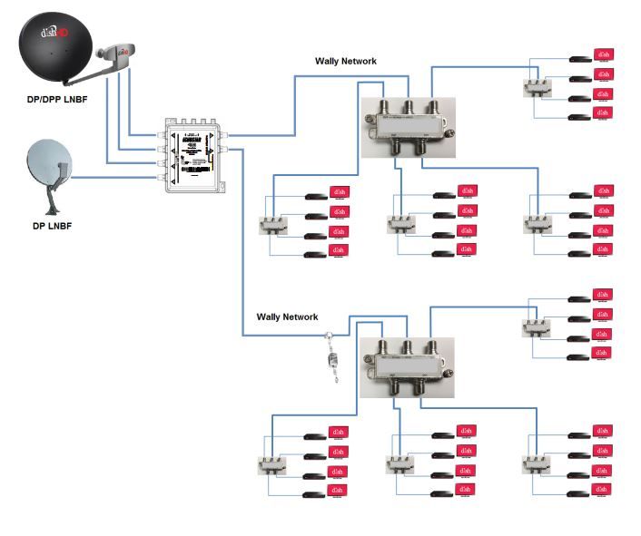

the 2nd image is from before Wallys had dual tuners. Capture.JPG Capture1.JPG
Register to hide this ad
With the dual tuner Wally update you can have a whopping 64 tuners total. So in theory 4 H3's should be possible. Which I doubt dish will ever allow for one household. But in an apartment setting one dish can cover 32 apartments with Wally's or 4 with H3's. In theory of course.
