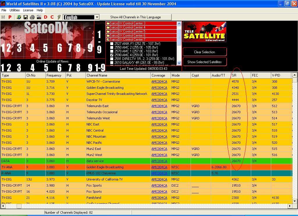

Another way to find SR (and all kinds of other info) is to buy a copy of Tele-Satellite magazine.
It will give you a registration code for a nice program called "World of Satellites". I find it much easier to lookup info than Lyngsat's web site.
See attached picture.

I'll definitely get a sub to that magazine if only I knew where to sign up. I'll have to keep an eye out next time I'm in the grocery store or book store. I don't suppose they have ports of that program for MacOS X or Unix & its brethren... :confused: oh well, if not, I can prolly WINE it in Linux on one of my PCs. ;)
You can subscribe at the magazine's web site:
http://www.tele-satellite.com
One thing I dislike about the World of Satellites program is that it expires every 2-3 months (I am not sure about the time interval) so you have to "refresh" your activation code that can be obtained from the next issue of Tele-Satellite magazine. That's alright as long as you buy the magazine but I don't like the idea of having to keep buying the magazine to get the program going.
Having said all that I do like the program since it has all the utilities from dish pointing to satellite guide and you get that information updated regularly.
I don't think they have *nix or MacOS port unfortunately.
I've seen somebody (Sadoun?) selling individual copies of the magazine on eBay. Of the three Barnes & Nobles I frequent in the Denver area, only one carries it. Maybe you could call around to the bookseller chains in your area.
I've used the software occasionally, but the reason I buy the magazine is for the magazine. It's very Euro-centric, but its unique content can be fun to read.
