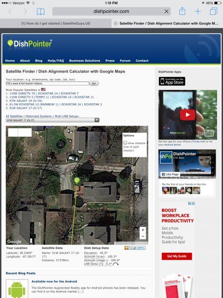

Good to hear you may have a prospect for a c band dish. Go to www.dishpointer.com and enter your location, then zoom in on the map until you can see your property and drag the marker to the spot where you want to plant the dish pole. You can then use the green line and the obstacle checker to check out the different satellites you are interested in receiving and make sure the dish can 'see' over any obstructions that may be present. Use www.lyngsat.com and www.sathint.com to see what is available on each of the sats. :)
P.S. Looks like 87W (SES 2) is nearest to true south for you at only 1° off. :)

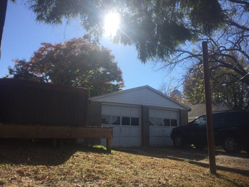

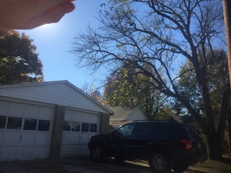

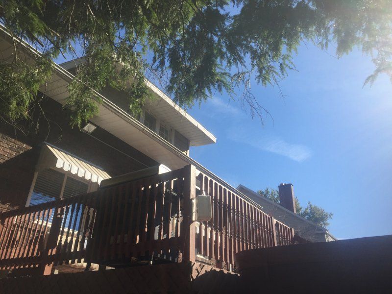

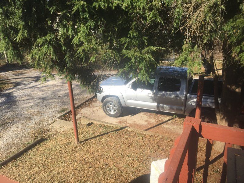

The problem I'm worried about I have trees all around me so the only spot I can find to hit most of the arch is right under a pine tree which I'll cut the lower branches out to get the view of the arch from there. In the pictures I'm planing on taking the old pole for the clothes line out and put the cband pole a few feet away from it so the dish will clear the driveway.

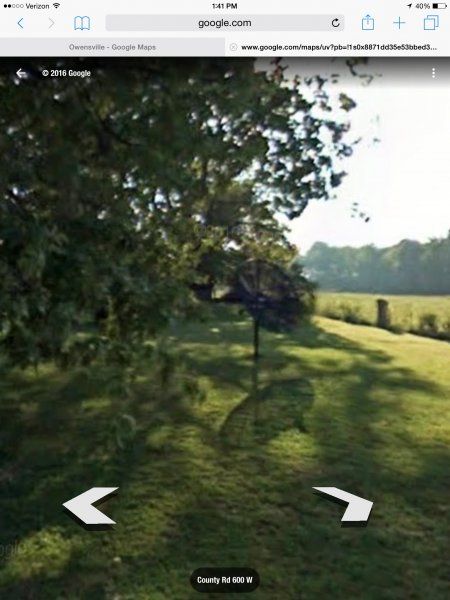

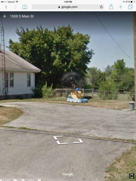

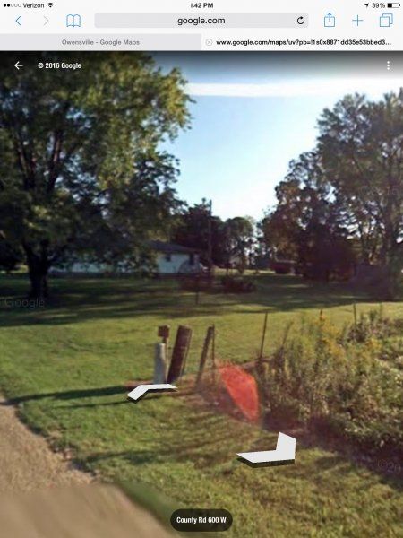

I don't have a picture of the dish but I used google maps to gets shots of it which are not good but I think it appears to be 8ft.
Looks like it may be a tight squeeze but with careful planning (using dishpointer to check obstacle vs sat location) it should be workable. Is the tree to the left (passenger side) of the dark vehicle yours (or a neighbor you are on good terms with)? If I understand the layout properly that would be to the west of the pole (and possibly where some decent sats are) so it might be beneficial to have the ability to drop a few branches if necessary. :)
That's the pain in the ass walnut tree lol. It belongs to my neighbors but we've been taking care of the yard for the last two years for her but she's in a nursing home now and no body lives there. We're wanting to see if we can have the tree cut down cause we're worried if it ever fell down it would massive damage to one of our homes. I've been using SatFinder Lite app but it's not the best but it showes I should get from 61.5-131

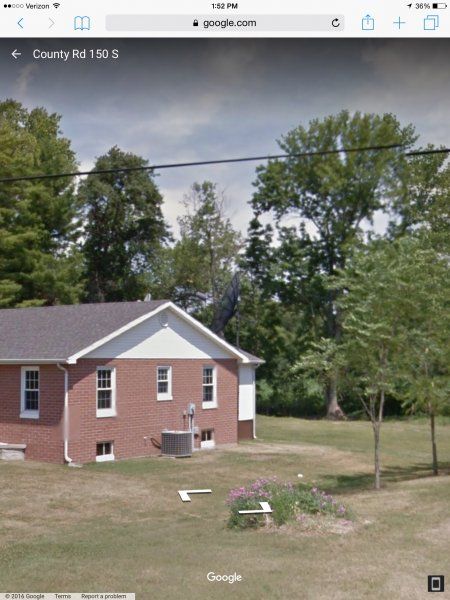

I also have my eye on these 2 dishs as well. The picking around here are slim thanks to all the scrapers a few years ago.
May just be my eyes but they both look bigger than the first you posted and the one on the ground appears to be pointed at a tree (so maybe not in use any longer). :)
I would love the one that's pointed at the tree cause it's easily a 10 footer but I half to watch how big it cause I'm still working on the boss at home to let me put it up. First one I posted actually belonged to them when they was with there ex years ago.
