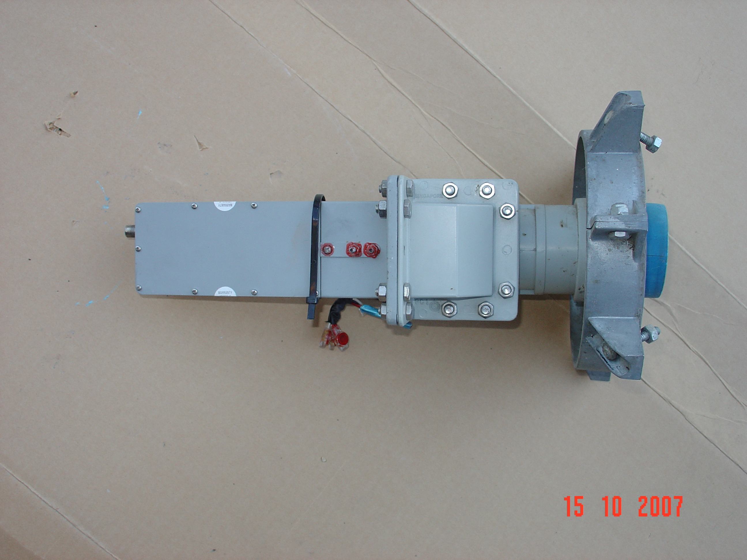

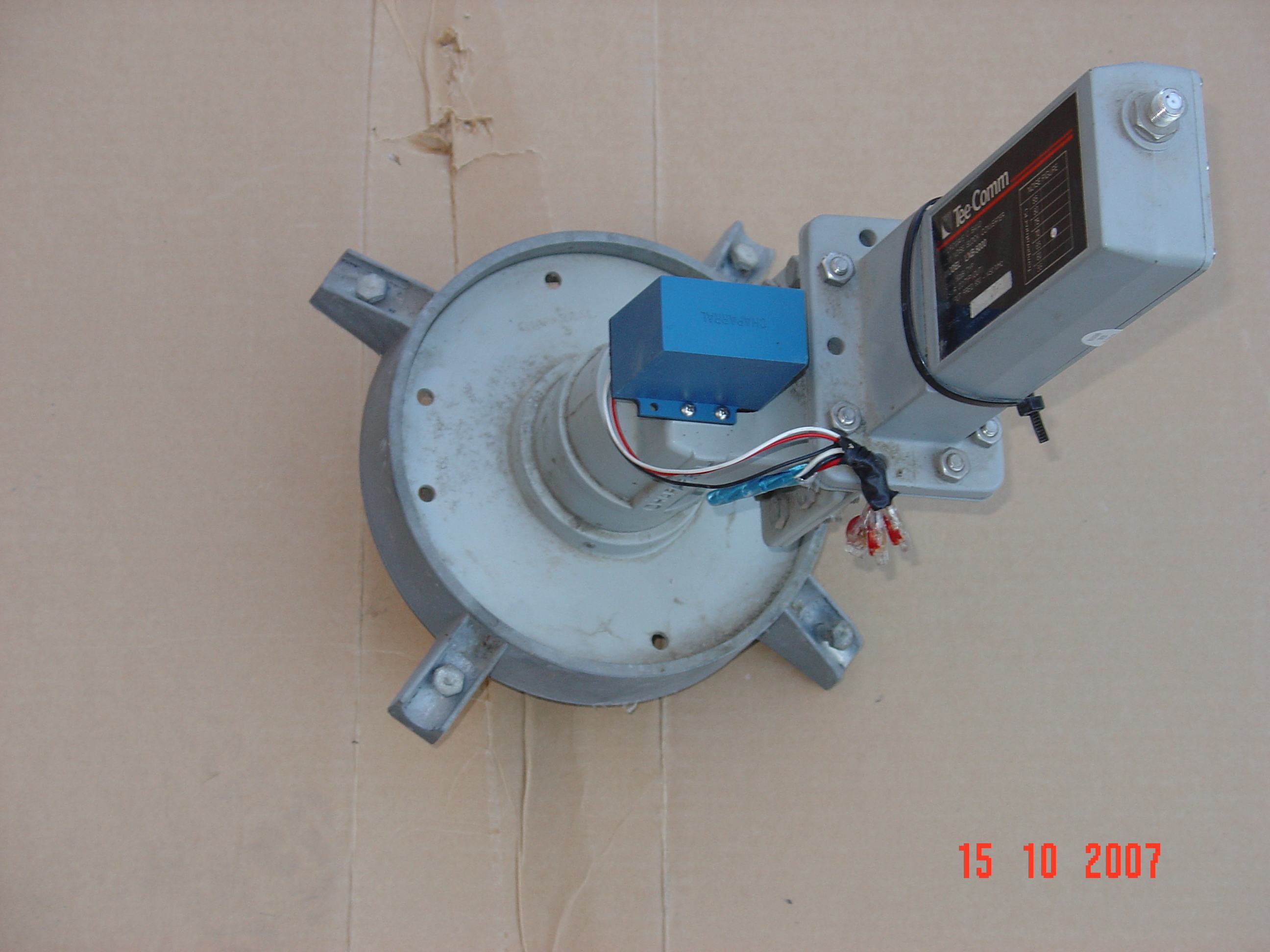

I'm trying to setup a big C Band Dish and I have been told that my Scalar Ring (which is 6.75 inches in diameter) that now holds an Old Chaparal and T-Comm LNB is too small to hold a BSC-621-2 C/KU LNB. See picture. If I purchase a Corotor II + LNB it looks like it will easily fit my existing Scalar Ring as I would just have to undo a bolt and Nut to slip out my existing LNB. See picture. Can my existing Chaparal LNB Holder be adapted to any other LNB's with the Tee-Comm removed?

if you can undo the screw holding the feedhorn to the scaler and measure the width i can tell you if it will work. other than that there are other options too like buying some elec conduit and making new feedhorn arms that are adjustable a bit more than the ones you have plus you should be able to fit any scaler to it. ( this is a 10-15$ option)

The Uniden doesn't control the Polarity through the Co-Ax Cable, it has 3 separate wires to do that function. So, a DC Block through a Splitter won't make any difference. I would (and do) prefer the Corotor II myself. But, if you want the BSC621-2, you could modify the Scaler Ring that comes with it, to fit onto the Support Arms (brackets) that support the one you already have and replace it? Also, do you realize that the BSC621-2 is a Universal LNB and only the lower frequencies will work with the Uniden on the KU-band side of the spectrum? (I think???)....

Wow, thanks for the very detailed replies Gabshere, and Lumpkin666. I need to carefully review all that you have suggested - but it sounds like the V Box III and the BSC - 621-2 may my the best options. Has anyone actually measured the diameter of that BSC - 621 ring? My Chaparal Scalar ring is 6.75 inches in diameter.
The hole in the Scaler Ring from one of mine is 2-1/2". I have one from SatelliteAV and one from DMSI (neither is a Universal ku). I only see one Scaler Ring laying around, I'm not sure which one is goes with. I thought I had one for each, but apparently not? I'm not currently using either, one is on a temporary dish and the other is in the store room. The one on the dish is from DMSI and it is about a 1/16" wider than the other one. I'm thinking since the other one is 2-1/2", the Scaler Ring I see must belong to it. Both of these BSC621 lnbf's are about 1/8" smaller than any of my C-band lnb's. Hope this helps.
Al
i can tell you this jsattv that the scaler you have is special for that dish
to get another scaler to fit it you will have to modify the mounting arms or use the current scaler. i've not seen another scaler that has the hook up like yours. this is not to scare you or anything just to let you know that a modification would have to be made to connect a different scaler.

Thanks a lot gabshere, yes that's the dilemma with my setup. One thing I think for sure is that the Chaparal Corotor II + should likely fit in my scalar ring since my existing assembly is Labelled Chaparal with the Tee-Comm LNB and by undoing the Nut that holds it - it easily removes from my Scaler Ring. See Scaler Nut and Bolt in Picture.
