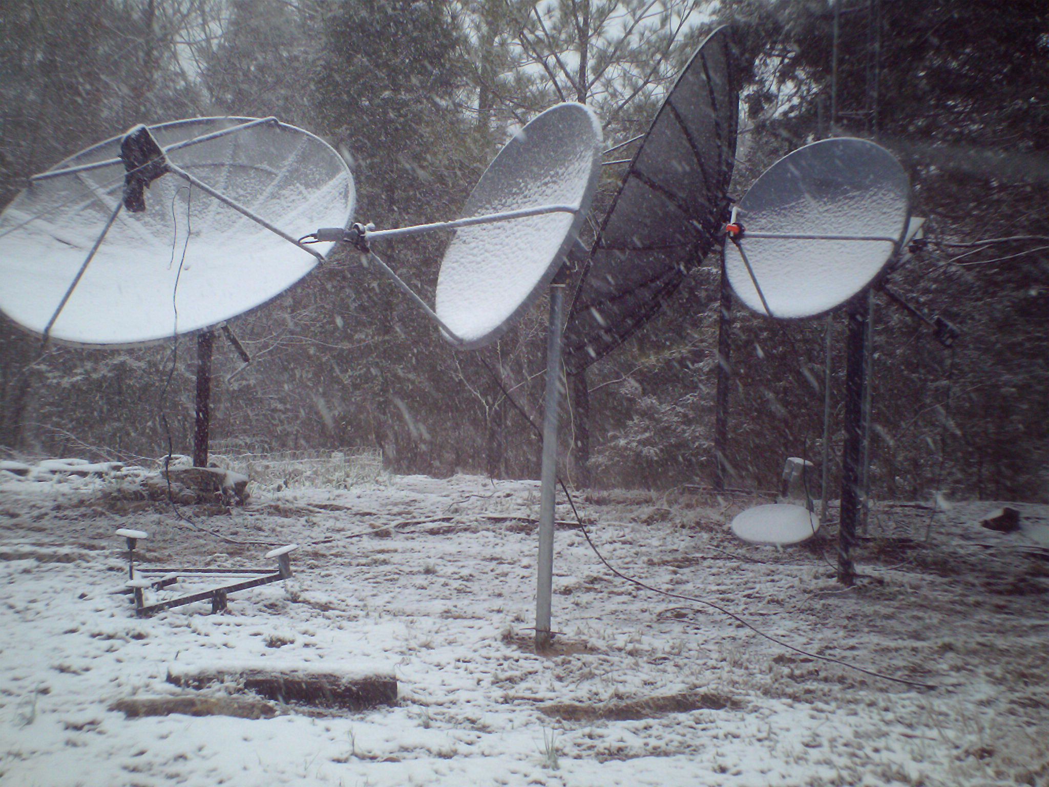

ta-da
This is about the extent of my snow, last year. Haven't had a reallly good one since the storm of 93. I used a street broom on my ONE big dish, back then, gave up after a couple of trips outdoors in the cold. Power went out anyway so tv was the least of my worries.
