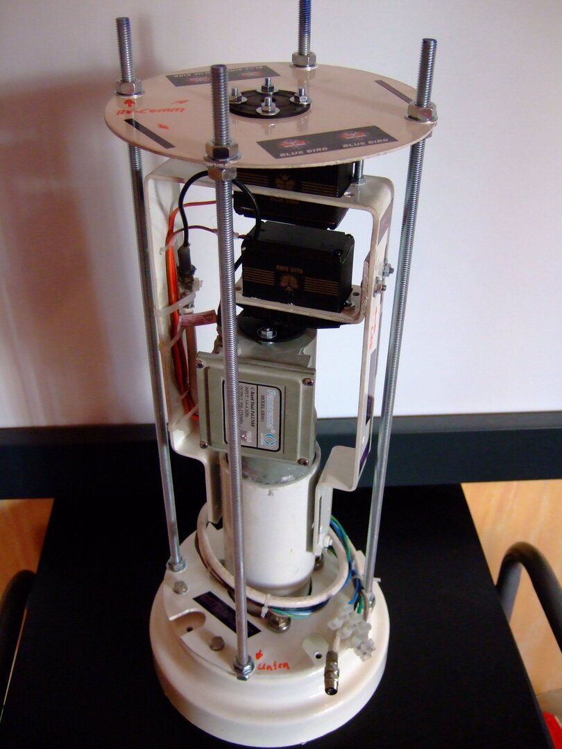

Hallo Members ,
I am looking for members who have also built something like the picture. like to get in touch with that person.

It would help to tell people what that is and what it does. It looks like it might do both linear and circular polarities?
Appears that is what it is: polarwandler ?!
Translation: A C band LNB with 2 servo motors suitable for Linear and circular reception, so with optimal skew setting.
Interesting device!
There was an example of a corotor feed that had one polarizer and two polarity controllers to accomplish the task in this thread
But the pictures were hosted off site and no longer available :(
Reactions: FTA4PA
Another cool idea for a project! :D
That's not what I'm talking about. I am looking for a self-made system, where the feedhorn can go forwards or backwards. and whereby the lnb can also turn, and that the scalaring can be set at the right distance. all at a distance ... and all for prime focus. Best regards
Likely, that is what it would have to be, self-made. I've never seen anything like that for sale, either pre-assembled or in kit form, or even plans for anything like it. Likely you would have to design and build one based on your dish specifications.
