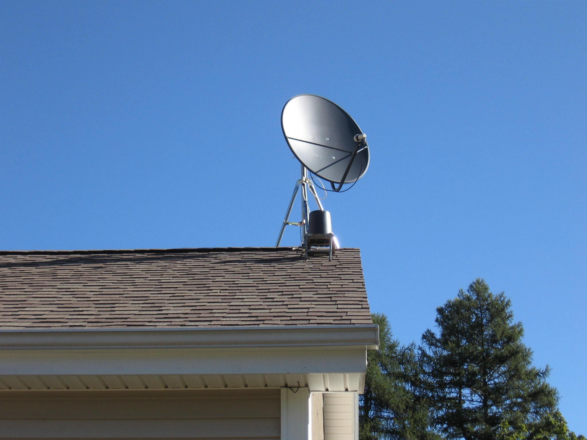

My 7.5 KTI is attached to a 20 foot pole which is in turn, mounted to a tripod on my deck and attached to my house.
The roof has a slight pitch which makes working on the dish do-able.
If I could have mounted it lower I would have, but needed the height to clear trees to my south and west.
Luckily I haven't had to make too many trips up there in the 12 years its been in place.

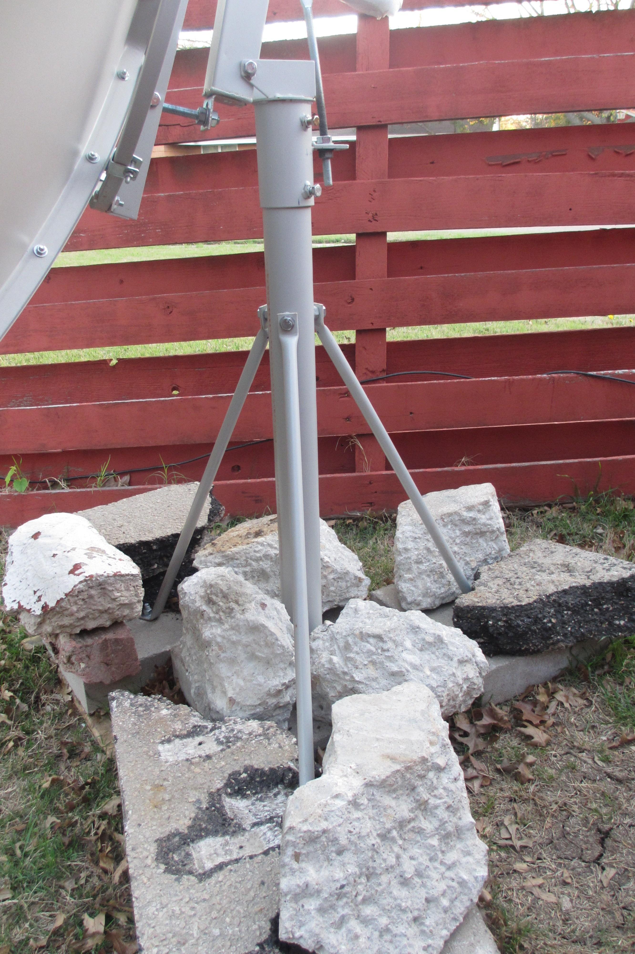

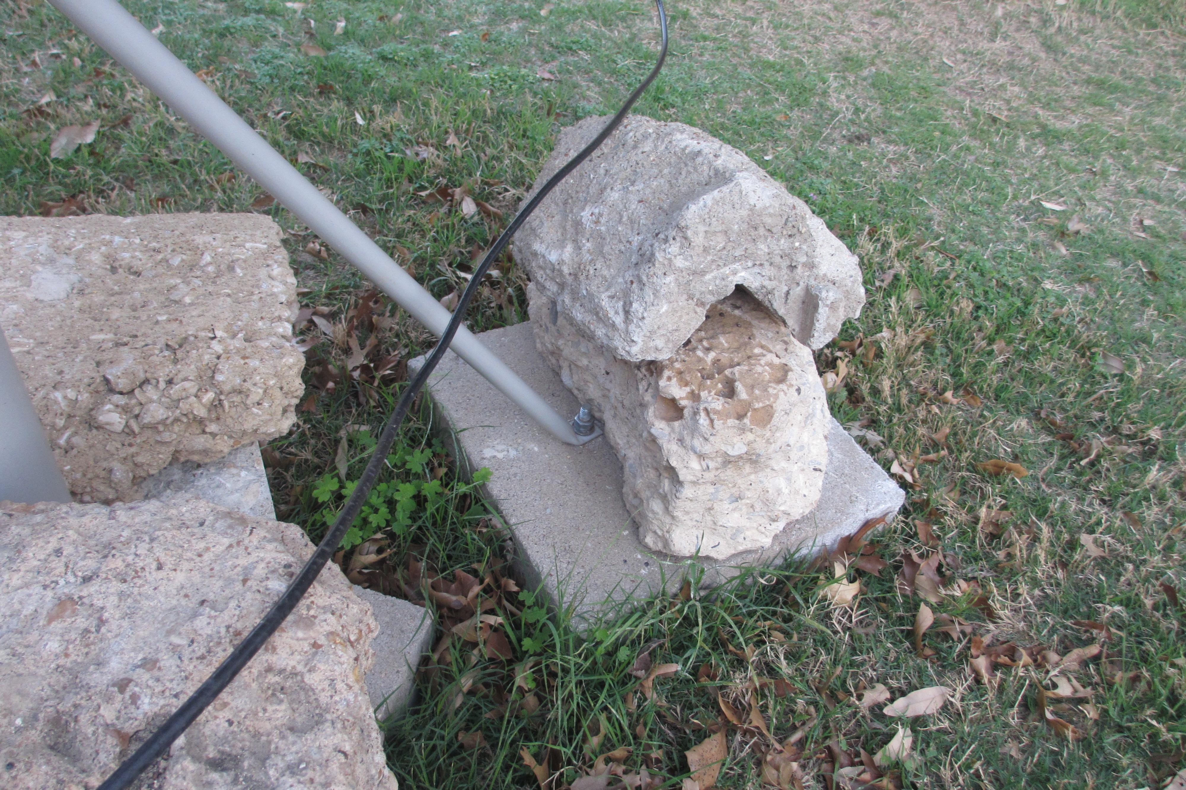

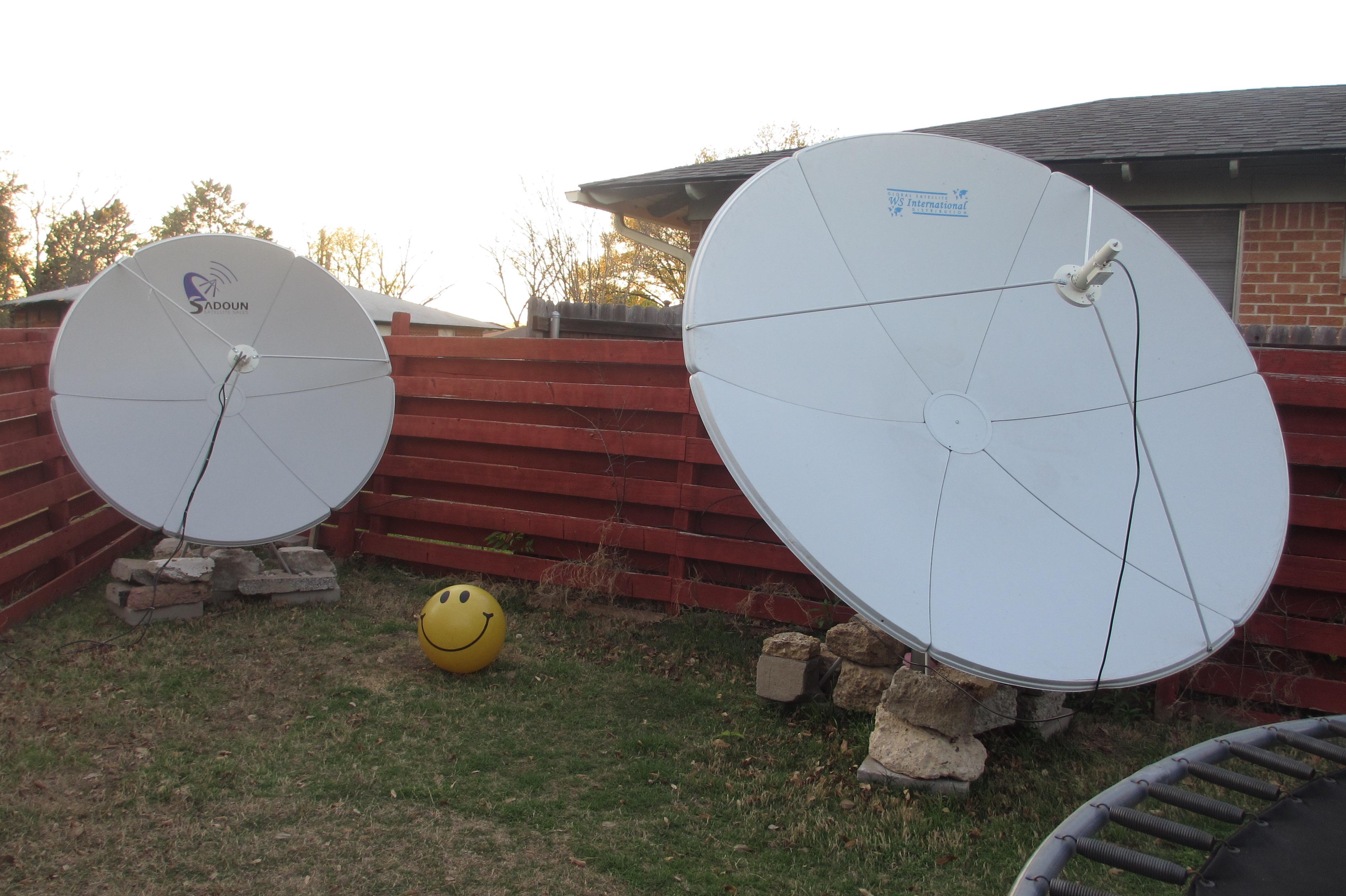

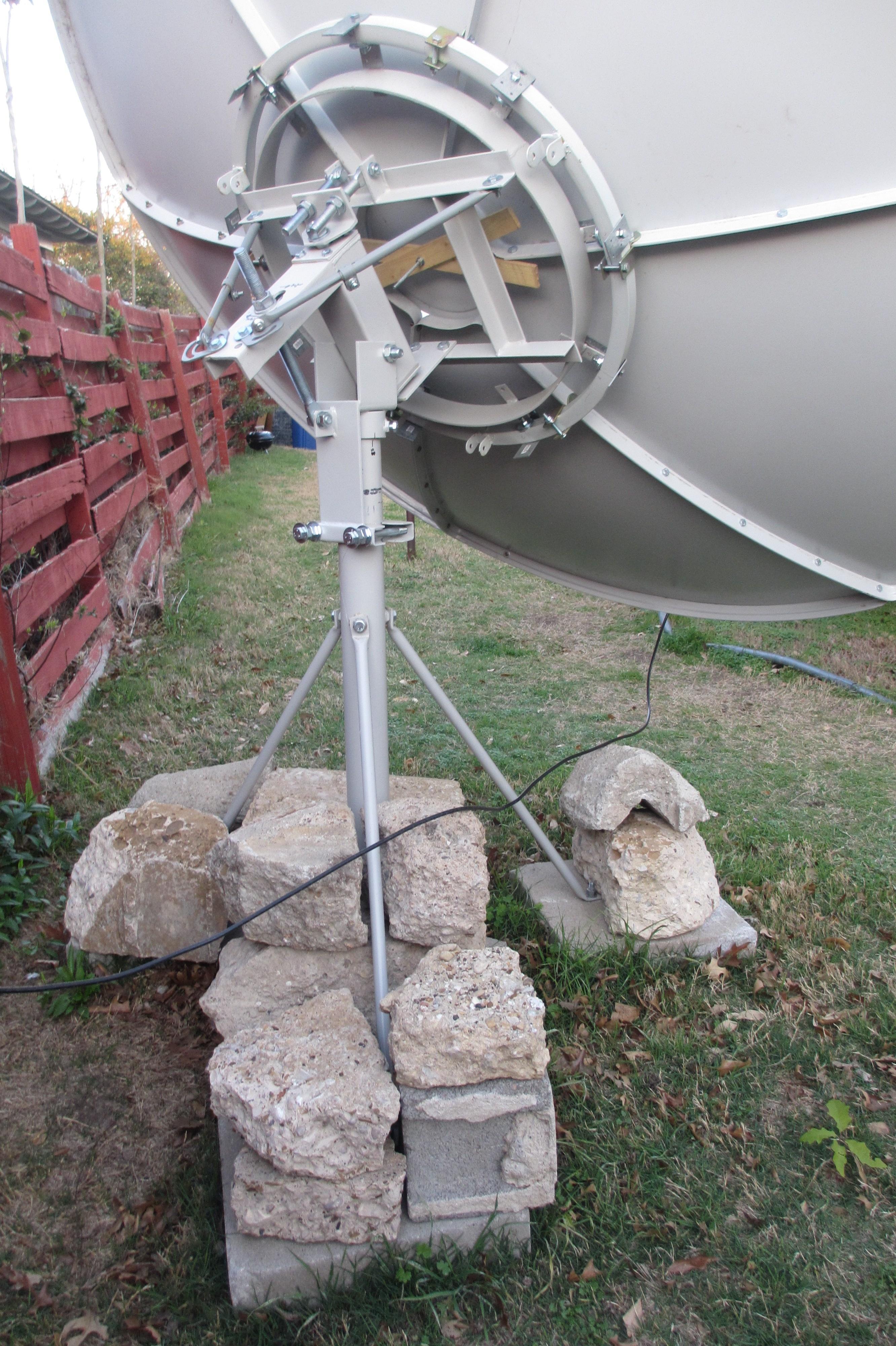

So this is my set up:
I have used 8 cement pads (homedepot $4.98 dls each) to Install the two Sadoun Pole 39" with the arms through the anchor bolts to install my Sadoun 1.8 mts and my Hybrid sadoun polar mount + WS international 2.40 mts. So far I have not any issues. Also I have put some " collection" of free rocks over the pads just to assure the weight.
Right now You can look these antennas aiming to Intelsat 21 at 58.0 W (WSi dish) and Nss 806 at 40.5 W (sadoun dish) . In front of the Dishes is the Home Roof about 14' of height.. And between The LNB and the wall Home are about 18' of distance aprox..
I am surprised with my results because I am receiving almost everything of each satellite even if you see that these satellites are on the atlantic position and even that Nss 806 is circular polarization with the "Plate" inserted into the LNBF that reduce the signal.
So is important to me that my Installation is not permanent because If in the future I am planning to move I can easy move all stuff including with my "Rocks".:).lol 03-25-13 181-b.JPG03-25-13 182-c.JPG03-25-13 185-d.JPG03-25-13 186-e.JPG03-25-13 175-a.JPG

This Installation is on North of texas. The 8' (58.0 w) Since I put around 5 months ago the signal looks strength and firm. The 6' yes,(40.5 W) I have readjust at least once every 2 months because sometimes I lost some digits of signal quality on weak Tp's but I think that Others Factors can affect like dish size, Circular signal (plate inserted reducing signal, and circular signals are more affected by the sun beam's ), plus The Low elevation and the Roof on the front but The strong Tps are solid. Anyway I am receiving almost 90 free channels on this satellite on Openbox HD S9, is not Bad!!!
The concrete pads are these:
Model : 30168555
http://www.homedepot.com/webapp/catalog/servlet/Search?storeId=10051&langId=-1&catalogId=10053&keyword=concrete+pads&Ns=None&Ntpr=1&Ntpc=1&selectedCatgry=Search+All
I dont know the weigh but are heavy. the 6' before I did not put any stones over the pads and no problems..
I have used a cheaper (black & decker) drill machine to do the holes. using anchor bolts 1/2 " into the pads of 6' . The free Anchor Bolts provided on the sadoun antena (long time ago) are little bit more thick (i dont know the size)but I can not find the same size on the Lowes or Home depot so these anchor bolts are now into the pads of the 8'. Also you can buy Anchor Bolts sealer or cement (provided in the same stores)to put into the holes to do more solid the installation..
