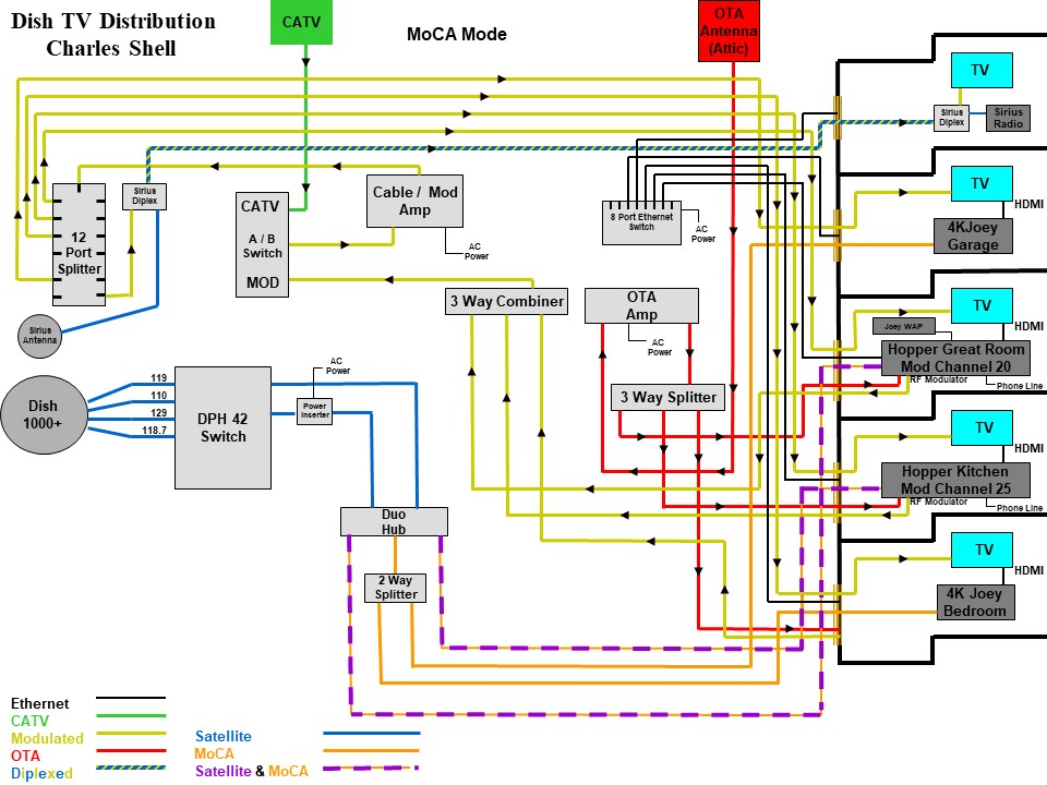

I have two Hopper 3s and four Joeys and use a RF modulator for my other six TV locations.
What are you running, a motel?
LOL. No motel however it feels like one sometimes. Four bedroom home and I do have TVs at some different locations so it all adds up. The different locations I have are the kitchen, garage, loft, backyard deck, dinning room that turned into my wife's Zoom room, and two in the basement,
jerryez, charlesrshell's Avatar is his home's TV coax distribution panel, if I recall correctly. There may be a better photo of it in this Forum. I bow in awe to this setup…
