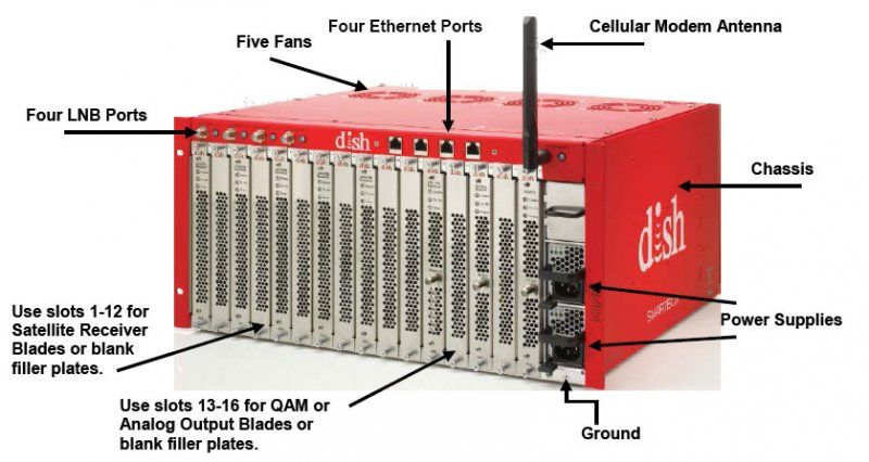

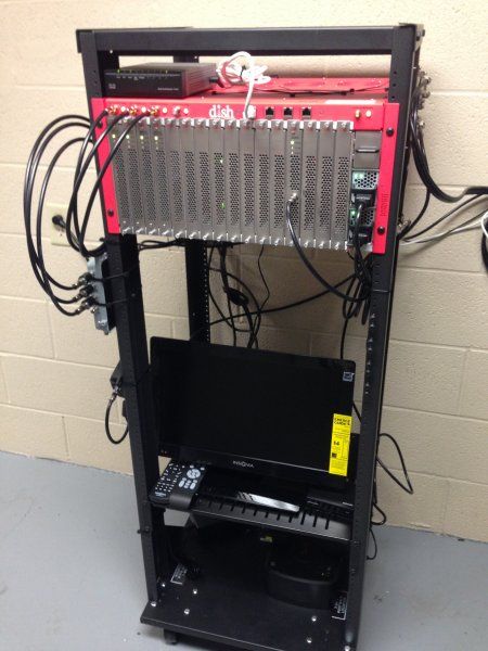

:) I got that, the question is what is the name of this "animal" what is the model number of the switch and is there a pictures of it somewhere ?
It's called a smart box. There is no switch, other than the 44 switch that connects to the box itself. I believe each of those blades runs 16 tv's in HD over Coax
Is it like Directv's D2Lite box? I had them put one in for my MDU and they didn't charge me anything. Of course, it's not for me, I use Dish, but there are several other tenants who have Directv and it de-cluttered the maintenance room for me.
