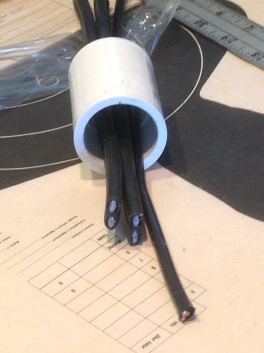

Planning my next dish project and will be putting in a dish about a hundred feet out from the house. My previous dish installs were all next to the house and very close, so no conduit was needed or used.
the attached picture is 2 siamese RG6 and a single Sprinkler cable for a total of 5 cables inside a 1" PVC coupling as a sample. Does it Look like I have plenty of room?
the 1" PVC is $7 for a 20 ft long section at LOWES.

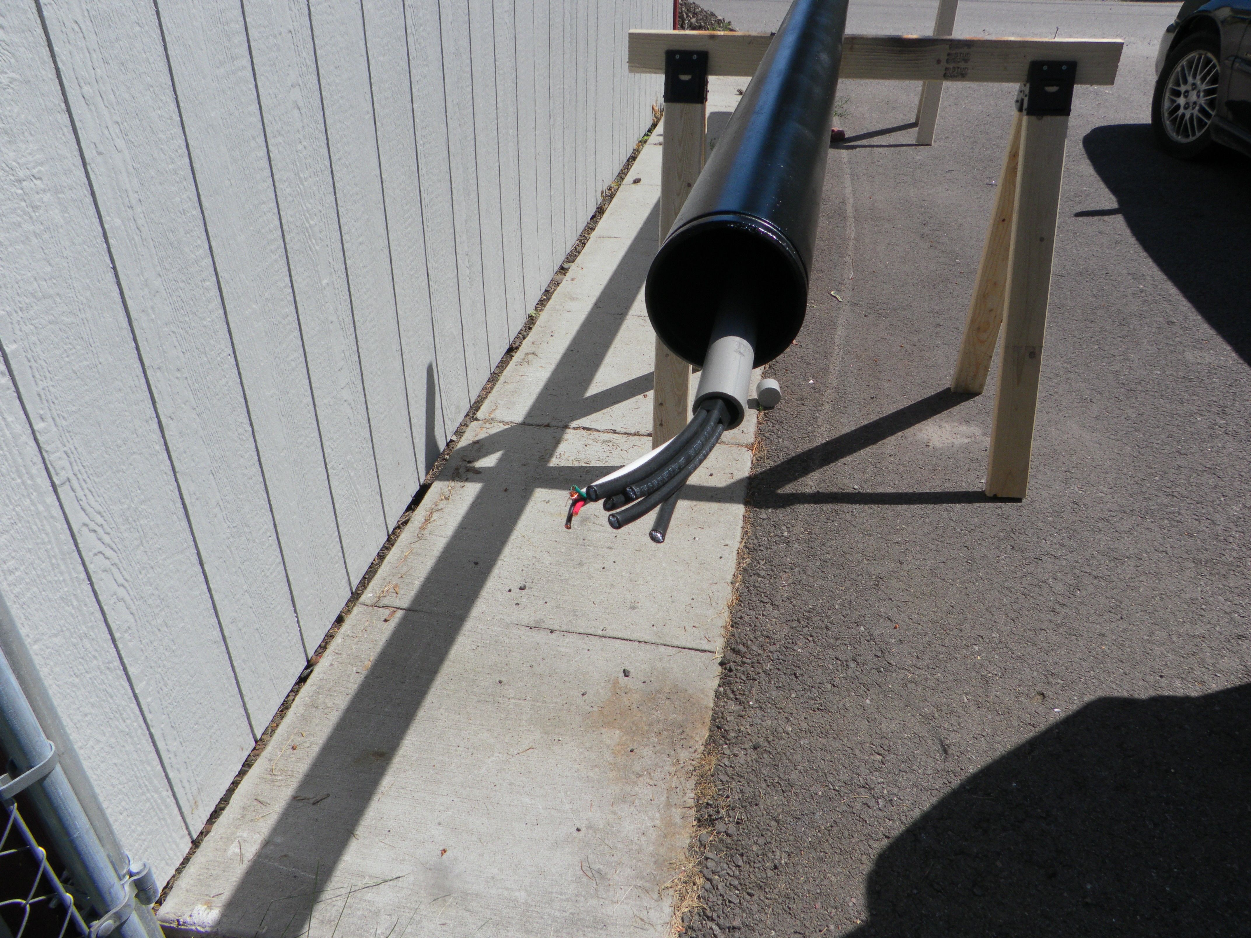

I used Rigid 1-1/2" Sch40 conduit with 5 RG6 and a control cable. It is very tight in there. It looks like your example is a coupler which is larger than the pipe ID.

Now that I remember , I did squeeze 5RG6 cables into a 3/4" PVC for a short run, but it was an effort to get it all in there.
Yes, you are correct. I did use a coupler. But the 1"x20' sections have their own built in coupler at one end, so it should be close. I figured i would shove 4 RG6 through it even though I only need 2 RG6 and a 5 strand sprinkler cable. Think it will be too tight?

If you assemble it before you bury it, no problem. But if you bury the pipe and then want to pull the cable through, it could be a little tight. The pipe with the built in couplers only want to pull one direction.
Good point about one direction. I'll probably run it through as I put it together. Thanks.
