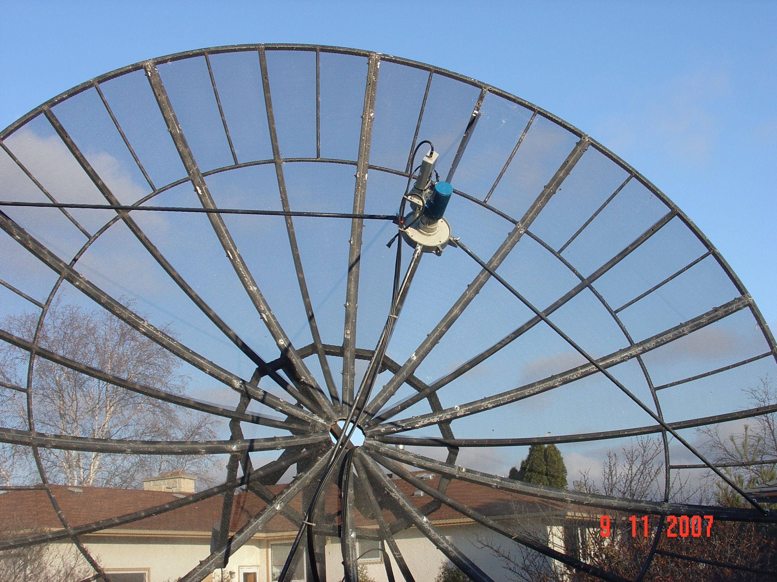

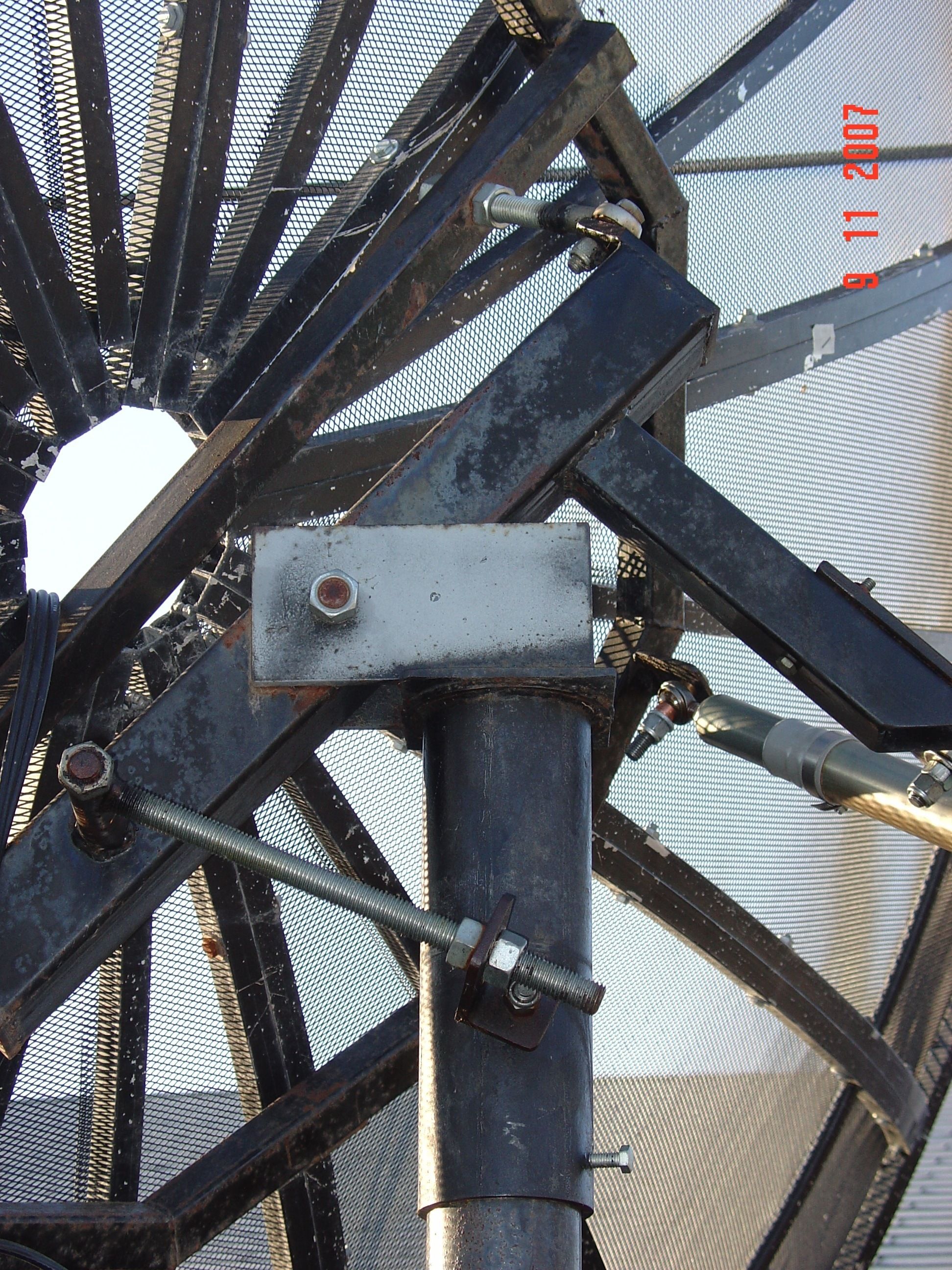

I've been trying to find my South Satellite 97.0W with my Mesh Dish and a temporary old Tee-Comm 5000 LNB - see attached picture. Since my Uniden 9900 P Power Supply is not working to supply 36 VDC to the Dish I ordered a V-Box III to be able to control the Dish with my Viewsat Receiver. I am at Latitude = 49.92, Longitude = -97.05, my Dish Elevation should be at 32.8 Azimuth = 179.6. Looks like there are 2 - Adjustment Bolts on the back of the Dish, see the attached picture. Should I be checking for 32.8 degrees Elevation with a carpenter's level in the back of the Ring close to where those Bolts are?? And how are the adjustments done re which one do you check and adjust first?? Any replies would be appreciated.

If the dish came from close by I wouldn't mess with the declination unless you have tweaked until you turned blue, and still couldn't get the dish to track properly. You have to find a flat place on back of the dish, that bolt that is at the top there that goes thru the dish and attaches to the mount is the declination adjustment, best I can tell. There's a chart someplace that tells the declination for your latitude, google 'satellite declination' see if you can find it, not bookmarked on my new puter yet. It's a figure that, aligns the dish with the satellite arc relative to your latitude. Further away from the equator you are, the higher the number will be.
since your middle plate is gone, I would say, put a flat piece of steel or good level 2x behind the dish and measure from that , with an angle finder..just hold it flat against the center part of the dish.. (easier to do than to tell how lol)

In your first picture, the screw adjustment at the top of the polar mount, just across to the left of number 11 from your date, looks like the declination adjustment screw?
The main bar on the polar mount is where you set your protractor to 50.6 degrees, then set the dish to 6.6 degrees more than that, which would make it come to about 57.2 degrees. That will make the dish point to about 32.8 degrees above the ground. Good Luck!
The smaller bar (just above the main polar mount bar, in your first picture) that the declination adjustment screw attaches to, is where you should get the 57.2 degrees with your protractor.

Thanks for the replies Turbosat and Voomvoom, drove the dish over to the vicinity of 97.0W with my 12VDC Battery Charger. The only way I can see a signal of 74% and some Q on Tp 12052 is if I switch my Antenna settings to: LNB Type = Universal, that is the only way I can get LNB High and LNB Low to show up on Antenna settings. That old LNB in the 2nd picture is the old original 10 - 15 year old Tee-Comm 5000 LNB that came with the Dish. Could it be Universal? I am awaiting delivery of a Corotor II next week.
