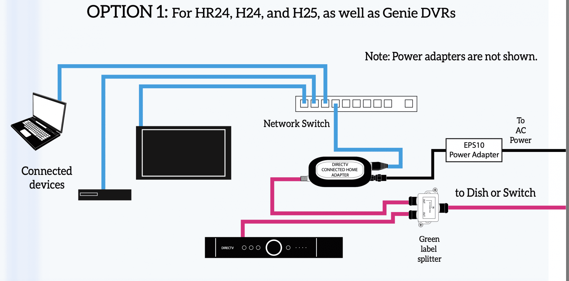

Well this may actually be easy because my basement isn't finished and the main coax line from the dish runs right above the router...lol So do I understand this correctly....Split the main coax line near the router, add the 2x1 SWM splitter like this one, DirecTV 2 Way SWM Green Splitter MSPLIT2R0-01 SWiM 2Way MRV Wholehome DVR New - Newegg.com, connect the main line to the red inputs and then connect a new coax from the other port on the splitter to the DECA?
Does this diagram show the connection method you describe?
Oh, sorry about the delay in responding ....
Got called away on other business for the rest of the day. ....
Yes that's exactly correct ....
Didn't know the satellite cable passed right over the router like that, so you're in luck then. ....

Perfect. Wheres the quickest place I can get my hands on that 2 way splitter? Any local places that I might somehow be able to grab one, line an ATT store. Prob not but just wondering. ThAnks.
UPDATE
Never mind. I have to have DTV come out on another issue so I will just have them hook it up. Thx.

All good. DTV tech just left. He was a hoot...Old school dude who worked for the old days DirecTV for many years. Was a very cool guy. Told me how things used to be...LOL Installed DECA device so now I am hardwired. Ran some tests and they failed on my TV and could immediately tell that the dish on the roof was not initially setup right. (my words). He went up on roof, did his thing. I was out there chatting with him and he was cussing up the initial installer. He said something along the lines of, "I bet some young kid half assed this job to get to the next one...". I told him it was indeed a very young new tech who was always looking at his watch like he was late for dinner or something... Tech just shook his head...Comical...Anyways I think the cabling and the dish were jacked up somehow....We really didn't talk that much about the issues up there...We talked about muscle cars and the "old days"...Everything is working like a charm... Thanks again for the help.
