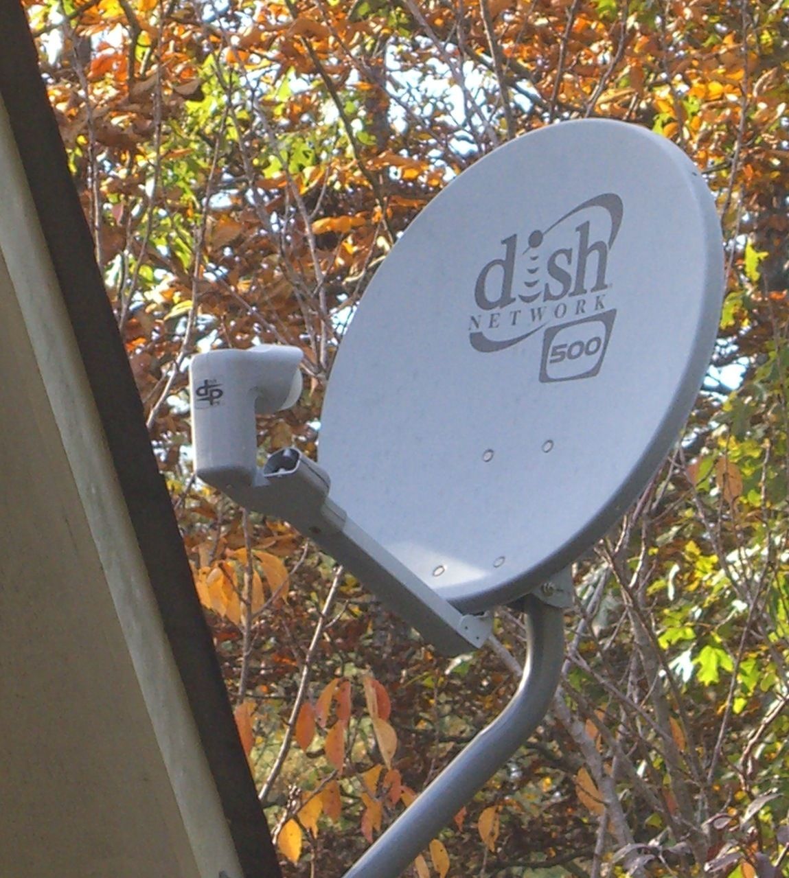

Attached is a picture. I dont know this is considered the pro dish equipment or not. But you can see the LNB and Dish is DishNetwork branded.
Would this work? If it does, do I just need this multiswitcher inside the house to split the lines into two?

You are lucky, your setup is the rare exception where you can actualy use a power passing satellite grade splitter to get the line to both tuners.
So all I have to do is use a special 1 into 2 splitters that are meant for satellites?
BTW I actually got on a ladder and got up near the sucker and this model LNB is: BS1B1UP001M. I remember when I put it on there was two coax connections on it (even though its a single LNB) and I only ran just one wire to it. So am I to assume this LNB is usable with a special satellite splitter?

I ask because I seem to be getting conflicting information on this LNB. The splitter (i think you are referring to) is the Dish 123254 but its saying has to be used with a DPP Dual LNB. I definitely dont have that.
Some say I need this newer model Single LNBF where its just a single coax connection.

You can use that LNB with your setup as mentioned above. Either use the splitter or just run another cable from the LNB to the 625 receiver. Since you only have one single satellite location, running another cable to the 625 receiver will work.
Got it, so I guess I can just get a hold of one of these splitter/separator Dish part 123254 like this one (DISH Network Dish Pro Plus DPP Separator (ES148534) - DISH Network - 123254 - - DISHPro Plus DPP44 DP44DPP 44 seperator seperater separater DPP DP sep DPP-44 Dish pro plus dish pro adaptor dish pro adapter) and call it a day?
Just wanted to make sure cause all the talk about these splitter/separators keep mention you must be using a DPP Twin LNB, but searching this forum it seems to mention that if you are running a single LNB just to look at one Satellite you can actually use these special splitters to run two feeds to the dual tuner receiver via a single cable.
Cause running another cable is not happening without somem major rework and more drilling, which I prefer not to since we already got 5 coaxials coming from outside in (blame DTV for taking up 4 of the 5).

Just to repeat or clarify what others are saying, do NOT use the Dish separator. That requires a DishPro Plus LNB/switch which you do not have. What you do have is DishPro dual LNB, which is actually all you need. On DishPro LNBs, both polarizations are present (bandstacked) on the one cable. Since you only want one bird, then all you need to do is split that coax with a power-passing splitter such as the link Drdeceased gave above. Using the separator instead would result in even transponders going to one tuner and odd going to the other.
