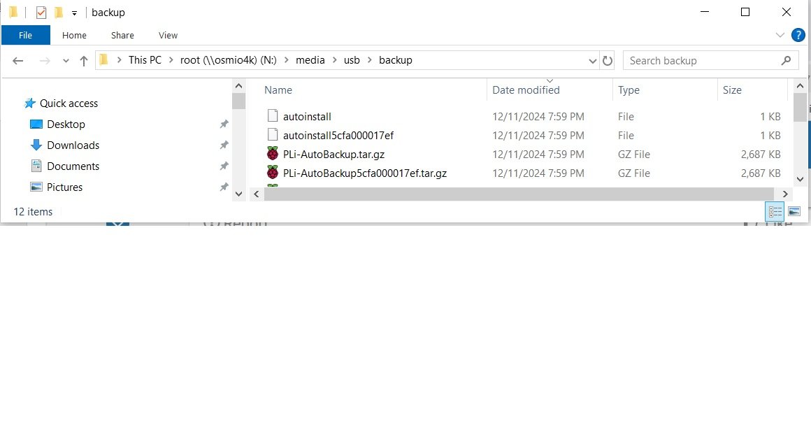

Ok, I found and did that earlier, and it creates some files named like this:
Does that backup your user channel bouquets also?
