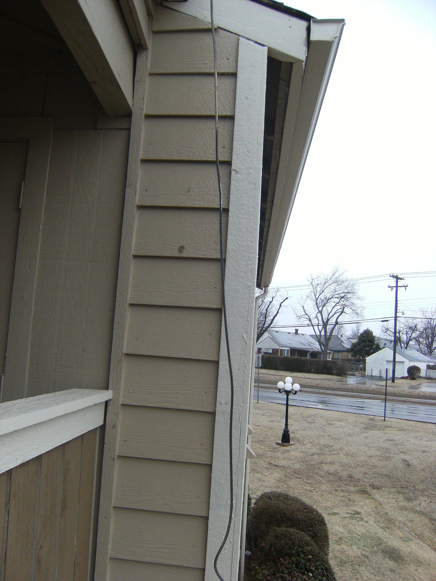

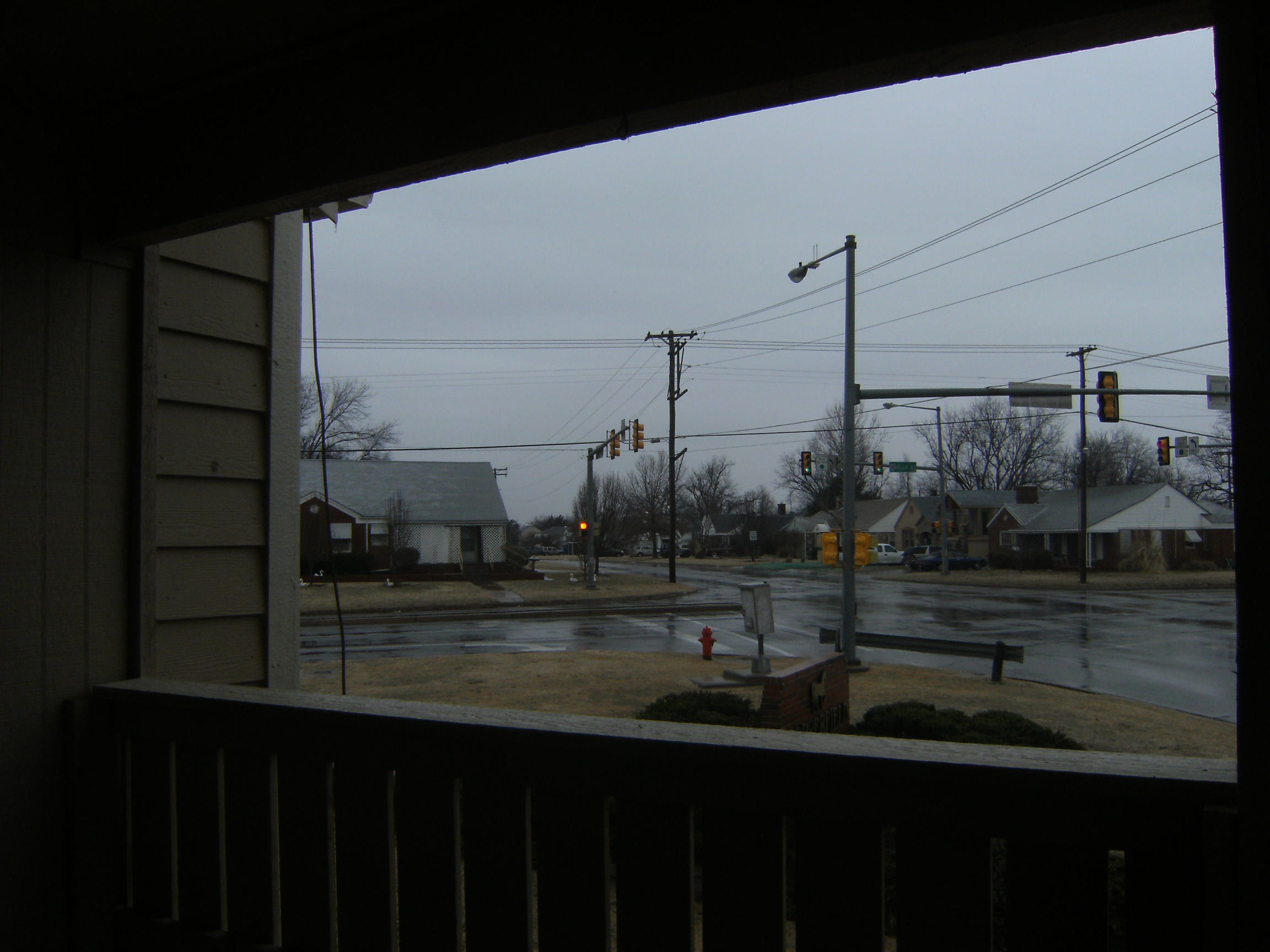

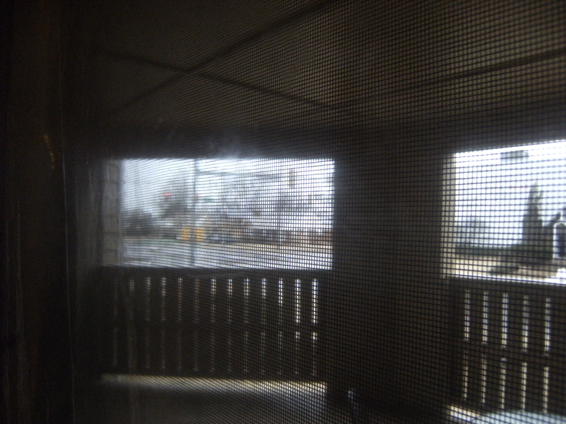

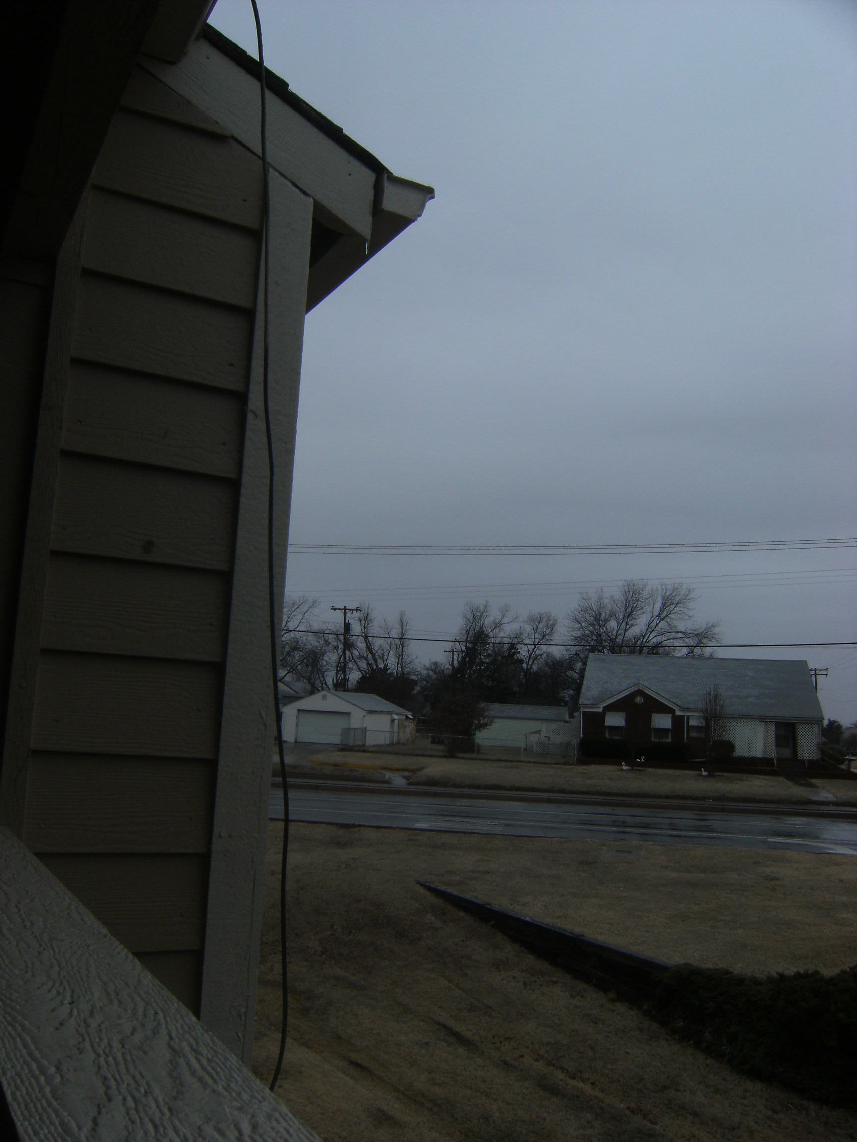

Take a wide angle picture where the dish needs to be mounted. I just might have a few suggestions as I have mine installed on my upstairs balcony.
Allright, I couldn't do wideangle with my phone, so here are a few shots.
Basically I just have to get it to stick out past the wall that the balcony is around.

the building owner might give you a hard time over it having to stick out so far.
PLUMB is most imporant. exponentially so for one sticking out.....
Well I wouldn't mind giving it a try, so long as it is flush with that wall it has to get around. So like, if it were strapped to the balcony and hanging out that 1.5ft to get around, I don't think that would be so problematic...
Thoughts on how to accomplish that?
I should note that on the images provided, the DISH would be placed on the left side. Two images detail the small wall I have to get past. I can't have any penetration of the wood; that's the only stipulation.
