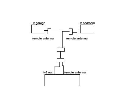

I used 4 splitters. Take a look at the attached pic. Then I bought a used remote on ebay.

Great! Ken, am I to understand that there is a remote antenna at each of your sets? Is there a box at the garage set? Sorry for the confusion.
There is no box in the garage. I had problems with the UHF remote working in the garage and the bedroom. Both locations are not that far away from the 625 but the UHF remote had problems. Now I have a UHF antenna next to the TVs and everything works great.
The TV2 signal and the UHF antenna are using the same cable. Then at the TV it is split again with a splitter.
Ken
Okay, I think I understand. There's no tv at the receiver any more, just at the downstream TVs. Your splitter behind the receiver is hooked up in reverse. I'll give it a try with out running extra cable first and see what happens.
There is still a TV at the receiver. I am using the TV1 out for that TV. The TV2 output in shared. I am running the 625 in dual mode.
Ken
Whoops. I obviously can't type and think at the same time. I meant to say there's no antenna at the receiver anymore and the splitter behind the receiver is hooked up in reverse.
