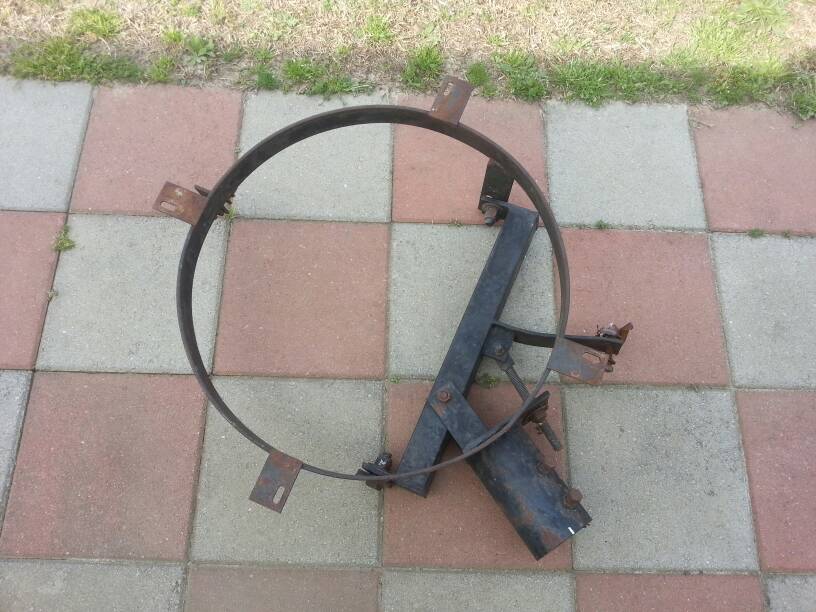

hmm, possibly... What size pipe is that for? What is the inside diameter of the slip? I don't know how strong that looks thou... That metal rectangle that connects the pipe mount to the pivot bar is what bent on the my dish. What size dish did it come off from, do you know?
