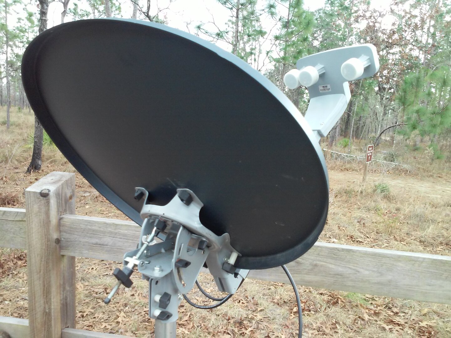

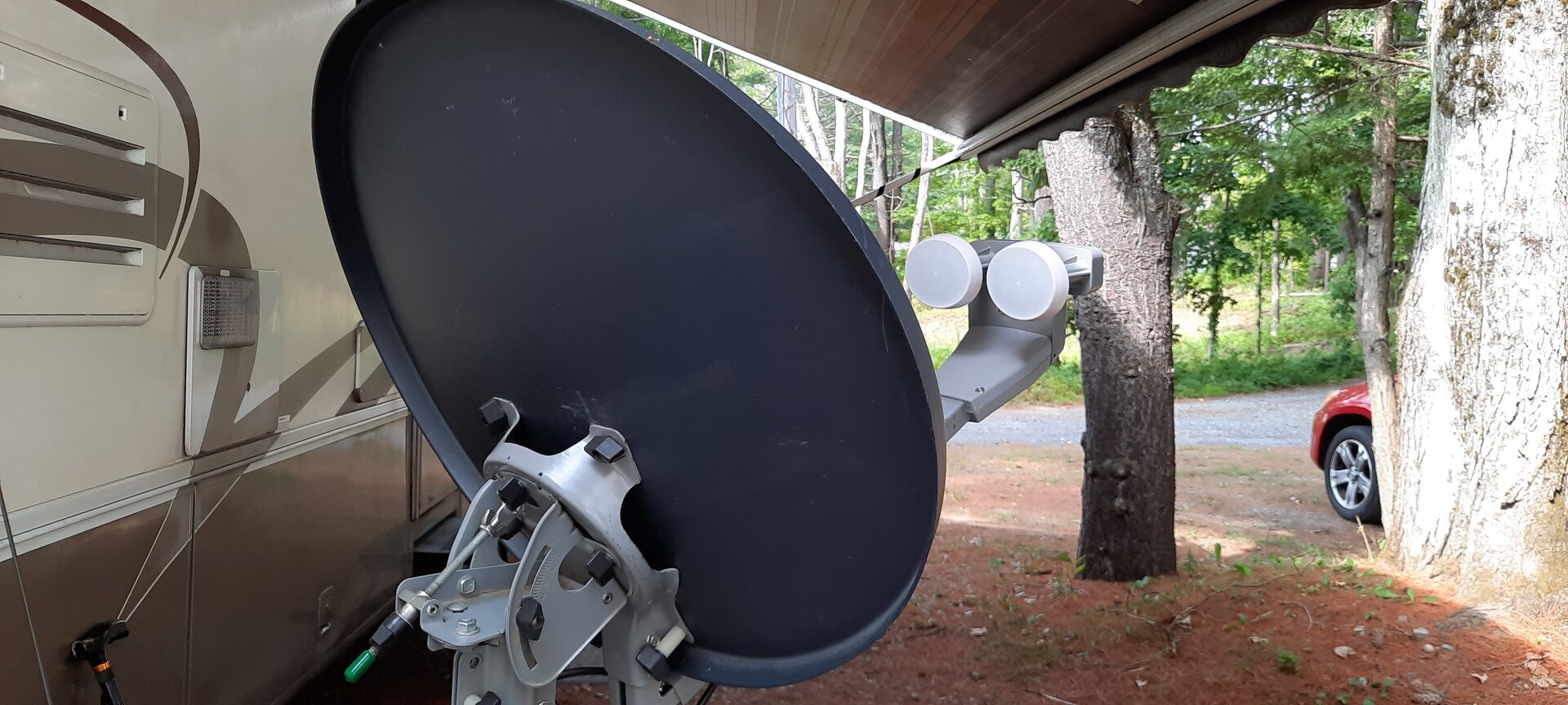

The pictures below show how I equipped one of my .4's for portable use. Note the large wing nuts that replaced the standard hex nuts for a no tools required setup. I'll do another set of pics that show how I modified a standard roof mount tripod for easy setup.

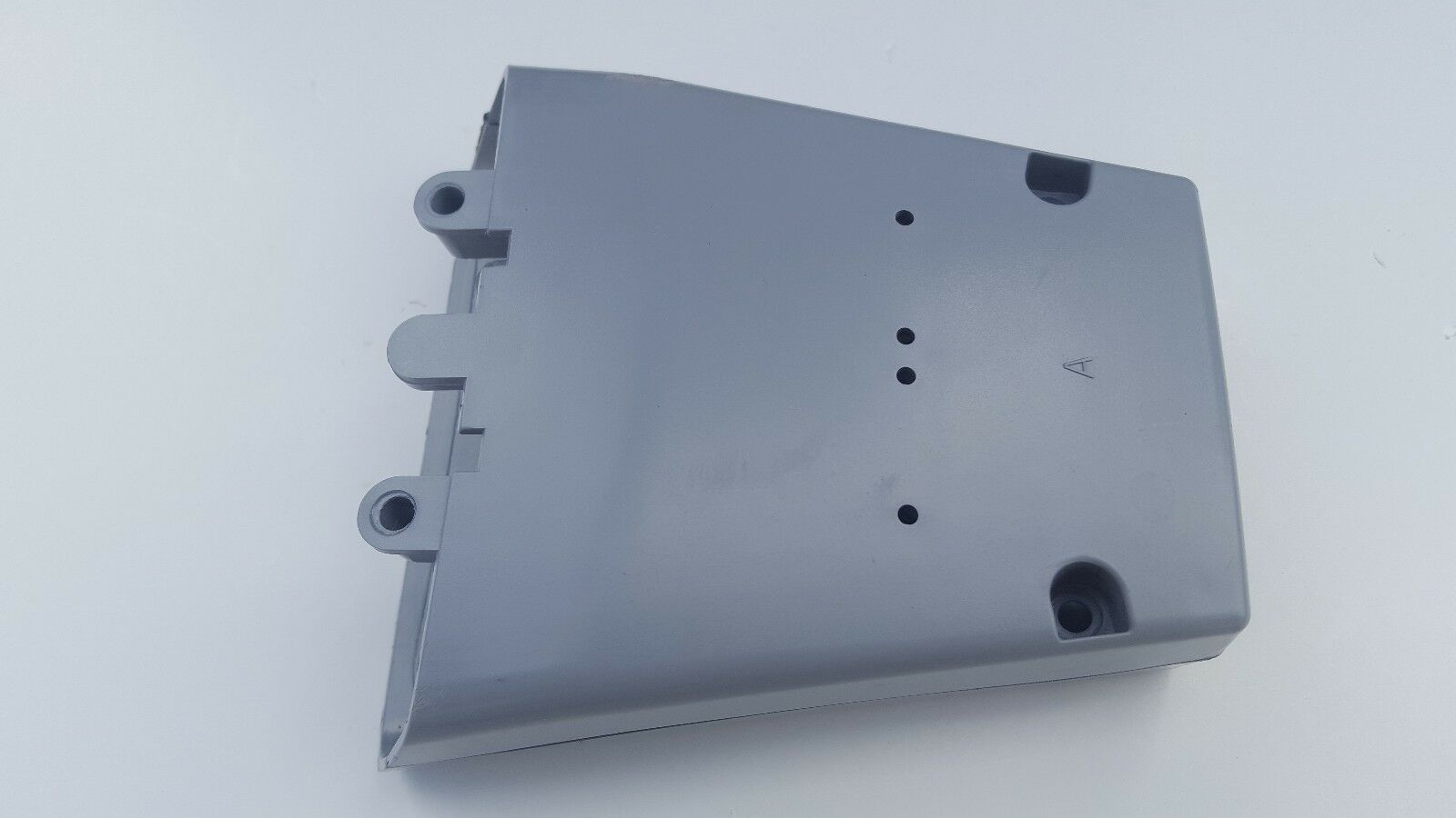

A .2 EA LNBF mounted on a .4. The adapter mod is below.
Unmodified adapter

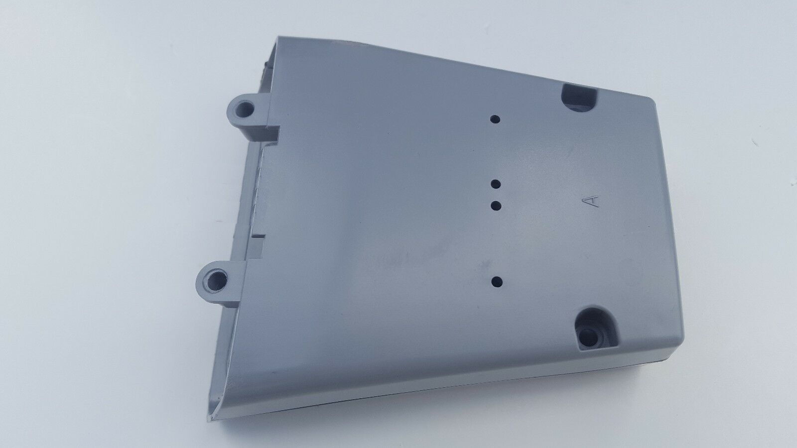

Modified adapter. Spot the difference?

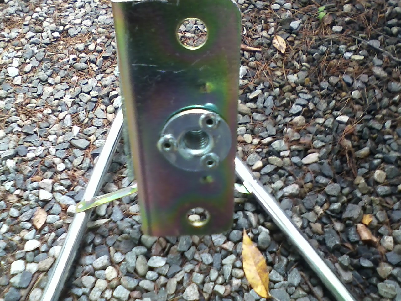

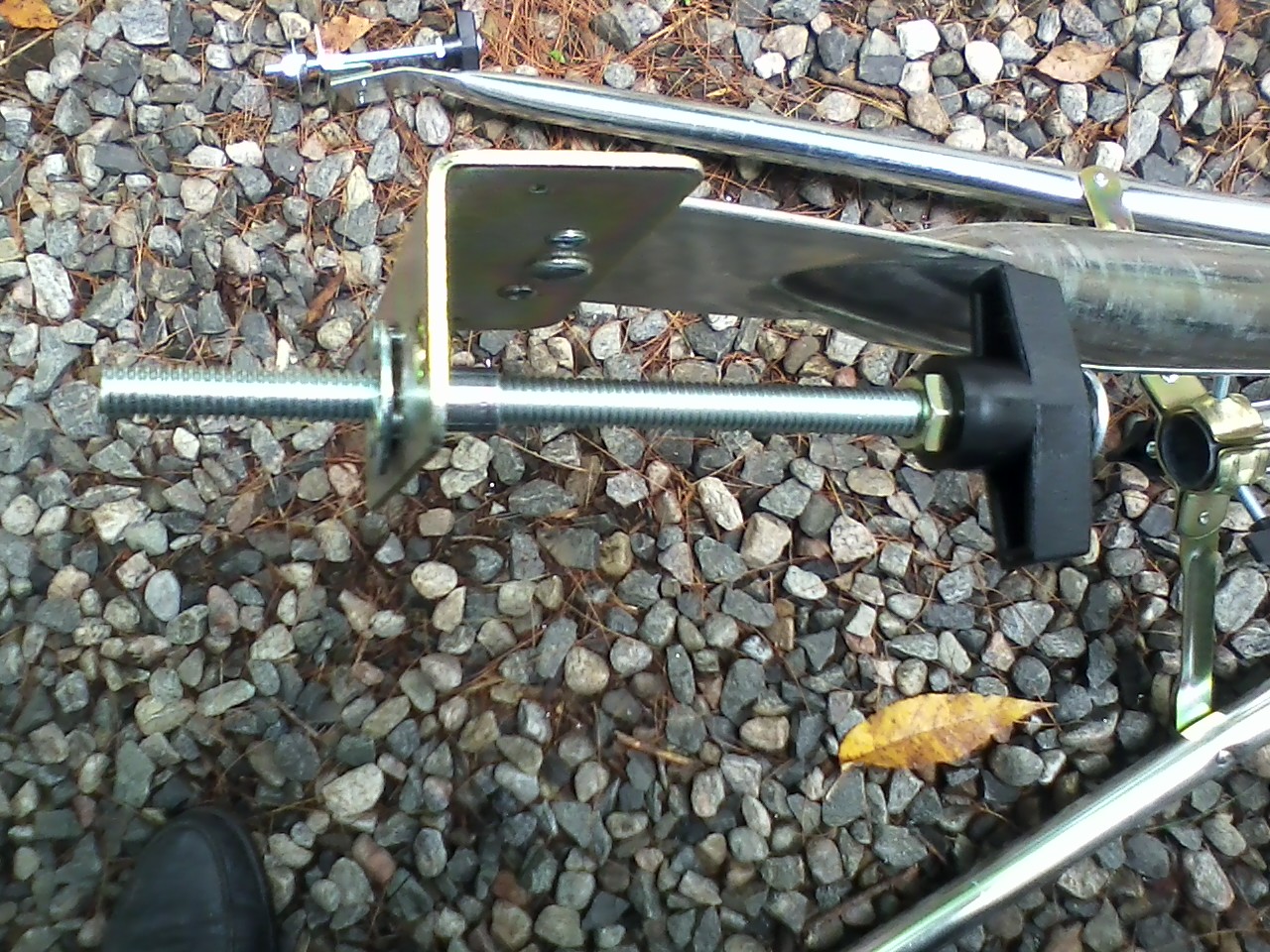

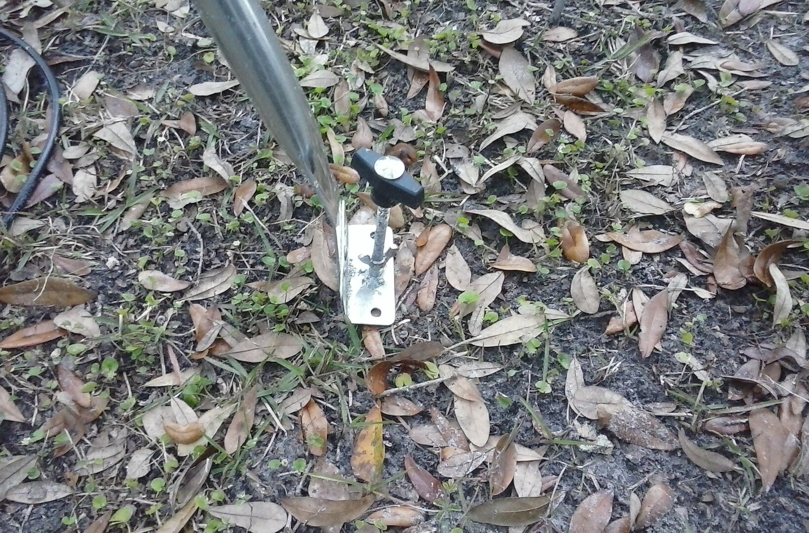

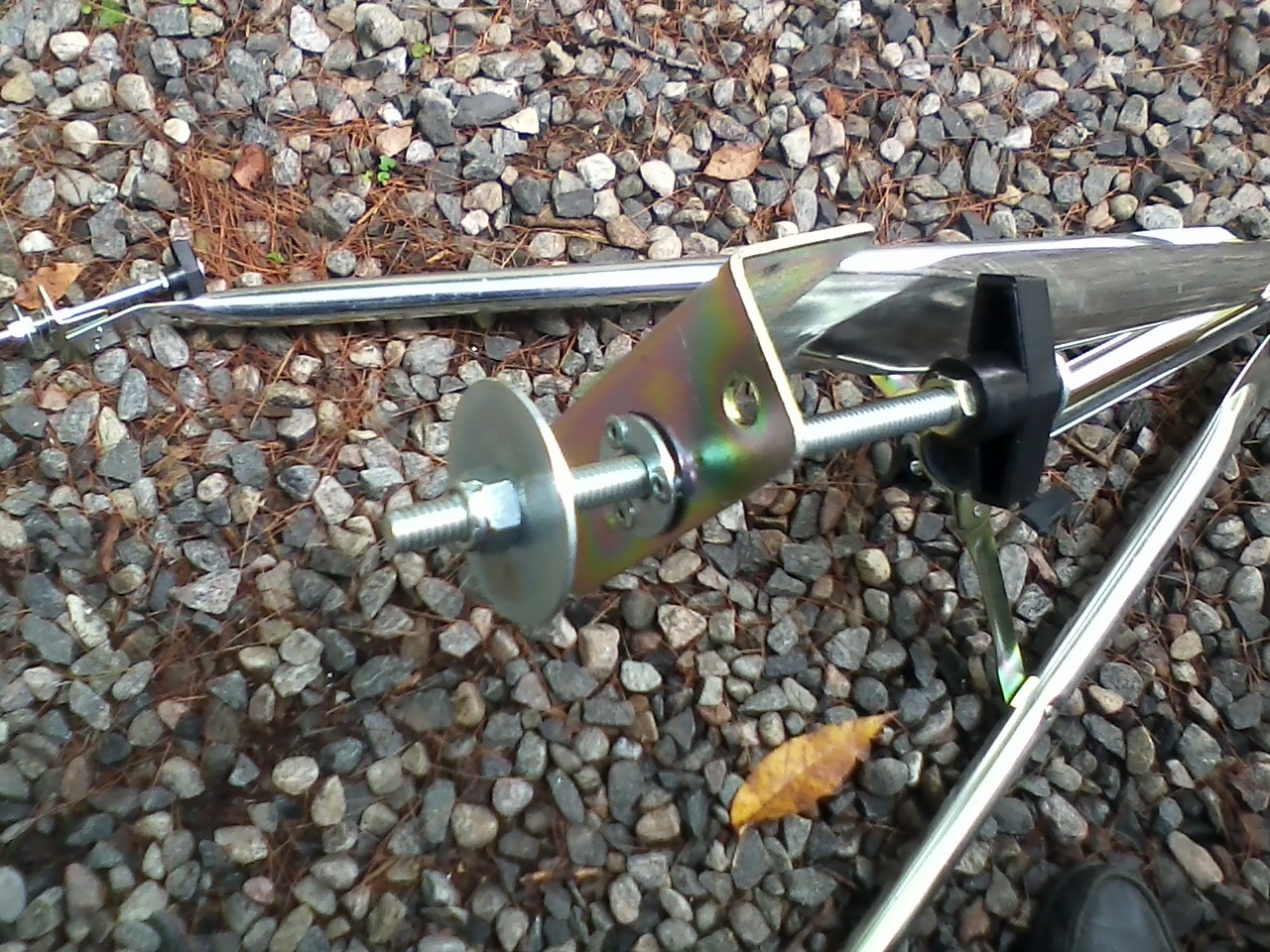

Here's the tripod mod pics:
Finished leveler with standard wing nut for locking.
Foot modified with a pop-riveted threaded leveling adapter used on furniture.

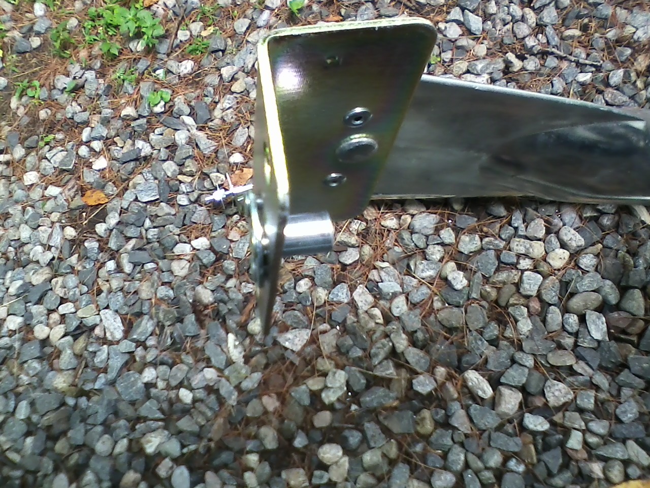

Side view of threaded leveling adapter.
8" carriage bolt with a large wing nut and lock nut.
Finished leveler. Washer and nuts are stainless steel.

Where'd you come up with all the various wingnuts? Would like to switch mine out to that on my Motorhome setup. Carry and EA and WA LNB so that can get reception damn near anywhere. Can usually be setup up and peaked within about 10-15 minutes but tool less would make that process even quicker!
Reactions: charlesrshell
I bought them at a local Ace Hardware store. They were in the loose hardware drawers.
