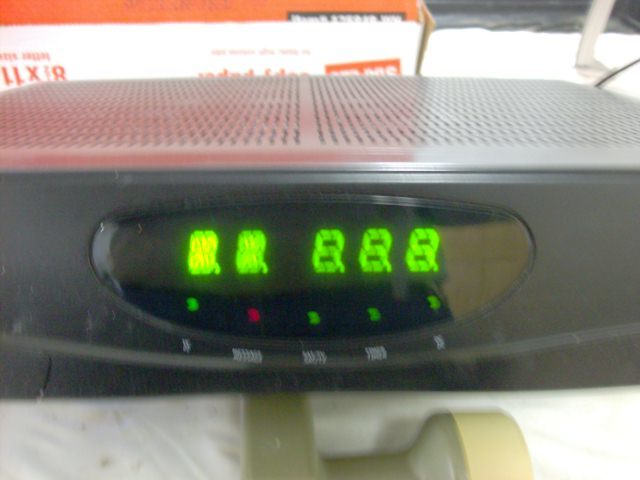

I did not get a remote with the receiver that was given to me.The 7th digit in the SN is a 1, so I guess it was manufactured in 2001. When I plug it in I get a display as seen in the attached picture.
Nothing happens when I press any button including the power button.
Did the battery die and now it is a brick?

Looks like it's stuck in self diagnostic mode. I should do that when first plugged in then show WM UP then go to the time. Do you have a LNB hooked up? Sometimes a short in the cable or connector will cause it to freeze like that.
No, I don't have it hooked up to anything. The PO had it packed up for several years before I got it yesterday. The receiver and a 10.5' c-band dish was given to me for removing the dish from the PO's property.
Should I leave it plugged in for a period of time?

If it didn't go into WM UP then to the clock something is wrong. You can try unplugging it and plug it in a couple of times and see if that makes any difference, If it stays in self diag test it's not passing something and therefore won't boot. If the battery is dead it should still boot.
Power up sequence is not working most likely. Condition is moribund if it continues to do this. Needs professional help. May end up as a hangar queen.

No joy.......... I tried unplugging and then plugging back in several times. Sometimes slowly sometimes fast. No change in the display. Any help on what to do next or should I set it out for the trash man?

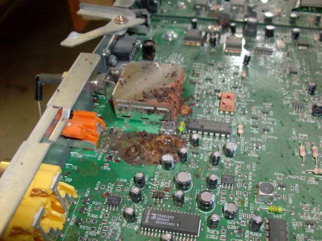

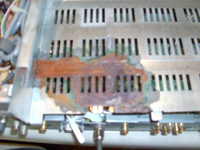

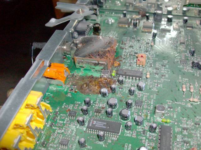

Figuring I had nothing to lose and the noise of something rattling around inside prompted me to open it up. Someone had left a battery (an old one?) inside the module case and it had leaked onto the cage and circuit board below. I can't get it out but it is a Maxwell battery.The pictures show the damage.
Thanks for all your help but I think I had better give up on this one. It was free anyway.
Btw, the battery measures 3.23v.
Does anyone need it for parts?

NICE! DC PCB got eaten up from the VC2 leaking battery acid. The unit is toast. Thats why I pulled my VC module out finally after 17 years, didn't want that to happen. We should all learn from this. If you still have a VC2 module in the 4DTV pull it out already.

Ah, that's where the battery came from. Not knowing about such things, it sure had me wondering how the battery got in there!
Oh well it was free and I was only hoping to use it to a move the dish and change polarity on a co-rotor anyway. The hunt goes on for something else to use.
