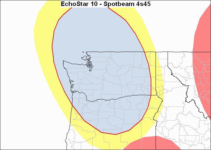

Seattle locals are on the 110 spotbeam 4 transponder 45...is your cabin located in the map?..I switched to Dish pay as you go account that way I can use the app and change locals to any in my spotbeam
I looked it up in my kmz files.
nice strong beam at your location. 50+ dbw
In fact, a standard antenna might do the job.
Unless they have dialed down the power.
