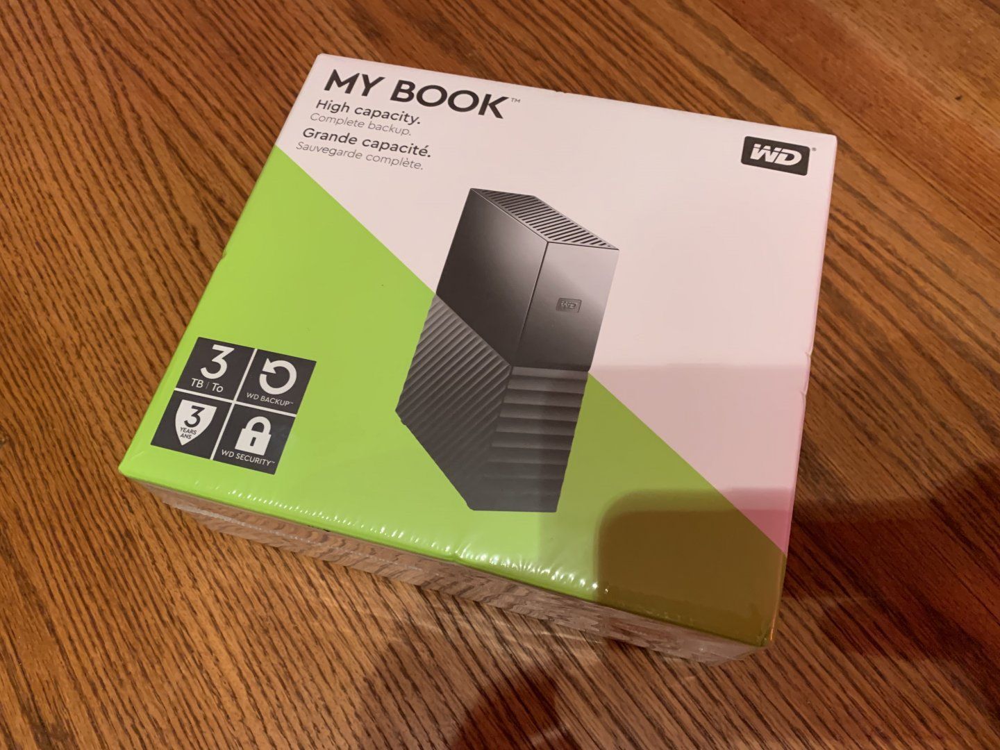

Picked up this powered WD 3 TB HDD from Best Buy today for $91. The Edision initialized it with no issues and shows a full 3 TB of storage space available :)

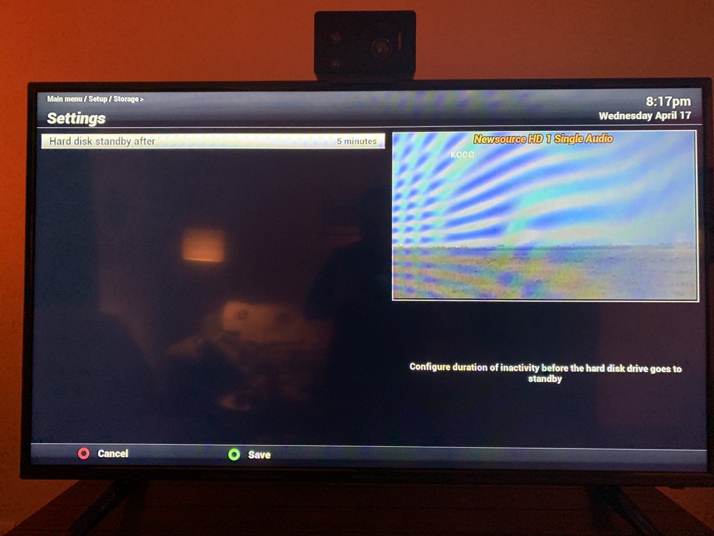

IF anybody wants to setup a 'Standby' mode for their external USB drive they are using on the Mio for recordings, here is how you do that on NA SDGr image: Menu - Setup - System - Expert Settings - Harddisk - Hard disk setup = "Standby after" Change that setting to what you want, and SAVE it.
Your drive will sleep, and wake up as needed for a recording.
It appears that OpenVIX (my preferred image) has a default standby time of 5 minutes, enabled by default:
