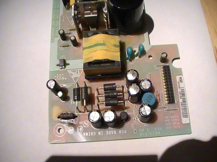

found it with no pretty blue lights on the front. pulled it out a bit checked all the wiring looked good. unplugged everything had it out in front of me on the floor and replugged the power in, then the unit put out a small puff of smoke (nasty+ smell) and that was that.

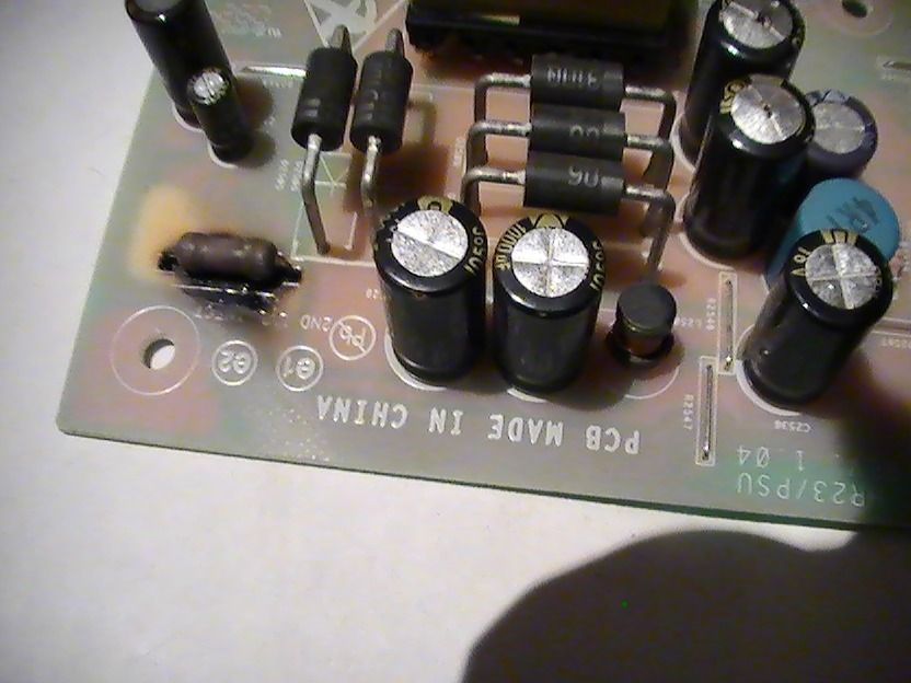

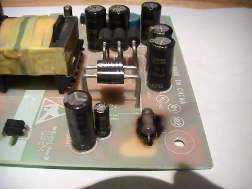

opened her up and found that burn on the power supply board. bought another unit for a new power supply, installed it and still no boot up. sad i was.
pulled the hard drive out, it was fried too. my guess it power surged and messed up everything... for me and my Saturday.
the end

You've got two bad capacitors on the pwr supply board in the pictures too, you can see the tops swelled on them.
What fried on the hard drive? If it was a surge, then the platters and heads are probably ok and maybe you could change the ckt board on the drive. I don't know if Direct uses any locking scheme on their drives so they'll only work on the one unit that the drive came out of, but if they don't, that would be an option. Course, you'd have to find a drive for a donor board. What brand and model drive is it?
good eye on that.

Sounds like there probably is a problem on the main board too. Maybe a pico fuse somewhere on there, if you're real lucky. Bad that Direct does tie the HD to the unit, swapping hard drive boards probably won't work then. Might, but chances are it won't. You could look on the drive's board and there may be a pico fuse on there too, some drives have them, usually it's something else that blows though.
