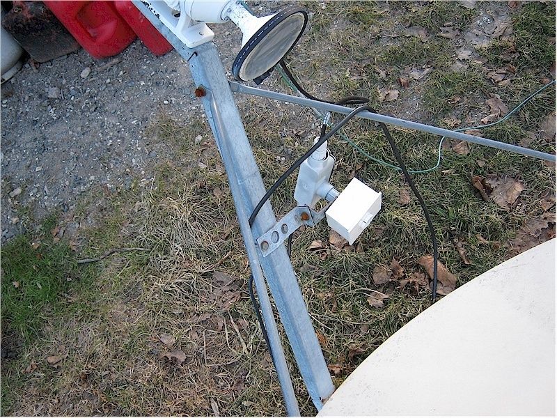

Hughes dish 1.jpgHughes dish 2.jpgHughes dish 4.jpgHughes dish 5.jpgHughes dish 3.jpg

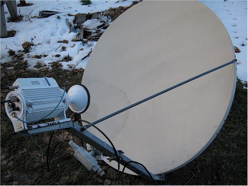

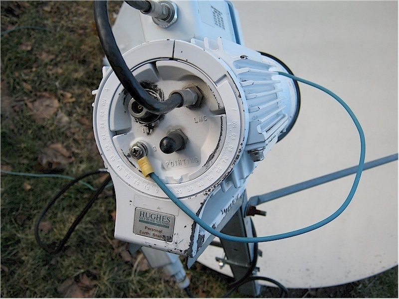

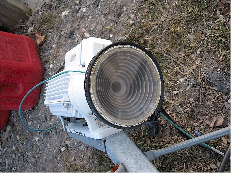

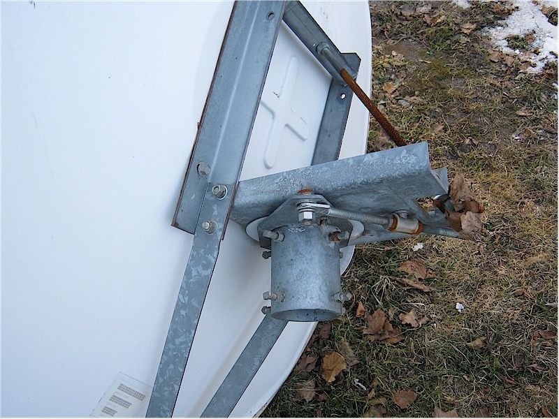

Here are a few pictures of the dish. Jim I am interested in what looks like a hand crank you have in one pic for moving it. Thanks for the help!
Bob,
Your lnb is piggy backed on top like mine. Connect your line directly to it and remove the jumper and other wires as you won't need them.
As for the hand crank, it came off my travel trailer and mounted directly in the 2" clamp originally for thee actuator arm.
Those are great dishes, I have two and they work great! A FSS lnb from a 121 superdish will bolt up in place of the stock lnb for both polarities.
Cad,
Any chance of a picture of your FSS retro-fit. I want to see how you mounted it after the tx amp is gone. My feed horn would be hanging in mid air.
Bob,

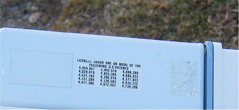

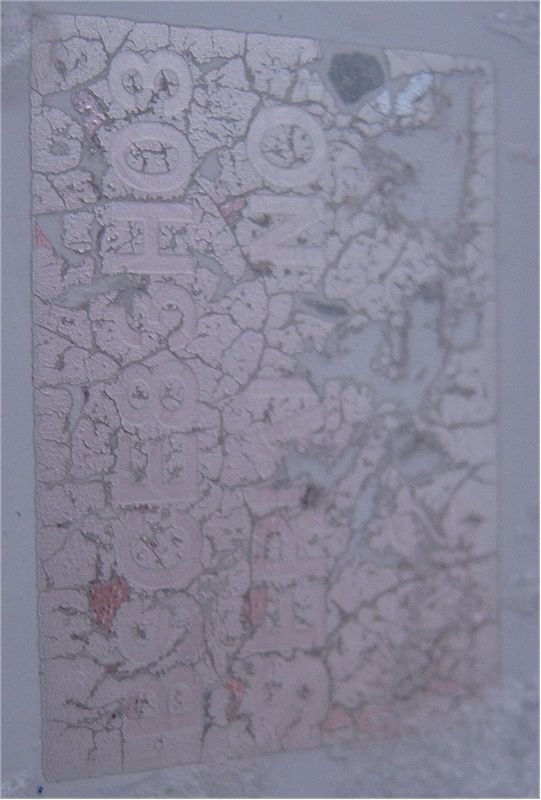

Here are two pictures of the numbers on the side of the LNB. The patent numbers are probably not valuable but there is a faded sticker that appears to have the model number BSCE83H03.

Also the skew is still set to 20 degrees from the last owner which from looking up on dishpointer.com I guess was for Hughes on 93w. I am trying to lock in 97w and dishpointer says it should be 23 degrees. How much of an issue is skew?

You definitely need to have the proper LNB polarity for whatever transponder you have selected. If you are trying for a horizontal tp and having no luck why don't you try a vertical tp and see if that gets you some Q. Just make sure that whatever tp you are trying for is active, you can find some examples of live tps in "The List" (tab is on top of each forum page).
Skew is important, but not as critical as your elevation or azimuth. That is, you could be off a degree or 3 on your skew setting and still get an acceptable signal, whereas if you were off that much on your az/el you would get nothing. That being said you still want to get ALL your settings as close as possible......is your skew turned in the correct direction (CW or CCW)?
