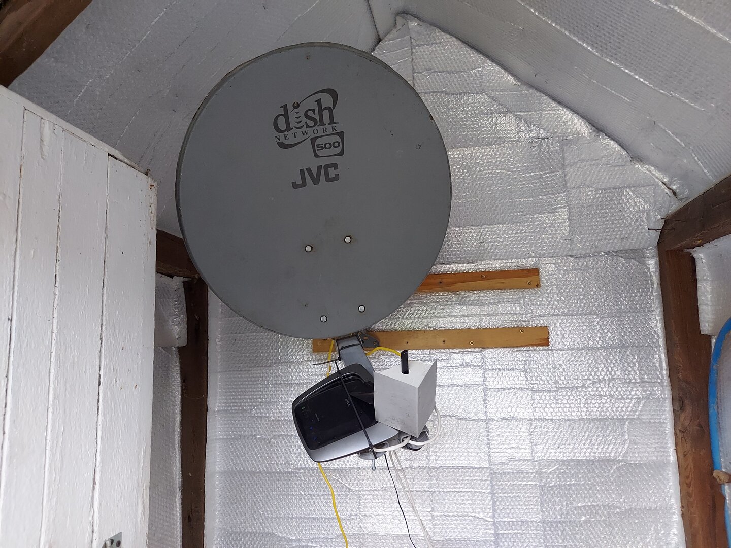

Anyway. Using an old disnet dish in my cellar way with an el cheapo netgear router in access point mode.
It is Cat5 cabed to my main router
It has external antennas and I have them right about where the LNBF was. It's aimed at my garage around ~500 feet away.

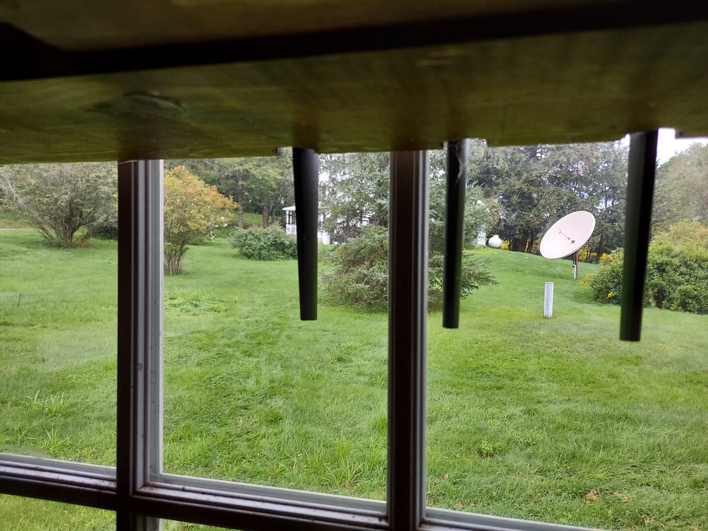

In the garage in a window there is another router. A Netgear with DD-WRT firmware and its in Client Bridge mode.
Signal is very strong and my 100mbps ISP service in the garage does a speedtest of 80-95mbps.

Using an old disnet dish in my cellar... with an el cheapo netgear router in access point mode... It has external antennas and I have them right about where the LNBF was.
PIcture? I am wondering which external antenna you use, and how you aim this dish at your garage. I am guessing its an offset-feed dish like all the Dish antennas I have had.

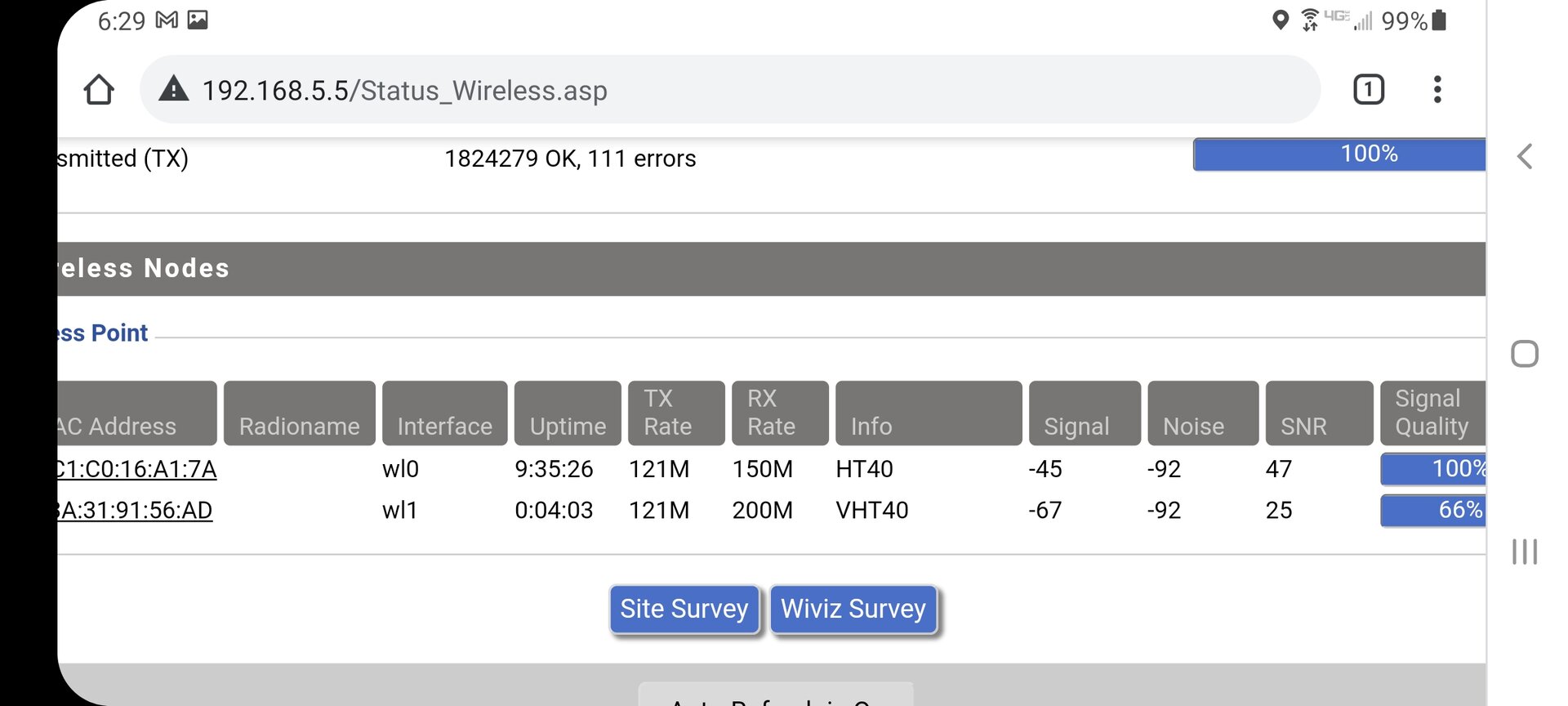

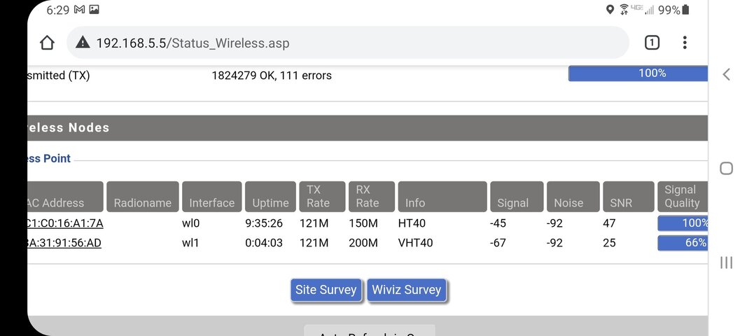

Don't laugh. It works great for what I need. The 500 feet was a little white lie. More like 400 stepped off. -45 dB is the signal of the link. The corner reflector at the dish isn't really needed but does help narrow the beam a bit.
With the cellar way door closed the signal drops to something like -52 dB. Attributed to the double layer of bubble insulation with a 5/8" air gap. Slick?
The Netgear router is a junk box one with an external antenna stuck on it. Not that much output power as it stands.
