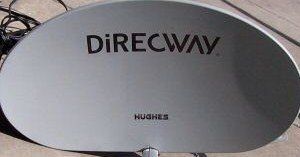

I have a couple of Hughesnet/Direcway .78M dishes. Anyone played with these for multi-lnb/multi-satellite reception. Any ideas would be welcomed.:)
Directway & DirecPC are pretty much one in the same
Their dishes are like Primestars (heavy as a bugger) but work really well. They are usually odd sizes too like 39x23
What is the height and width?
39 " by 24 "

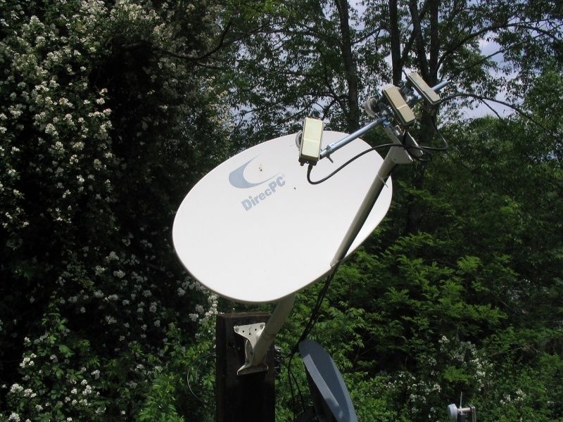

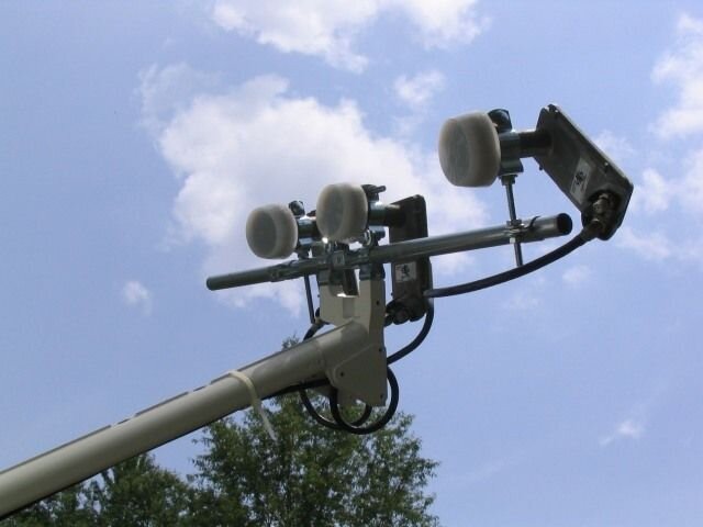

Adding Lnbs
The DirecPC/Direcway/Hughesnet .74 cm dish was designed to add LNBs for other sats.
Go to the link below and download the pdf for "Bird on a Wire - Universal Satellite Television Kit Info" and you will see the complete kit for adding LNBs. It is a simple device that could be built by any hobbyist that has a few tools and a Lowes or Home Depot nearby.

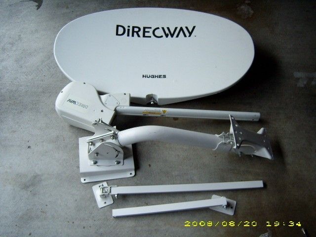

Here's picture of the white DirecWay dish 'n parts.
It was kindly supplied by one of our esteemed members.
By knowing the width, then measuring the picture, I get a focal length somewhere in the 700mm plus, range.
That would be quite suitable for 2° spacing on satellites 123° & 125°.
Now, as to whether the dish is big enough to get sufficient signal for both, that's an unknown.
See page 4 & 5 of this thread for LNB spacing info on various focal length dishes.
More reference material: WescoPC thread - http://www.satelliteguys.us/free-air-fta-discussion/151258-building-1-2-meter-dish-2-spacing.html
