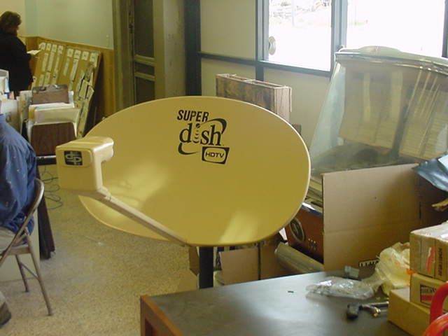

I did this with a hughesnet Dish about 15 years ago.
Not sure if it works
Took 2 cans of Krylon Fusion paint, a custom Logo and a Twin Dishpro LNB
You got to admit the logo I put on it looks awesome.
But here is a true story. Before Dish released the "super Dish" for 105 and 129, they had made these prototype dishes out of hughesnet dishes.
I copied the dish exactly like dish had done.
I posted a few pics of this online and I got a call from Dish corporate asking how I stole a superdish from team summit. View attachment 136621View attachment 136622View attachment 136623View attachment 136624
