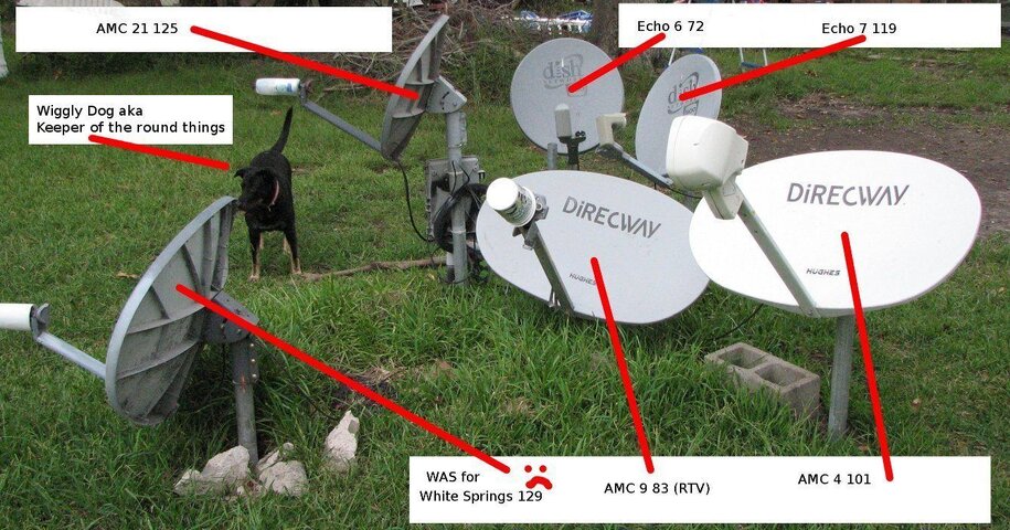

The Hughesnet/Direcway 23 x 39" elliptical works well for FTA in NorCal. The stock LNB is linear and the transmit portion can be removed to lighten the arm. I prefer this dish, its electronics and heavy duty mount over the flimsy imports and am always on the lookout for freebies.
Not all Hughes Net dishes are created equal.
Please see this recent discussion for more background.
Normally, I'd guarantee your dish & LNB would work fine, but it wasn't so for this member.
Read us any info off the LNB or the transmitter assembly.
And if possible, post us a few pictures.
You forgot to label the Dog !!!! :)
Oooopsy! My bad.. :o
Let's try it again..
Oh yes, and the 72 dish is coming down now and the White Springs 129 dish it now pointed at 97 Galaxy whatever..
Ooppsy!! Wow, I never saw one of those.
Perhaps I jumped to conclusions too fast.:eek:
