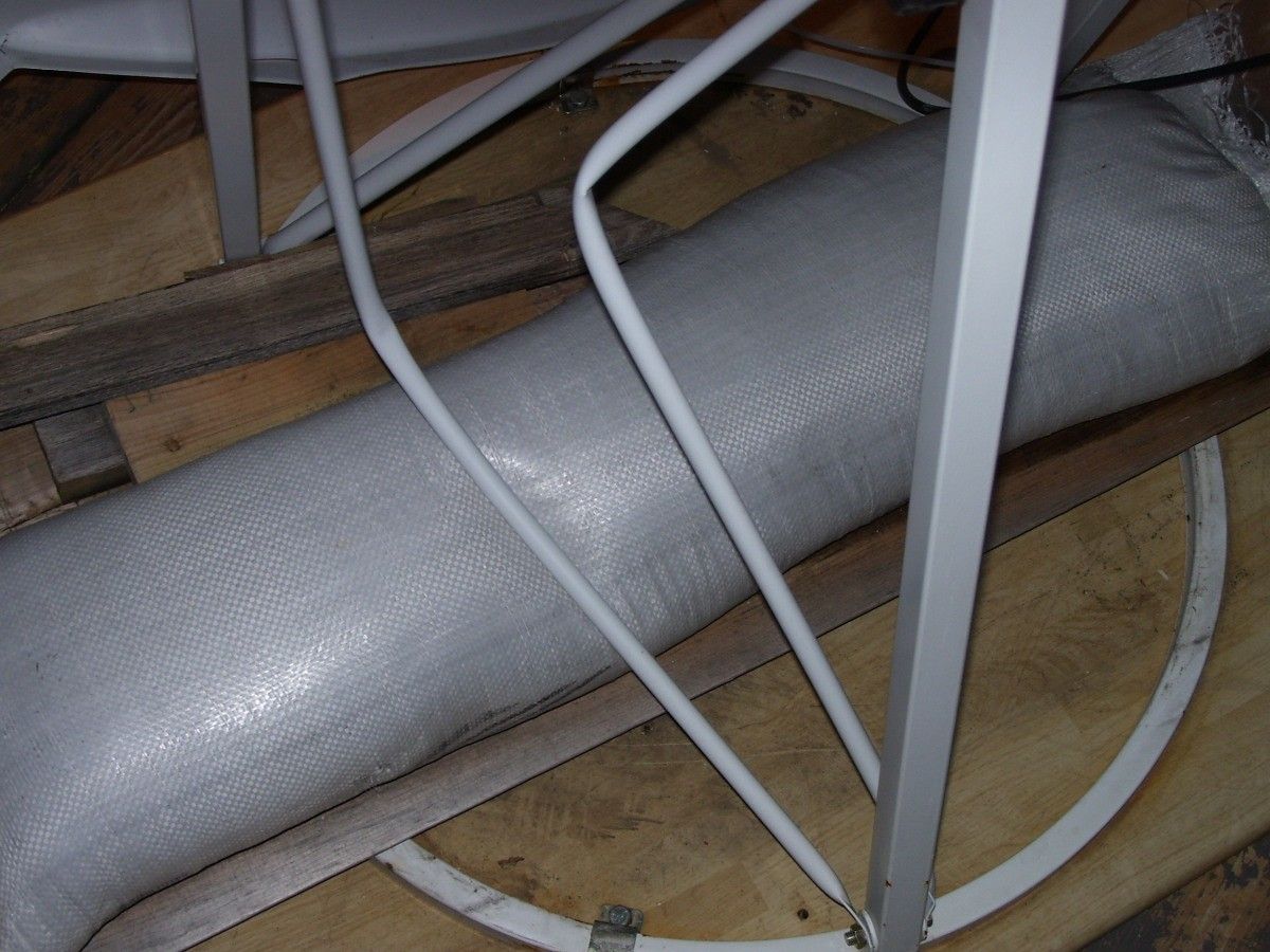

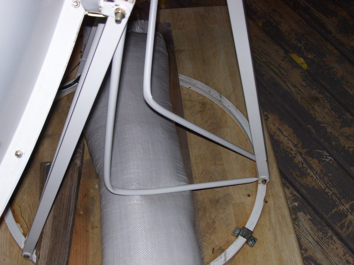

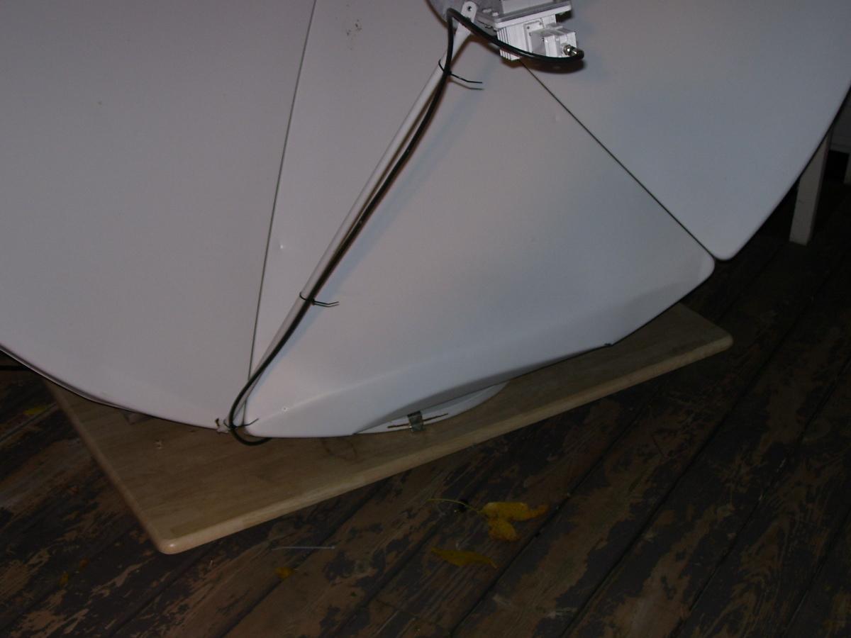

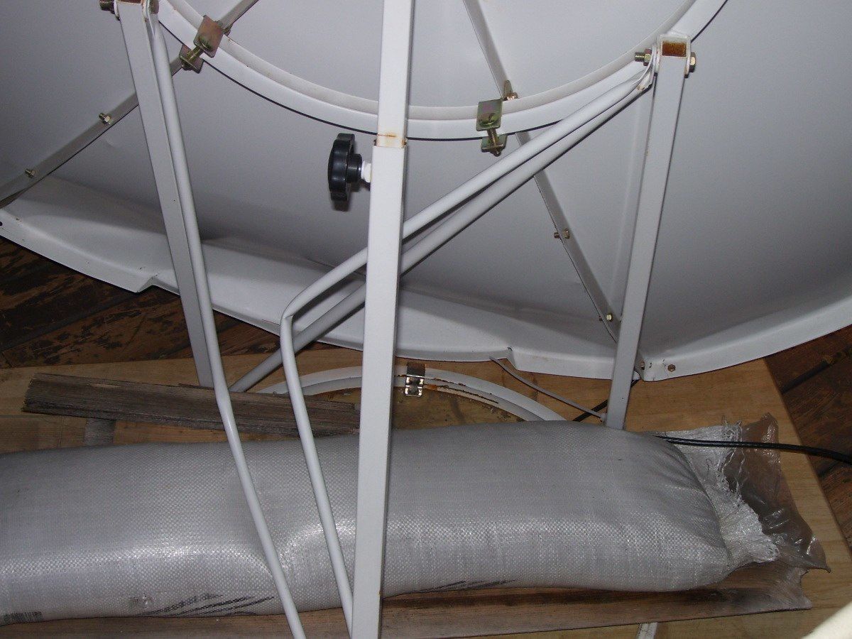

I have a 6 foot Fortec dish that I had bolted to a 30" high table to clear the roof. My TS is 38 degrees here in Minneapolis. It was fixed on G4....well tonight I tuned to G4 only to get nothing. All my other satellites work fine. Looked outside on the deck and DAMN
We had some strong winds here today and the dish (once again) biffed it off the table. Third time its fallen. Once it fell because it wasn't bolted down. Once the whole table tipped over with it. This time I was not so fortunate. There was 80 pounds of sand on it but I guess that didnt help

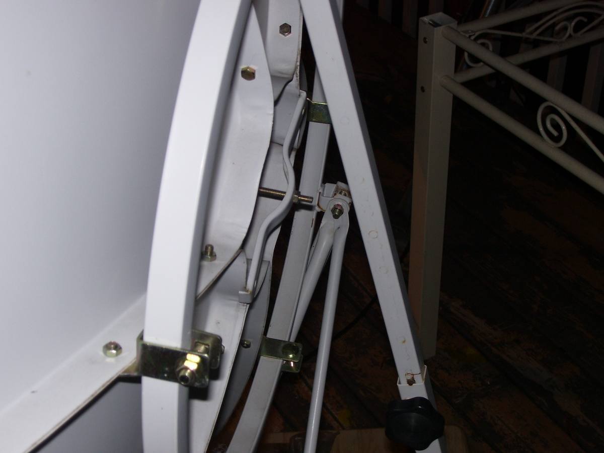

The table broke off from the frame and bent the hell out of the back pieces on the dish. Also dented the bottom of the dish but that's OK. Looks like its just a few pieces to replace
Now the big question is How do I fix this? Sadoun if you are reading this it looks like I only need those smaller brace bars. Do you have any extras laying around I could buy maybe?

Lowes, Home Depot, and some well stocked hardware/building supply stores carry various sizes of aluminum and steel square tubing. Measure or take a damaged piece with you and see if it can be matched in size and material.

Wish you were closer, metalwork is my stock in trade. :)
But yeah, go to a good hardware store if you can't get the parts from Sadoun. You MIGHT get away with just flatbar if you use steel, just drill a hole in the end. You can cut it with a hacksaw, a GOOD hacksaw...:D
Another idea that would work, go to the same store and get you some appropiate sized conduit, cut it to length and pound the ends flat on an anvil/bench vise. Drill the holes to bolt it up and there you go. That would probably be cheaper than Sadoun even.:)
Looking at it again, I'd try to use small square tubing from Home Depot/your hardware store. Say, 1" square. Drill the holes in the ends and bolt 'er up.

Another thing I was thinking was just using a couple pieces of wood to brace it up. It seems like those bent bars just keep the frame from tipping back as it did. I guess I needs some more sand bags on it :)

went ouot and grabbed the top part of the "O" ring (where the dish panels attach) and used my foot on the bottom and pushed it back up. Those 2 bent bars keep the dish up at a good level. Bent those bars back as best I could and reaimed. Its off by maybe 1/2 a degree now but got G4 back...not the best because the bottom of the dish is bent to hell but its working right now :)

The good news is that, since that dish is divided into sections, it should be easy (and cheap) to replace the one bent 'petal'...
.....dish is divided into sections, it should be easy (and cheap) to replace the one bent 'petal'...
For what it's worth:
I contacted Sadoun about a replacement panel and was told they don't exist. I offered to buy one that might have been damaged in shipping if new ones weren't offered. Again, "none to be had".

the bottom piece isn't that bad and has bent already once before. Its the back pieces that I need to figure out how to rig up
