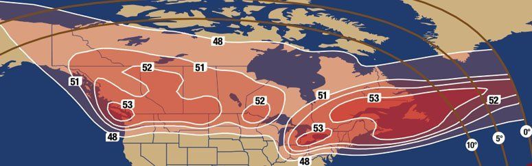

The new Star Choice bird?
?Didn't they pretty much confine that beam to Canada with little spillover into northern US?
That's pretty tight aiming for the Shaw part of that sat... It drops to nothing just at the top of the border into Kentucky.
http://www.kusat.com/Telesat/Footprints-Maps/Anik-G1/G1/
Snowbirds are crying in their pina coladas cuz they can't get the new HD stuff from Shaw Direct in Florida. I think the OP was trying to find a permanent signal for dish orientation. My suggestion is for him to start a thread just when he's ready to start swinging the dish and work with a buddy in real time to tell him where there is a live feed now...and now...and now. Those feeds come and go quickly but are frequent.
