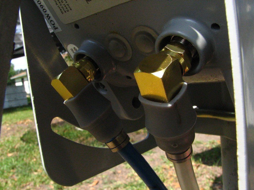

Another problem I had which is not related to the tuner, I made a dish out of mismatched parts. Well........... I ended up having to flip some parts over and then some parts were hitting each other and that made me have to adjust the motor up to a higher point than it is supposed to be. This messed with it in a whole bunch of ways and stopped it from seeing all the satellites.
One of the problems was that the wires stick out in a stupid way on the SG-9120 motor and they were in the way of hitting the brackets on the dish. That's why I flipped parts around upside down, to clear those wires. Well guess what I found in the Dollar Store this morning?? L shaped adapters! :D
So now I have the dish down and apart and I'm hoping that I'll be able to get it where it sees the whole arc of satellites. At least this is a problem that I was able to solve myself.
