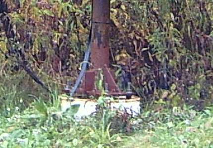

Here is a pic of my pole mount, it is two 55 gallon drums welded together and filled with concrete, buried 5 feet deep. There are four 3/4" bolts sticking up from the pole mount that the plate on the bottom of my pole bolts to. With a setup like this, if the mount ever moves i can adjust the pole back to plumb.
Nice - looks like how they mount street lights here.
Shawn
Thanks Shawn,
This type of mount/ pole system was recommended by a gent who does commercial c-band installs in the area. And before someone asks, yes there was a backhoe involved in digging the hole for this mount. Trying to dig a hole around here by hand is an exercise in futility, my property is on a glacially scoured mountainside, LOTS of rocks.
I was psyched when i went and grabbed my 6' BUD, it was set up the same way so i just unbolted the pole and took it with me :)
That is how a parking lot lite pole is leveled .
Wyr
