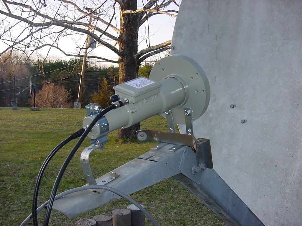

I have 2 BSC621s and never really had all the problems others had. Here's a pic from a few months ago of my 6' offset with one rigged up.

Once you get the hang of the 621 its pretty easy to use. Also it fits in the scaler ring pretty snug versus the others that have a 1/8" or more gap

Corrado -
Love the bracketry. You should have posted that picture a long time ago! :up

Iceberg -
what can I say... nobody likes a sloppy scaler. :rolleyes:
I'll be looking to shim some that I have, too.
The CK-1 feedhorn is actually tapered a little bit, with the front end being bigger.

Yes, the CK-1 fits like socks on a rooster, even using it's own scaler. I tried it first, and because it is so loose, I figured why not just put a Chaparral scaler in so if the CK-1 doesn't work out, I can slip a Co-Rotor right in place. :)
