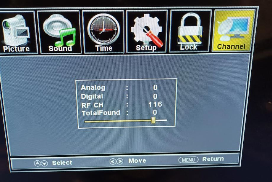

My friend bought a house about 15 miles north of us, and asked for help doing the same exact thing. We remove the satellite dish, and were going to use the mast for OTA TV after adding an antenna... We decided to try the antenna before installing it on the roof... pointed it to the right direction... and hooked it into the satellite coax wiring that ran into the house. Now, his house does not have open ceilings.... keep this in mind... We went in to scan using one of his TVs and began the process.... The scan seemed to proceed normally and yes, we jumped through the hoops.... antenna/air versus cable.... etc etc..... and the scan began. There were three kinds of signals.... Analog, Digital, and RF CH....... On my system the digital count ran up to over 50 as expected.... On his system, the Analog and Digital remained at ZERO.... but.... the RF CH ran up over 50 as well...... When the scan was complete, we got ZERO TV channels to work.... In other words it said there were over 50 channels but they would not work at all.....
That is problem one.... and it happened to me yesterday and it is a long story, but I had a small TV in a work room and hooked a decent OTA antenna to it... did a scan..... and it came up with over 100 channels and all of them were ALSO RF CH and not "digital"..... and I thought, here we go again... but... when the scan finished, CH 2 came on (PBS) over the air and all the channels worked....

Picture of the scan where it does not say digital but RF CH... this is the portable TV antenna.. decent one too.. not an elcheapo... and yet this one did work...

It may be that the 100+ RF channels seen are a "leaky" cable connection picking up QAM signals from an old cable TV line.

I just need to understand more about what RF CH means... compared to digital signals....
the stations in most cases broadcast on a different station. So as example WCCO (channel 4) broadcasts on RF32 (the RF channel) but it "maps to 4-1 (the old analog spot)
