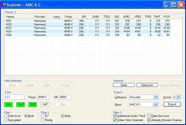

AMC 6 C ----3 SD NASA channels and 2 HD NASA channels (nothing but an info screen)
I'm only aware of one NASA HD channel on AMC-6. Certainly only one on the 4040 mux. Did you find another transponder with another HD channel, or are you somehow seeing the one HD channel as being 2 channels?
There ARE 3 other NASA transponders on AMC-6, but those are all SD. I haven't noticed another HD NASA channel, unless you picked up one of those HDNET feeds.
I checked again to be sure and I have 5, I have yet to see anything but the info screen on the last two (HQ4 & HQ5), just says occasional HD programming or something to that effect. I've included an image from the TransEdit app that scans for channels. The numbers probably mean more to you than me...still a newbie here.
Chris
Edit: My BAD... I think I'm gonna have to eat those words. I think HQ4 is nothing and DVBViewer just freezes the last channel tuned. So if I move from HQ5 to HQ4 the HD info screen for HQ5 is just froze on the screen for HQ4. I still get signal strength on HQ4, but evidently they're doing something different, or just a carrier.

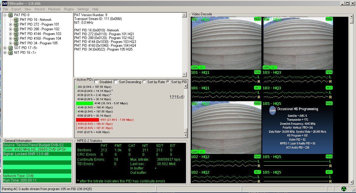

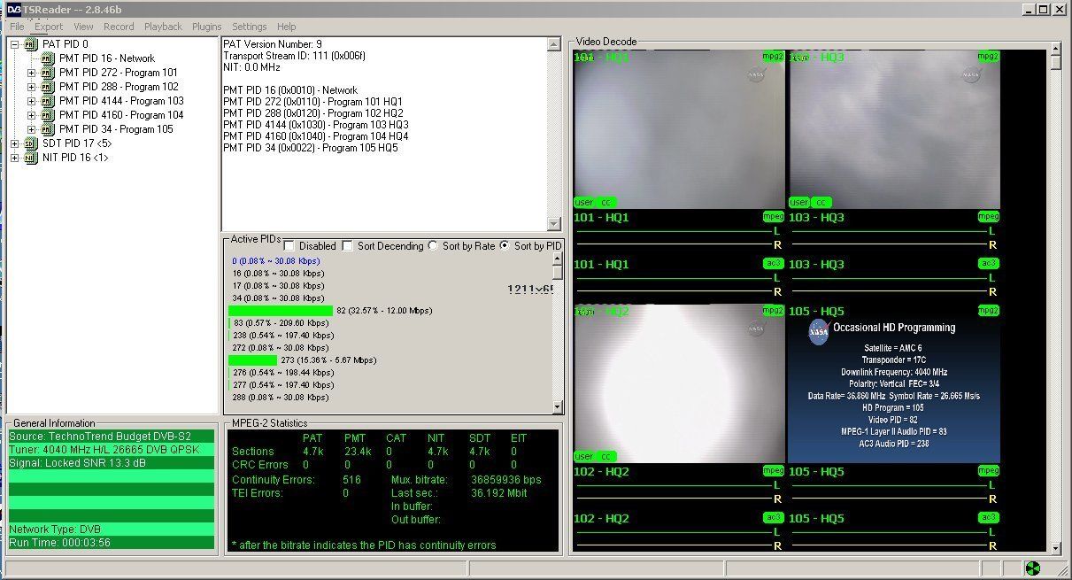

HQ4 is an encrypted SD channel. When they first started up the mux, they had it FTA for a while, but it's been encrypted pretty much every time I've looked ever since it encrypted. You're probably right, that it's just giving you a blank screen or something and retaining the HQ5 info, when you switch from HQ5 to HQ4. That's one reason I like to use TSREADER. It makes it much more obvious when you have an encrypted stream, and you can tell which streams have enough bitrate to be HD, etc, etc.
EDIT: Just added some TSREADER screen shots.
First one shows the 12 mbps HD stream in green, compared to the SD streams that are about 3 to 6 mbps.
The second , I've scrolled down in the chart section to see the HQ4 stream in red (encrypted). Interestingly, it's about 8 mbps, which is pretty high quality SD, but not really fast enough for decent HD. It used to be SD when it wasn't encrypted. It's possible that it's 4.2.2 like the video on other transponders. They have the video info other than mpeg hidden by the encryption.
This view also shows that the null stream (8191) is almost empty, meaning that this whole mux is just barely holding all the channels they have there, particularly since they seem to be using a fixed bit rate. I seem to be getting occasional errors on this mux even though I'm getting a strong signal.

I've played with TSReader Lite and ATSC signals before, not that I really know a lot about what I'm looking at. I did manage to find the TVGOS transmitting station here in the Indy market. I'll have to give that a try....noticed it has a Source DLL for my tuner.
Perhaps they use HQ4 for personal communication .... Air-to-Wife and such. :D
