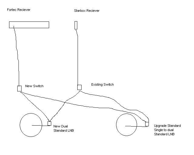

I ordered the S1 sytem from Sadoun with a 90u upgrade. I already have my eye on another satellite to point at:eek: . Anyways If I am understanding things right I will need to change the lnb on my current dish to a dual then add a second swith to the fortec reciever? Now would I need to turn lnb power off to either the fortec or my usb tuner?
I will draw a little diagram of what I am planning for wiring for you to check out later tonight and any input would help.

Welcome to the club!
If you don't need different polarities on the same bird I'd just slave the DVB card to the Fortec. If you need different polarities then both devices will need to power each side of the LNB.
no need to turn the LNB power off. Both will work just fine independently (if you hook each receiver to the LNB)

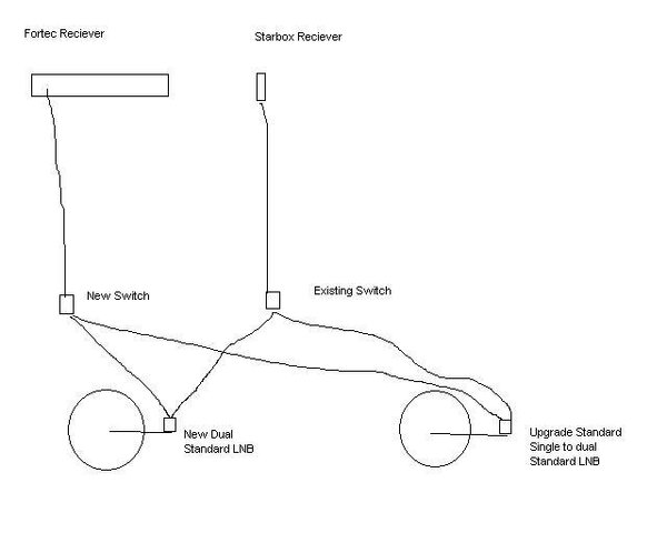

The attached Image is what I am planning on for my connection when I recieve my reciever and new dish from Sadoun.
