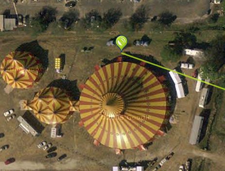

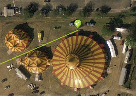

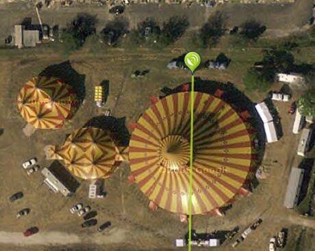

StoneCold , you're very fortunate to live down south because your elevation angle is higher , you benefit by being able to clear most obstructions.
If you do your homework you might be able to pick a perfect spot on your property that can see the whole Clarke belt.
I have included some illustrated pictures using a local Circus tent (Sarasota) to give you a better idea of what it might take to clear an object , of course it's a perfect scenario since I don't know what obstacles you have to clear. Buildings , palm trees , etc..
Your True south is AMC 9 @ 83.0 west. Dish Elevation 58.1
Lets say you want to be able to get White Springs on Galaxy 27 @129.0 west your dish elevation would be 30.2
at the other extreme you may want to see some channels from Cuba on Hispasat @ 30.0 west , with a dish elevation of 24.8
Using a compass you can get a pretty good idea of what you'll be able to clear.
That actually helps alot because I know where they set that tent up which is not far from my place and it sits in the same direction.
