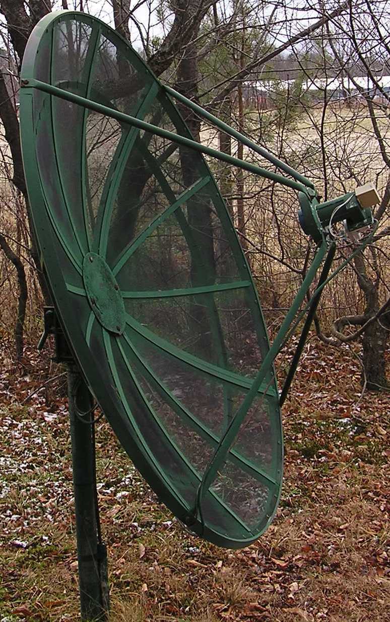

I hope this picture helps? Note where and how the LNB and feedhorn are attached.
jackpeas said:
Hello I am jackpeas In Chciago,ILL.I got a 5' ft dish and need your help with the centering of the scalar ring.Its has 3 leggs.I am using a c/ku feedhorn on it.Focal point is 23.10 and f/d is 0.39.Its on a base.I amtring to find 6 oclock,12 oclock,9,3 oclock. Help with any tips hints.You can YIM me,msn me,skype me jackpeas.Thank you Ken 2400 My southmost sat is amc3 or k3@87deg.
