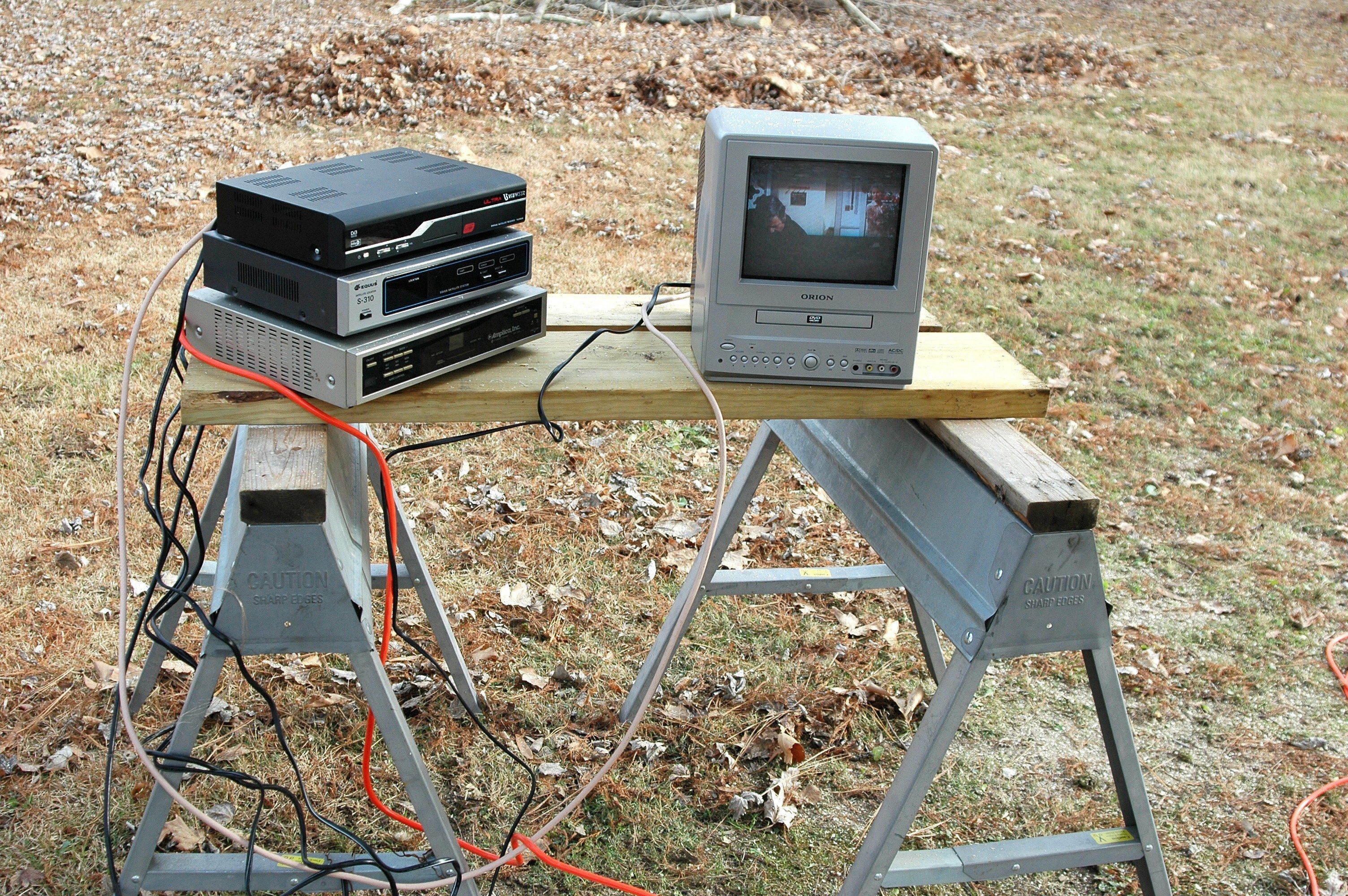

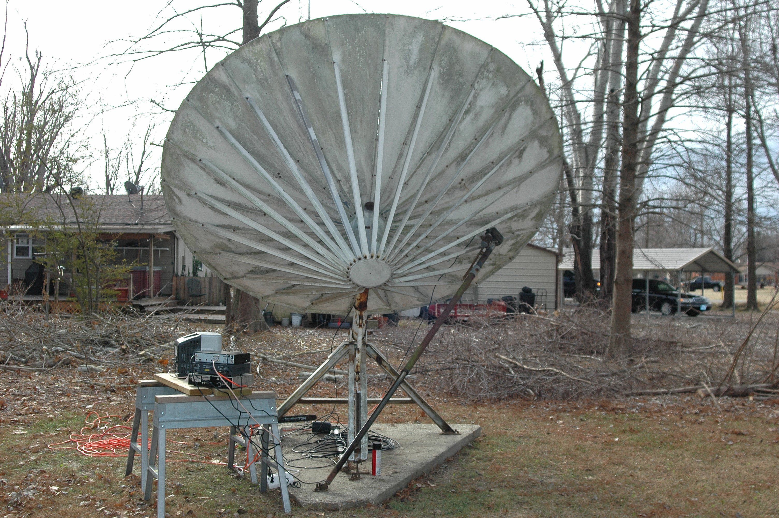

Personally I would take a receiver and TV out beside the dish before wasting time with a meter that provides minimal assistance with aiming a FSS dish and setting skew.
They either work or not. I would not recommend one over another. Some have indicators for 22KHz or polarity, but other than that, go for the best price.
Good info, Thanks. Kinda like I did when I got my old dish back going after 15+ years of idleing.

I use a small TV and an extra receiver to aim dishes. But when I tested the cheap signal meter inline with that setup at the dishes, I got dramatic differences in the indicated signal level on the cheap meter/beeper when changing to different transponders on the same satellite with the receiver. That's what got me to wondering, and the original question posted.
