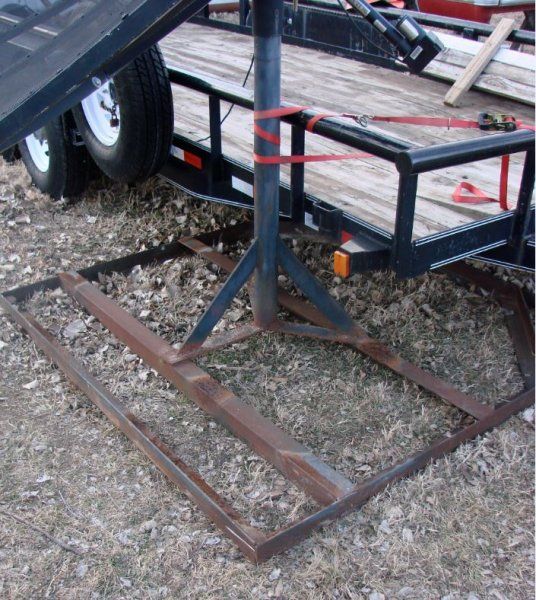

That being said, I would like to mount on a non-penetrating roof mount and I'm going to park it on that concrete pad for the time being. Ive been looking around, buying a new non-pen roof mount is really expensive and I don't even know if they are going to handle an 8 footer. I see the attached image by another forum member but i have never seen a non-pen mount like that.

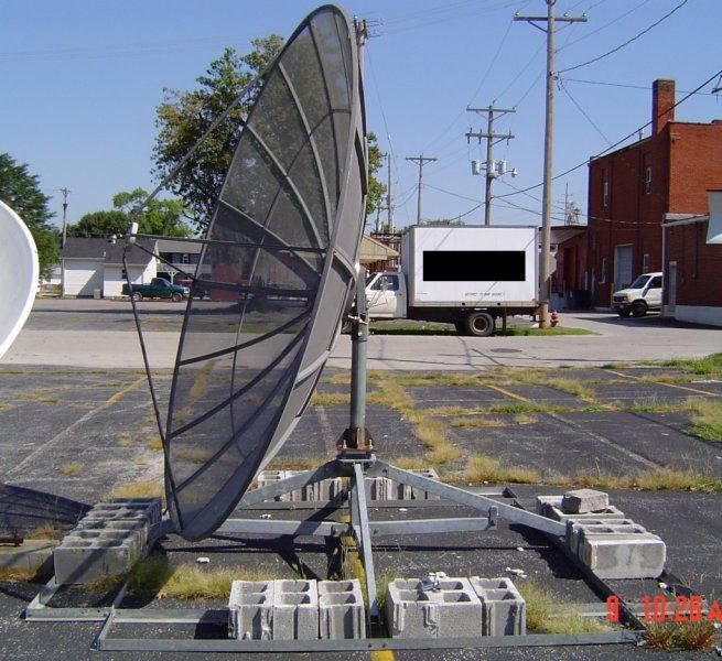

The image below is the NPRM that came with my 10' SAMI. I'm pretty sure it was done by a local welding shop. It's 1/4" angle iron and quite heavy by itself.

The most cost effective option would be to find/buy a mast with the correct size diameter for your dish mount and weld together suitable framing to hold the ballast. Ballast is typically concrete blocks although the DIY mount shown by Jason S shows some creativity ;) The mount shown in your initial post in this thread is a Baird PL-2 which typically cost ~1300 plus cost freight shipping with similar mounts from Rohn, etc. priced about the same. Finding a used one locally would be the best case scenario. Occasionally you might find one on Craiglist or Ebay. Typical commercial mounts are ~10' diameter to ensure mast stability although you could probably get away with ~8' if you go DIY. Refer to wind speed tables for your area to determine the amount of ballast, but for an 8' dish you are going to need 1000-1500 lbs depending upon max windspeed.
