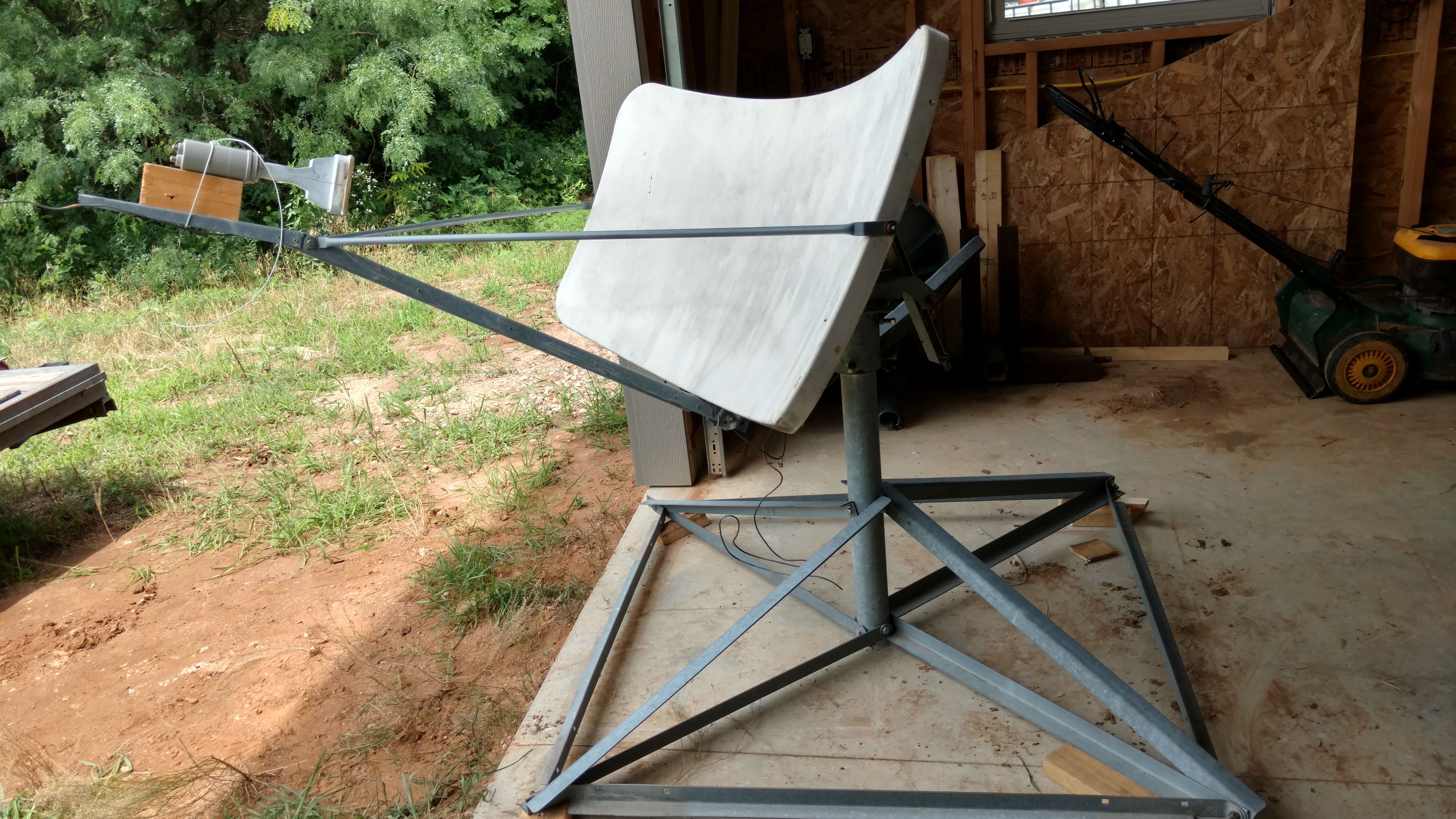

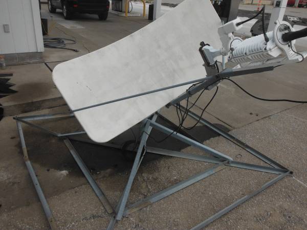

Found this dish, as identified in the C-Band forum:
Picked it up late last night by just putting if on the trailer and hauling it ~130 miles home completely assembled, which was probably a mistake. I rationed that the 60-80 mph wind blowing across the reflector wouldn't hurt anything. I didn't think of the mass and lever arm of the Rx/Tx assembly pulling on the feed support and stabilizer arms, which lead to the feed support mount at the dish breaking long with one of the side support arm mount holes in the dish. Oh well, live and learn...

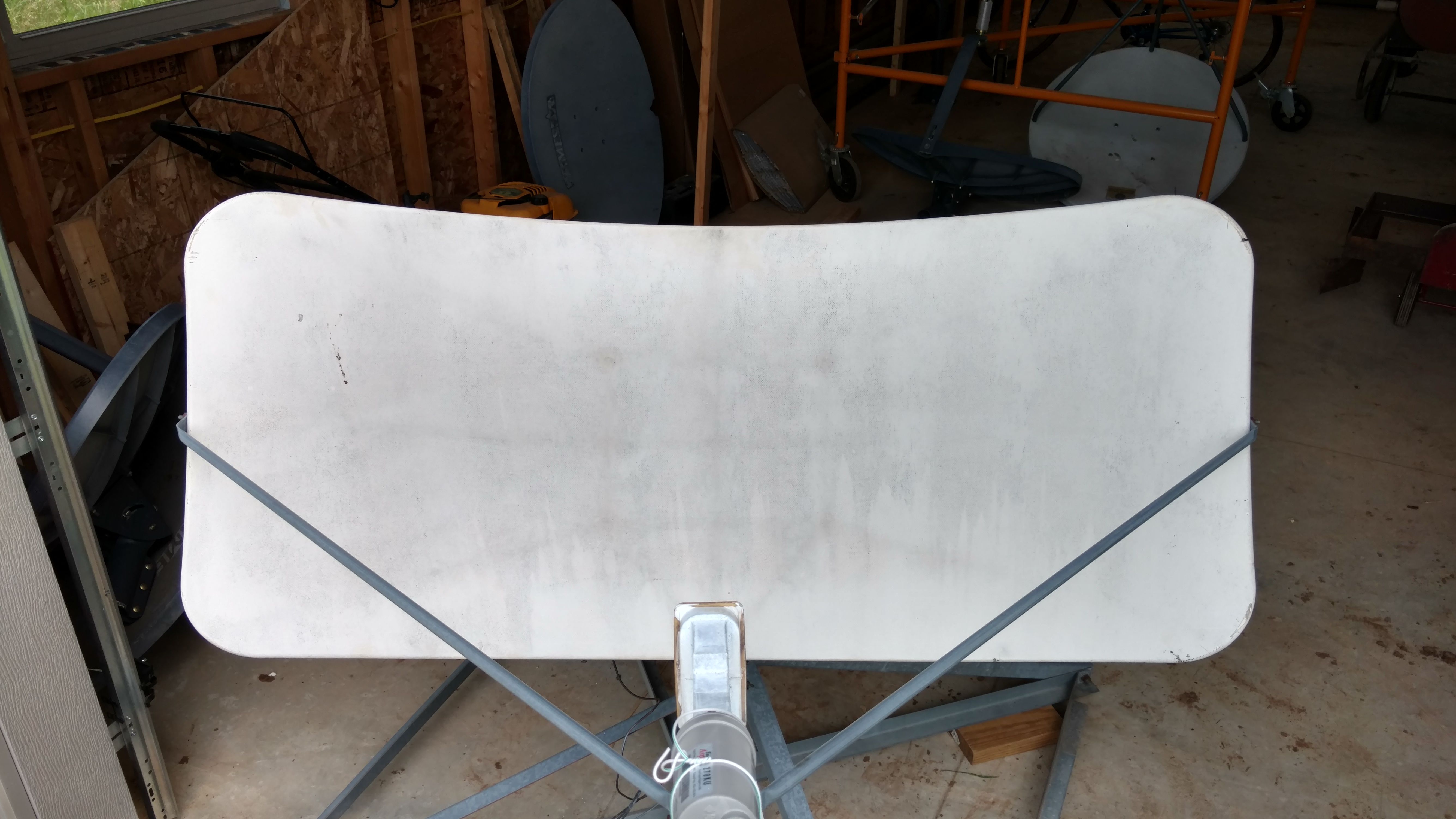

First thing to do was to cut down the NPRM so it's only about 4'x4' instead of 6.5'x6.5'. I don't kneed the size for stability, just a base to hold the dish for some testing. Here's the dish peeking out of the back shop door with the smaller base.

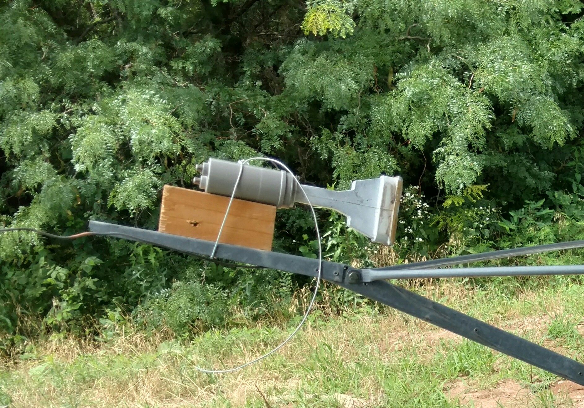

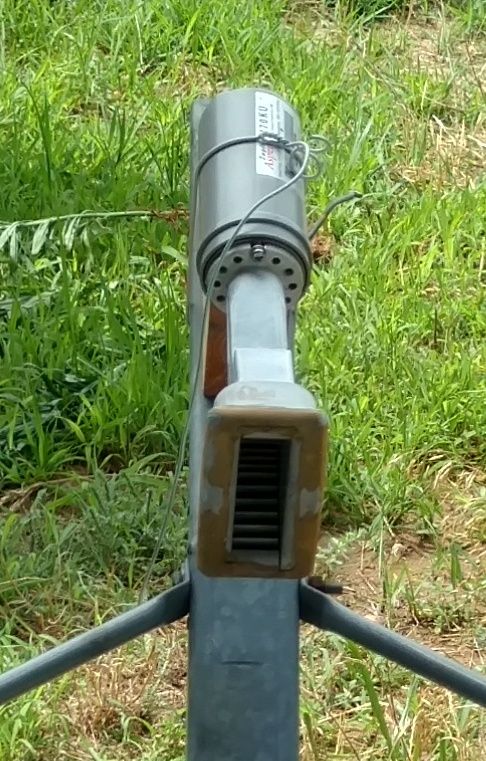

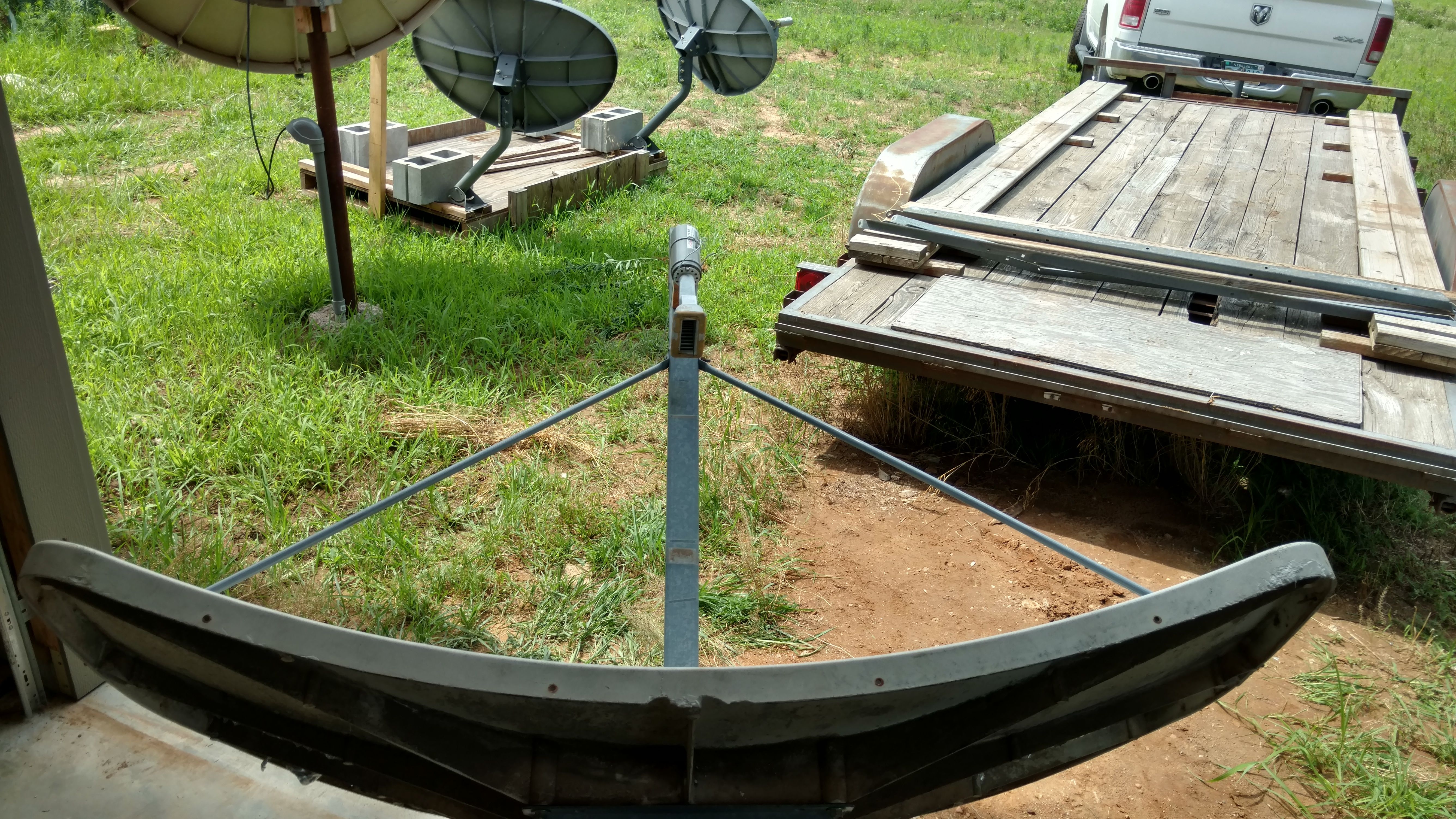

This is the Tx/Rx with the feed for the reflector. My goal was to reuse the rectangular feed horn with an Eagle Aspen 270 Ku LNB. This was pretty simple to do. Only the feedhorn mounting holes needed to be elongated to let them mate up. Here's also the new LNB and old feedhorn temporarily tied to the feed arm in the proper position.

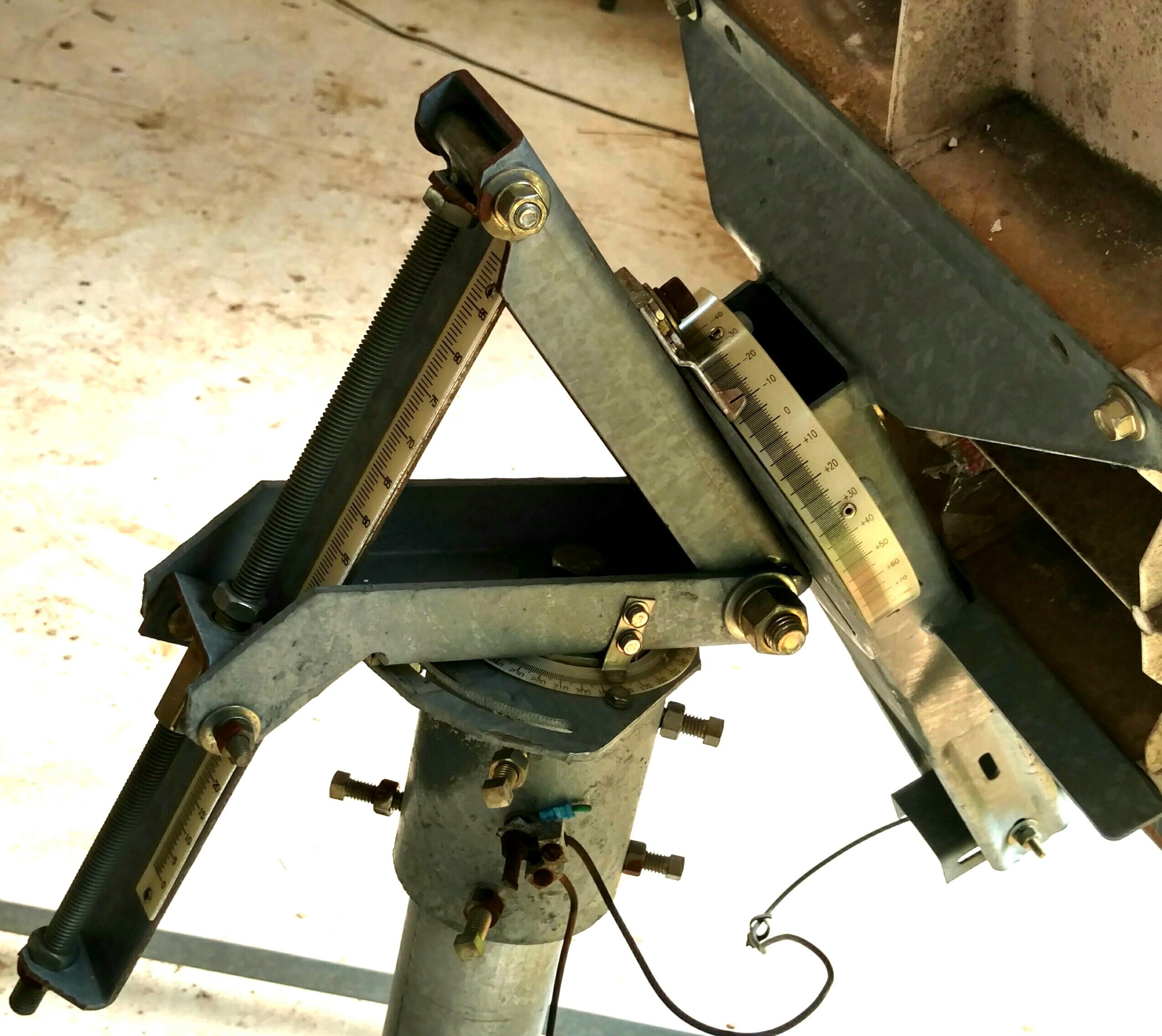

The mount is a EL/AZ with Skew. All aiming axis have scales that are fairly accurate.
97w was easily acquired, along with 87w, 103w and 125w. The scales are by far the best of any dish I've used. Just swing them around to the numbers you need and the sat is right there. Nice!
I used the RT and NHK transponder off 103 to jusge performance. I was easily able to get 15.8 to 16.0 c/n on the SH200 meter on 11940 V 20000. Not sure how that compares to my other dishes, I'll note c/n for the various dishes when I get to getting them put in service.
The reflector is 23.5" wide by 53" wide.

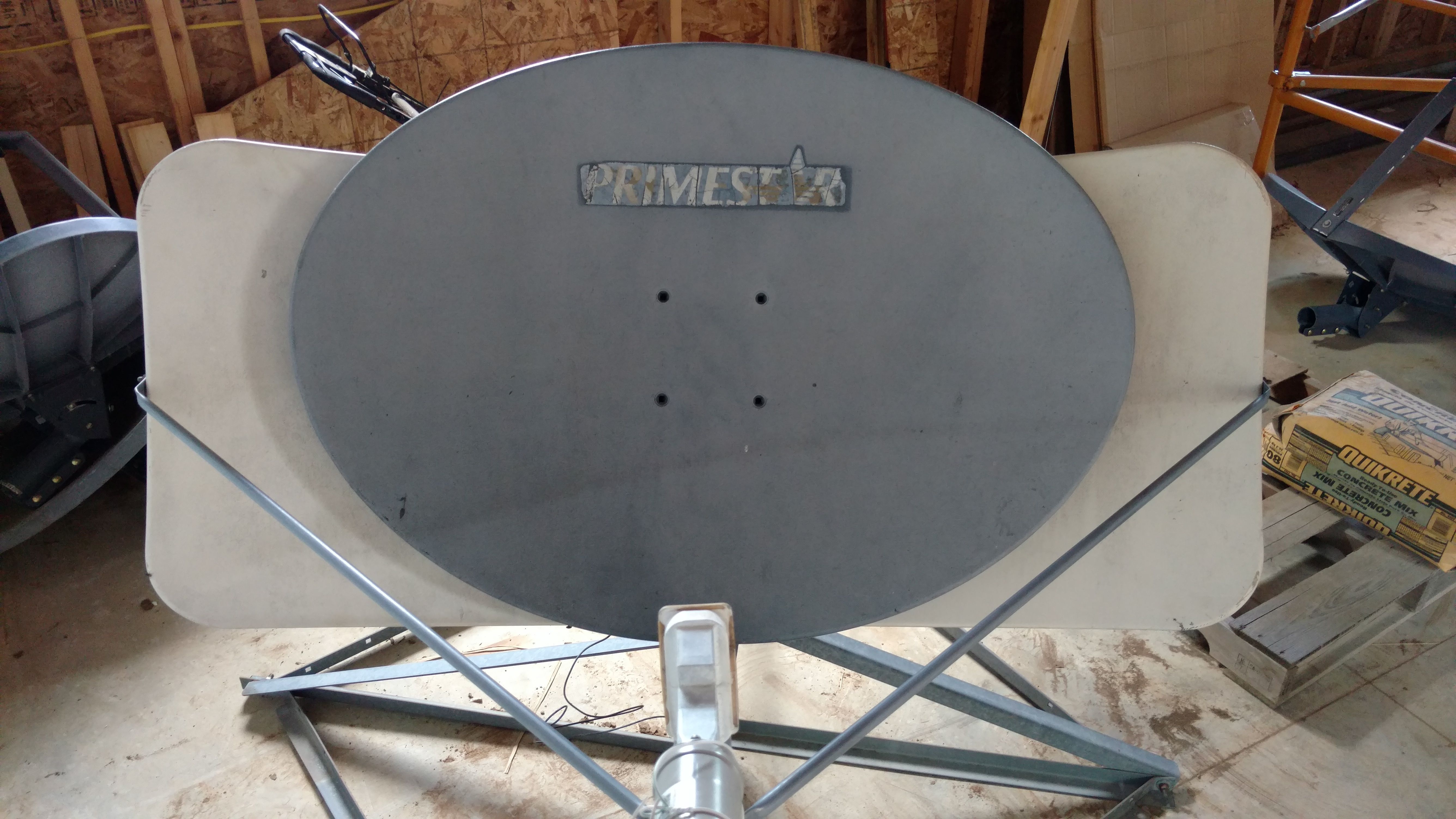

A couple last photos, one with a Primestar 84e reflector laid on for comparison. If anyone has an idea of what this is, please inform! I've looked at Prodeline Hughes Earth stations and cannot find anything. I did find the TX/Rx assembly, but that wasn't that much help, and n ow I can't "re-find" it again.

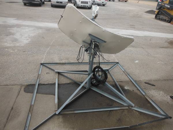

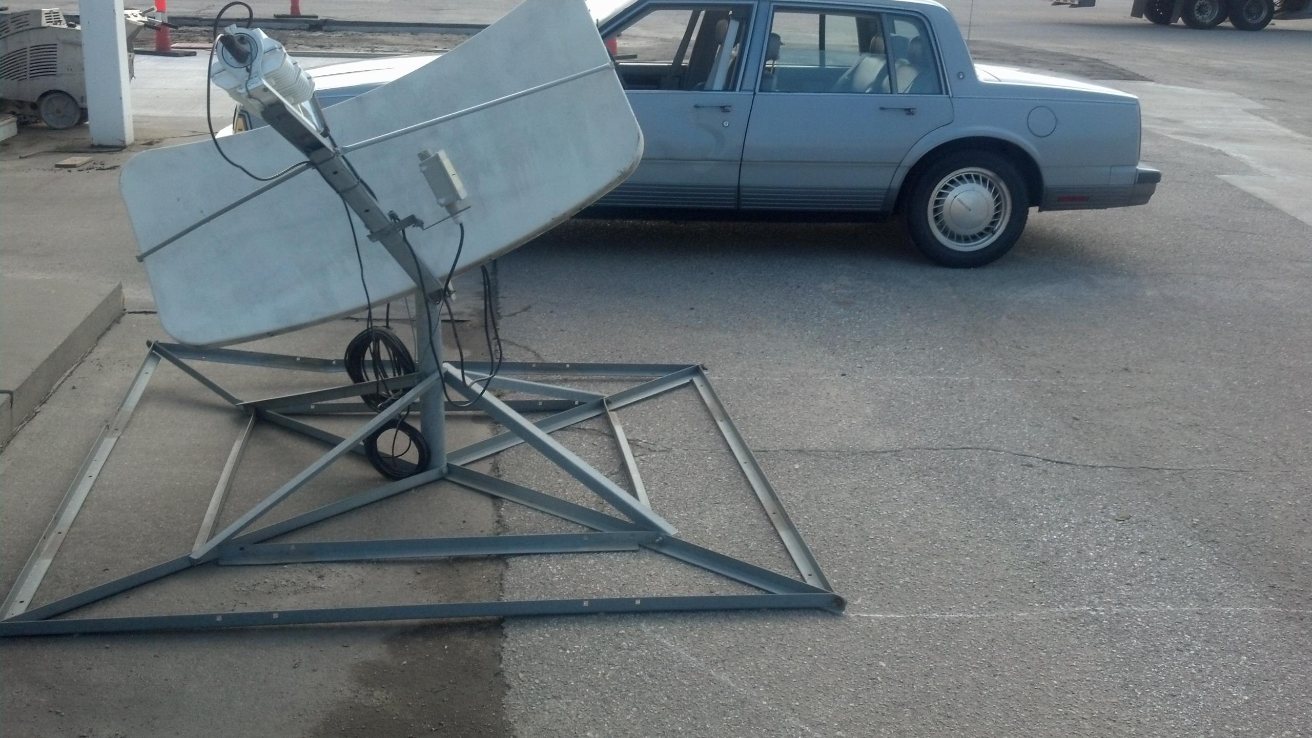

I've seen those at remote gas stations around here. They are used as transmit/receive stations for credit card authorizations. Not sure how good it would work as FTA, since the aperture is quite small. Might be good for mounting multiple lnb's using creatively bent EMT, and receiving 2-3 sats at once though
From my limited testing today, it's a good performer for Ku service!

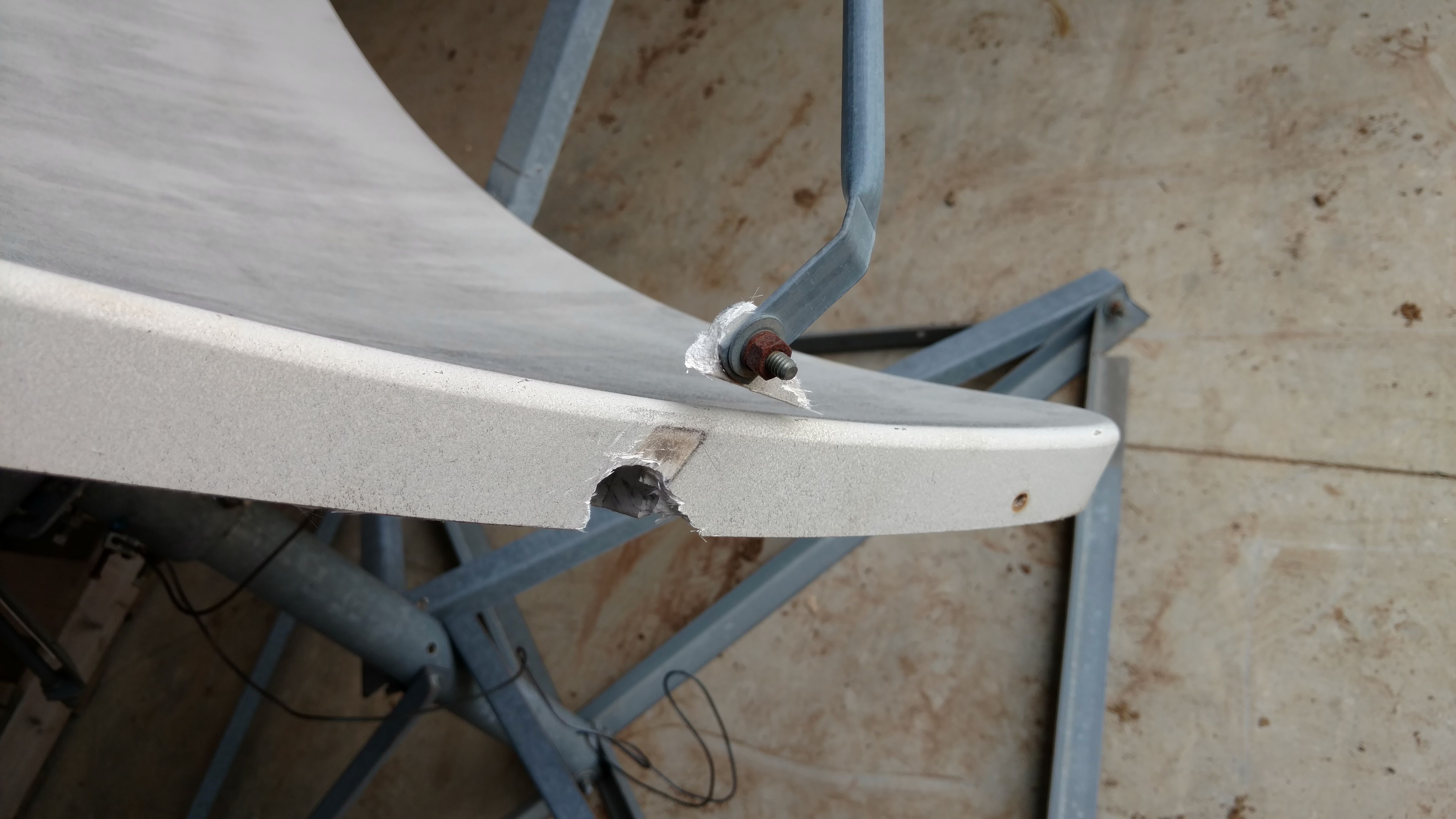

I seen the same thing around here with the gas stations around here they also use it for the lottery since it is more secure than over the internet. That dish is a nice though you can make a brace to fix the fiberglass where the support arm is look at my dihs for example.

I am going to use the original feedhorn to get its benefits. This gets both polarities without issues. The waveguide of both the feedhorn and the Eagle Aspen 270 LNB are round and almost the same diameter. They seem to work OK together.

The wave guide polarizer (correct term?), as I understand them, divert only the V polarization and pass the H straight through. Orthomode blah blah blah... :D One thing that stuck in my mind was "remember Horizontal is Hard to bend".

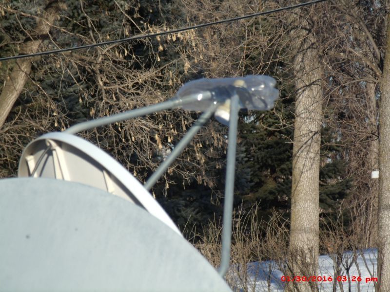

Appears that the 'bug shield' is missing from the feed horn.
Think I'd cut up a soda bottle, Flatten out a section with a heat gun and use some silicone to glue it over the opening.
Reactions: beavs2112
Good point.
Is plastic generally transparent to Ku signals? Think I'll try something flat like a cool whip container lid.
Poly materials create an insignificant attenuation, but when water sheets or streams the surface becomes a RF shield. When you're done installing the cover, coat the surface with some rain X or other beading compound.
