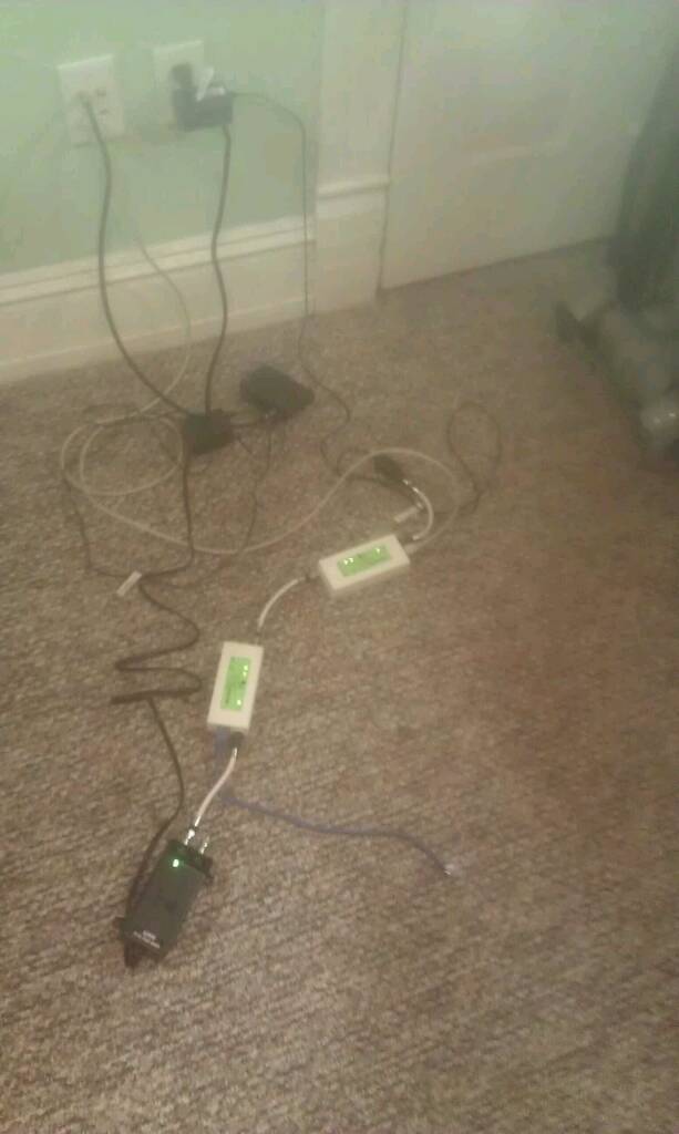

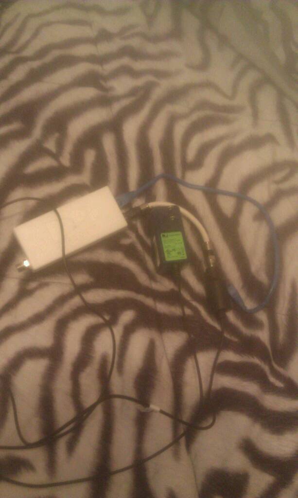

Doing a bit more research (me playing with toys) i connected a white deca to my home network, and put a power inserter on the to receiver end. I then connected the coax (to another room in your case) to the coax in of a second deca and plugged a power inserter into the other. All lights go green, so it looks like you should be good.
In pic, grey cat5 is connected to my wallplate (internet feed)
Two power inserters used, blue cat5 would go to computer.
Excuse the extreme cruedness its cold and i just ran to my truck in boxers, but this should work.
Sent from my PG06100 using Tapatalk 2
