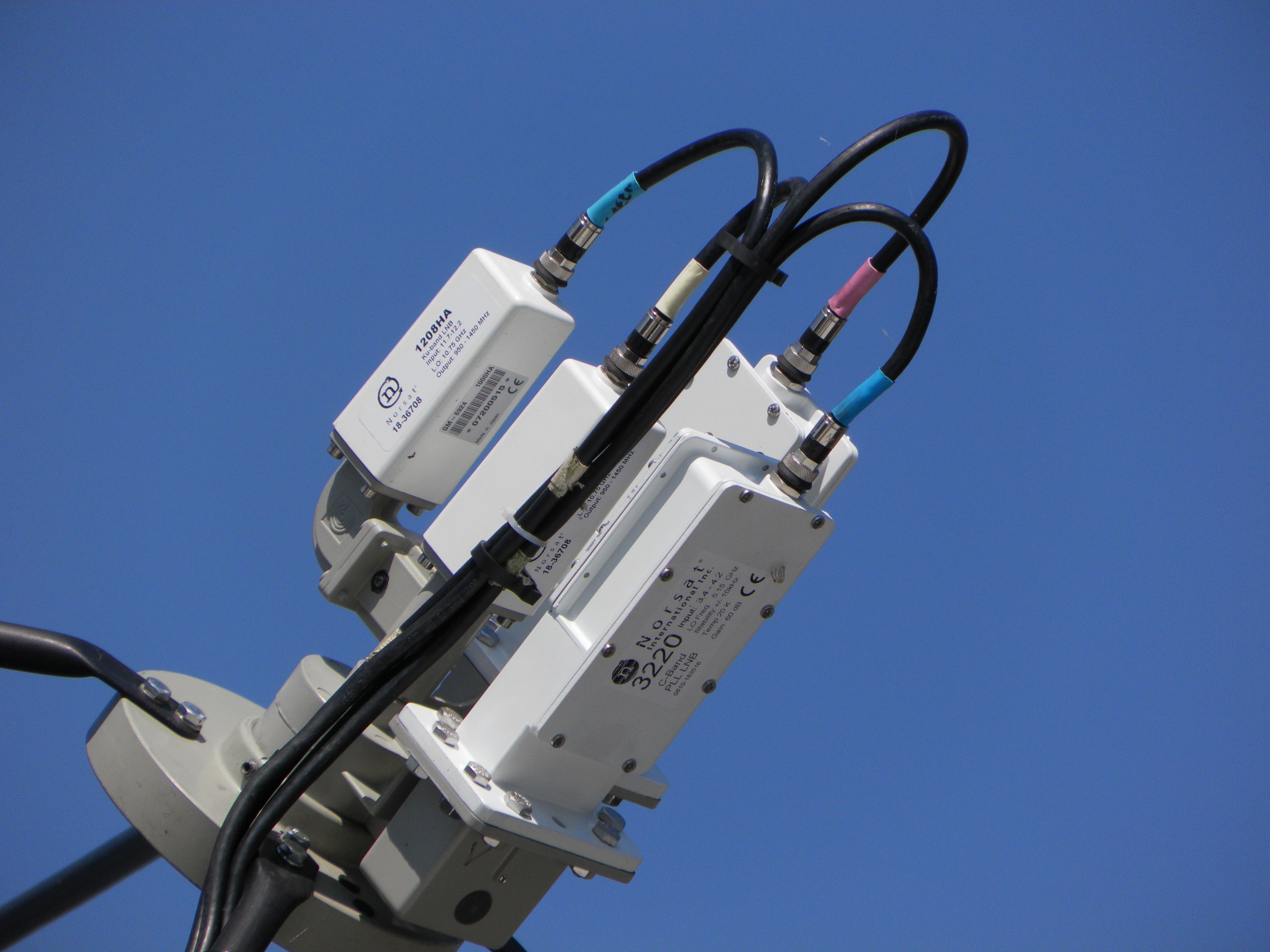

That being said if money was no object I would have a Co-rotor with Norsat 3115 lnb.

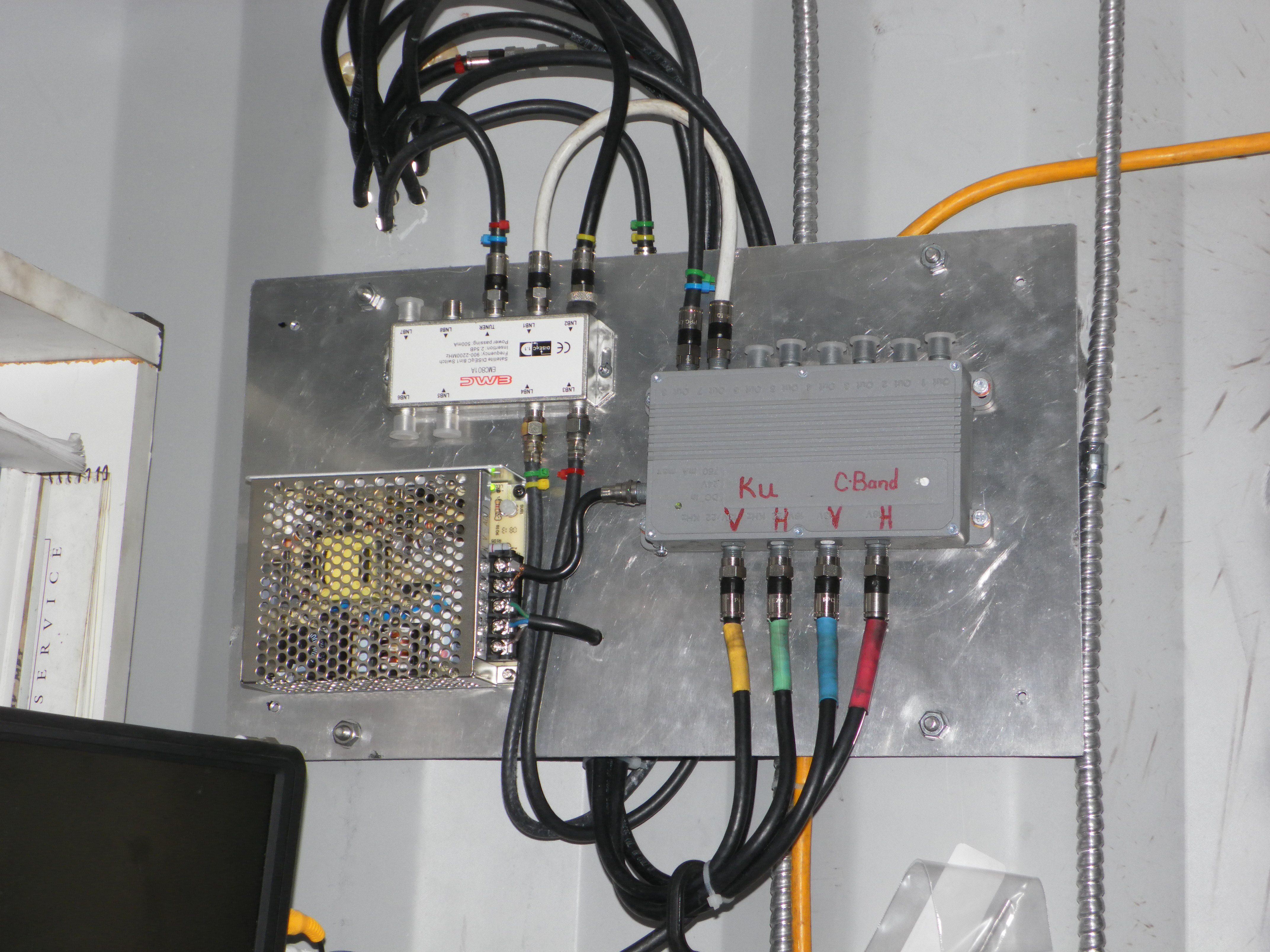

I use a Bullseye II and 4 Norsat PLL LNBs
Bullseye II and PLL Norsats.
Likely $1800 or more, just for the focal point. Then there's all the power inserters, switches, and cabling!
Corotor works real good with an ASC1 though...
-C.
magic, could i trouble u for a shot looking in that bad boy.
It does look like something i might be interested in also, if i had money that is... any idea on the cost of that system?
I don't really have a shot of that unit. I do have a shot of one similar for wideband circular.
I guess the retail on that one is about $1200 but I shopped on eBay and spent about half that. The switch and power supply was about $50 when it was all done. The power supply that comes with the switch is not beefy enough for 4 PLL LNBs. On second though, that pic is this unit. there is no dielectric blade in that one.

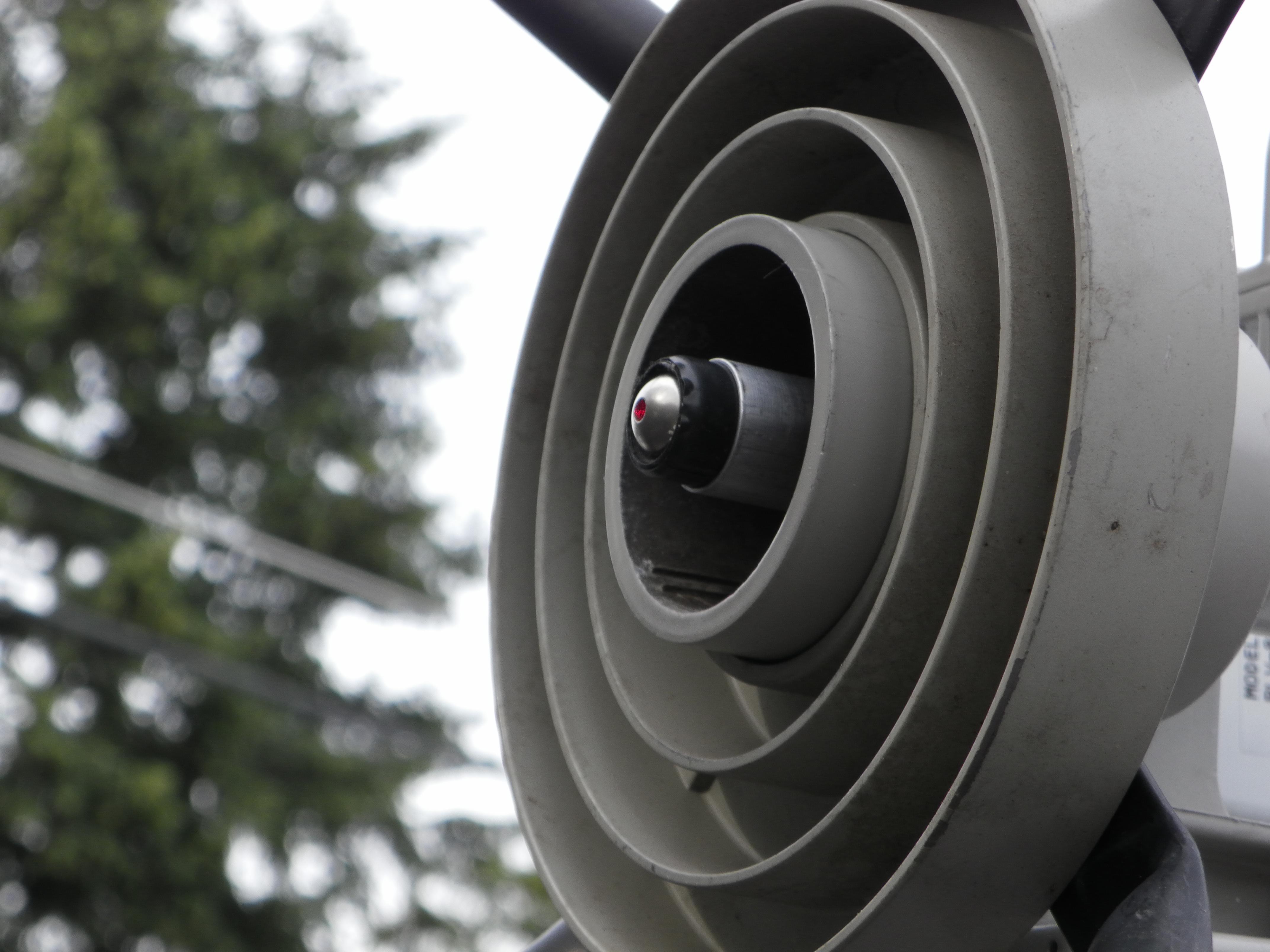

Currently on my 12' dish I have a button hook, but I am thinking of putting on 4 guy wires for further alignment of the button hook. I do believe that there are better LNB's out there and prefer new to the used one I have. I will continue to fine tune what I have currently until I get a new LNB. I am also placing an actuator on the dish as well once I get one of them, until then I will be locking onto one satellite.

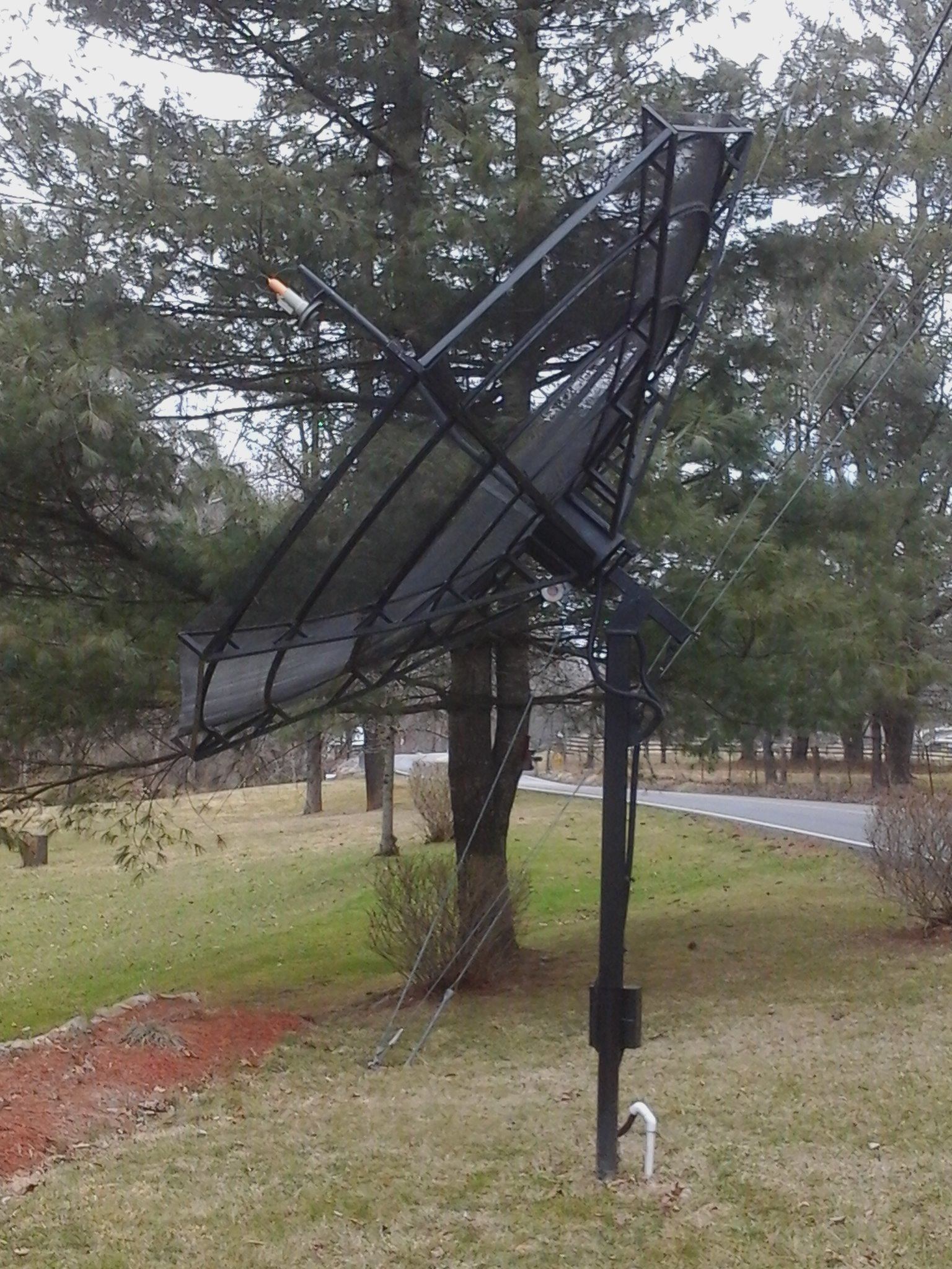

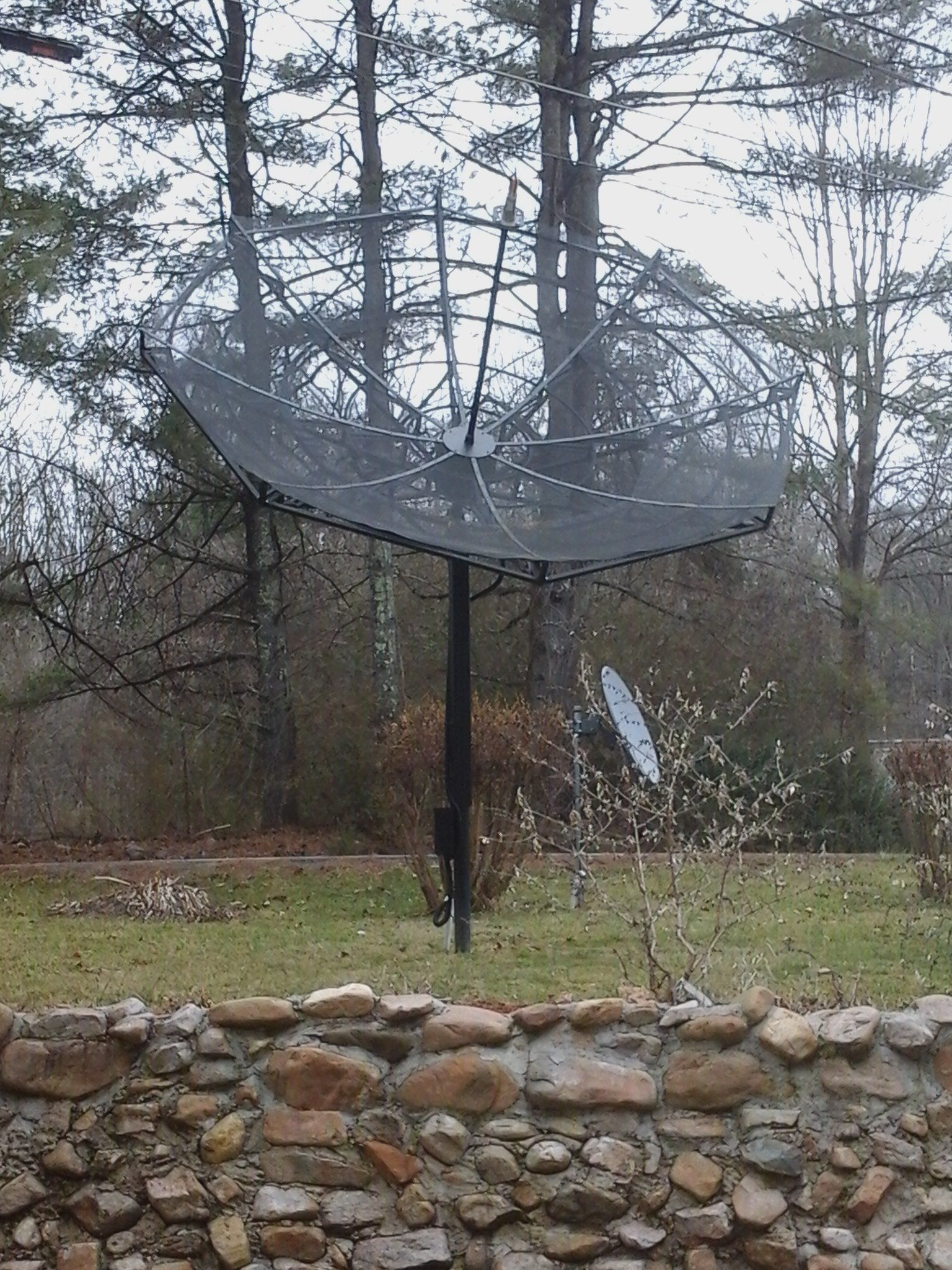

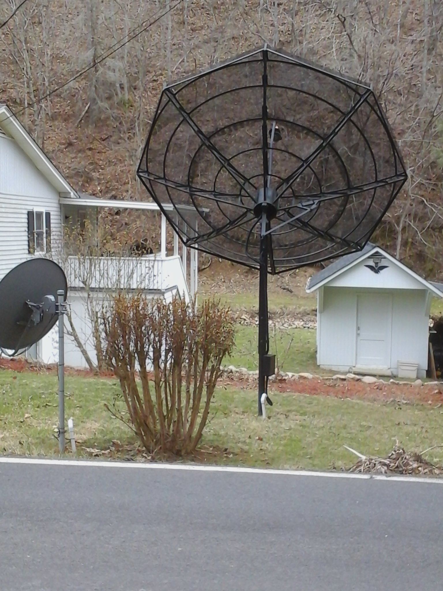

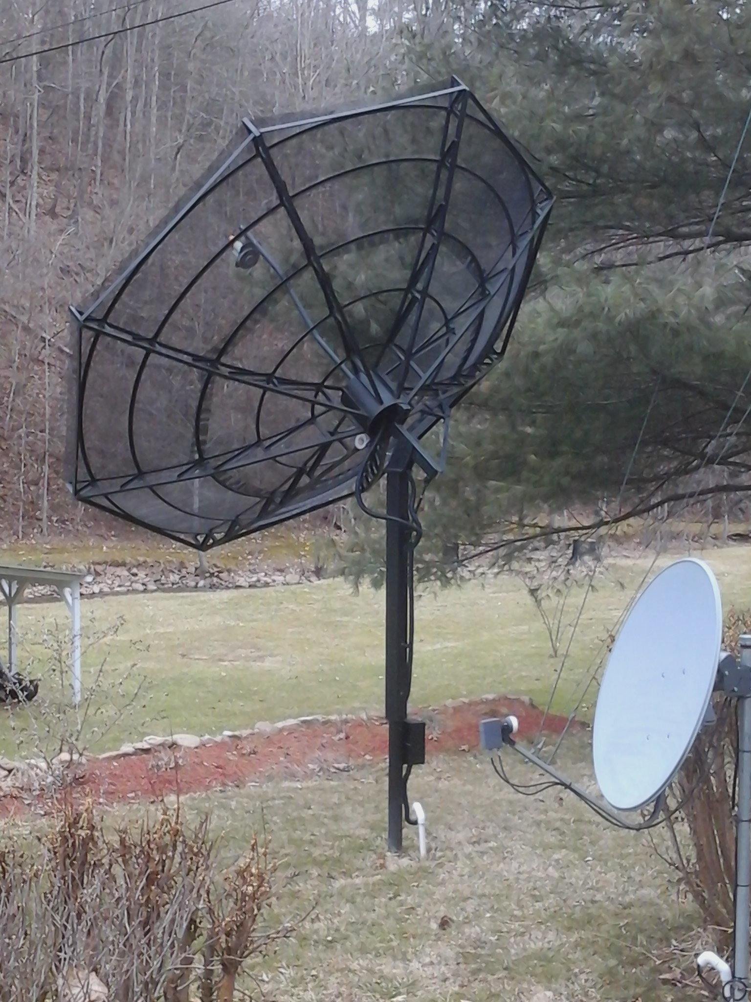

Ok FaT Air now that I have managed to upload some photos to the site which I consider an accomplishment in its self due to the time it took me to figure out just to do that they are here for the viewing. Now I realize the orientation is off but still here they are. In the afternoon when the sun is out, I shall gather more information regarding my system and how it is hooked up. But as you can see in 3 of the 4 photos you can see my smaller ku band dish.

Your approximate location is 36.47,-82.27 so 83W is almost due south. Dish at apex, should be able spin the mount/dish on the pole to tune in the PA channel, freq 3804 Vertical pol, SR 4167
Another thing that may be the problem is skew. May be backwards. Don't know, for sure, but the "0" skew mark may have to be placed at the 3 o'clock position. (Might just program the polarity as H ??)

Thank you I will add your page that you have published to my folder of printed material for FTA dish's. Always looking for good information to gather as you can never have enough info in your arsenal to set these dishes up. I tend to print out a lot on this type of material as it seems some websites lose links or go down al together. Below are my stats based on 83W with the exact location of my dish form http://www.dishpointer.com/. As you can see you were very close in locating me. If you happen to put in those coordinates you can see what appears to be a light colored plus sign/cross. That spot is when I was cementing in my pole for the dish and the pieces that make the cross were 90 degree supports for the pole so that it would stay plumb. and if you were to look at the right of that, the little grey spot is my small dish. That photo must have been taken 1 1/2 years ago to 2 years ago as that is when I started in this new hobby. I am also planning on getting my complete system specification but currently I am doing a little pre-spring cleanup in my yard and building a pile of brush to burn to reclaim some of my land that has seem to attracted unwanted visitors in my yard.

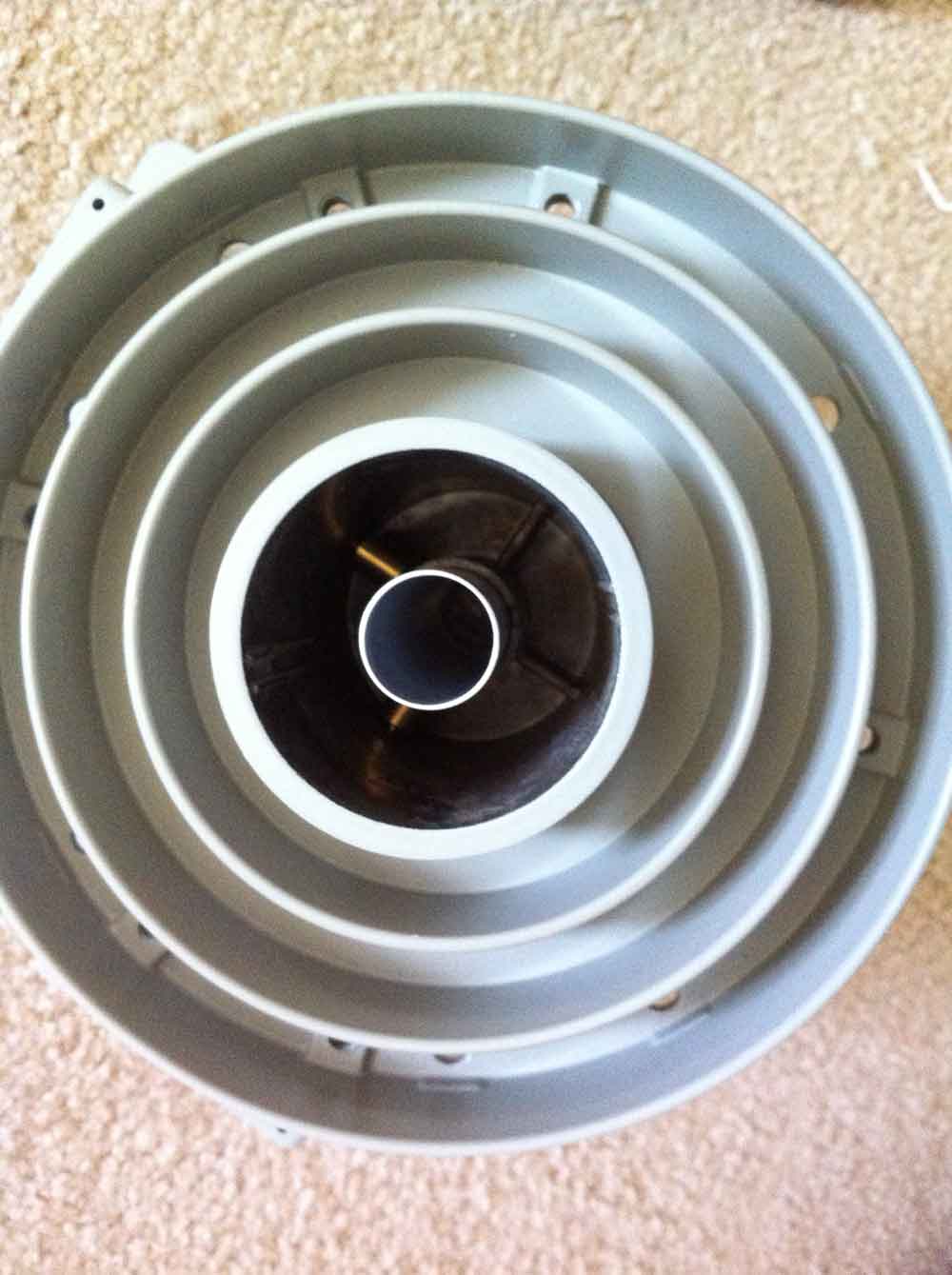

New Feedhorn
