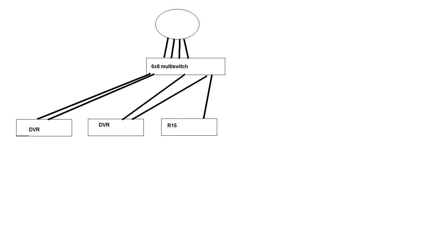

You would run all 4 lines from the LNB to the switch. Then 2 cables from the switch to each of the DVR's and one to the R15

Option 1 buy a 6x8 hook the 4 lines from the dish in to the sat in ports (ignore the 2 flex ports)
This will give you 8 lines out.
Option 2 (assuming the other 2 receivers are DVR's) switch one to single tuner mode, and unhook tuner 2. Install the r15 only hooking up tuner 1 and running it in single tuner mode too. No mutiswitch required for this.
BTW, if you decide to go with option 1, did you consider that you need 2 cable runs to the DVR to get both tuners working?
