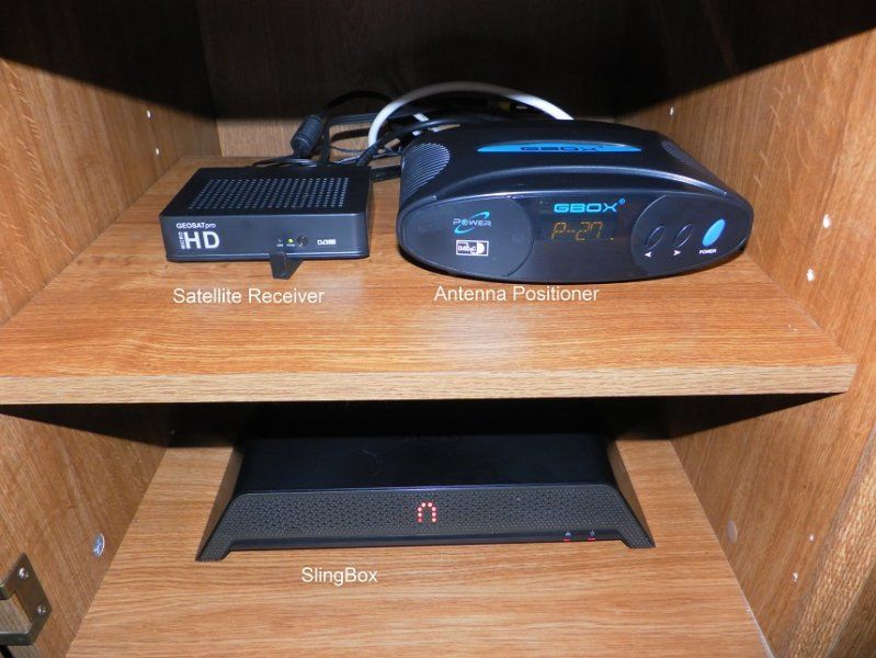

PC tuners can be a challenge. I never knew how much because I found out about FTA through a DVBS tuner. I found one in a computer surplus store cheap and never heard of doing FTA satellite on a computer or an STB. I fell right into it (backwards I think) and became hooked ;).
But as Comfortably_numb suggested I use a Slingbox, one of the first ones that have a ATSC tuner built in for accessing my system away from home. I let my cousin in The Netherlands watch some stuff occasionally too. Setting up a remote can be the challenge with a Slingbox.
This is true. It took me awhile to find the remote control file for the Amiko receivers, but luckily Slingbox allows users to code their own custom remote files, and I found one online that worked.
