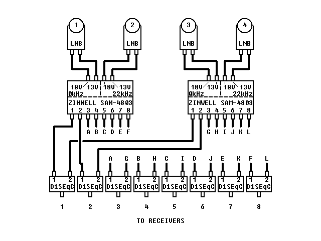

Once I saw this beauty I had some ideas, so here I am to ask if it's possible. The attached picture shows my ideas. And that's the simpler version, you can easily double it with 4x1 DiSEqC switches in place of the 2x1's.
Basically if it's doable, you could see 8 different satellites at all times, with up to 8 completely independent receivers, with no motoring. That's enough receivers for a nice whole-house setup for most of us here! Quick checks of what's available FTA (DVB only) on my 8 favorite satellites (Ku & DBS only) gives me a count of 97 English language channels, all instantly "tune"able! :cool: The downside is it will be costly up-front, and you will of course need to set up 8 dishes (or if you're good at putting LNBs next to each other, maybe less). But in the end it's nearly 100 quality all-digital channels for free, LEGALLY. And that's just the English language or otherwise 'interesting to me' channels, there are well over 100 additional international channels on those same satellites!
From what I've read, the DiSEqC switches should come before the 22kHz ones (as going from the receivers) since DiSEqC will pass through all 22kHz activity (continuous, bursts, DiSEqC data). The 22kHz switches won't necessarily pass through DiSEqC data. The setup can be quadrupled, for 16 satellites, with 12V switches, but my receiver doesn't do 12V :(.
Of course you could put one or more motors in there to complicate things but it should work. I would put motor(s) before the DiSEqC switches.
Finally, each receiver would need to use the following settings for each satellite (LNB):
LNB 1: DiSEqC port 1, 22kHz OFF
LNB 2: DiSEqC port 1, 22kHz ON
LNB 3: DiSEqC port 2, 22kHz OFF
LNB 4: DiSEqC port 2, 22kHz ON
If you double the picture with DiSEqC 4x1 switches:
LNB 5: DiSEqC port 3, 22kHz OFF
LNB 6: DiSEqC port 3, 22kHz ON
LNB 7: DiSEqC port 4, 22kHz OFF
LNB 8: DiSEqC port 4, 22kHz ON

yes it is possible...but unless you have a huge family and lots of money, it's not really cost effective. A motorized unit is good. Why would you need fixed dishes? It isnt cost effective to put up a fixed dish for G3 as an example (unless youre a Sioux fan) or at 87 (for Montana PBS).
I would like to have a fixed dish at 74, 85, 95, 123 and a motorized sometime down the line, but due to the up front cost, its not feasable. a motorized and a fixed dish on 123 works fine :)

If you read closer, I mention that this is the 'simpler' version and can be doubled with DiSEqC 4x1 switches to see 8 satellites.

Well here's what I would look at:
1: G10R (the best and most stuff)
2: IA 6 (good news channels & feeds)
3: AMC 5 (Empire Sports Net, especially when they're showing billiards!)
4: IA 5 (2 music video channels, FashionTV--if they ever have bikini modeling ;), & feeds)
5: AMC 3 (PBSes including the only DD I've gotten, or The Patient Channel if you're real bored)
6: Echostar 6/8 (GolTV, PPV previews)
7: Echostar 7 (NASA TV, Angel One, the Charlie Chat channel :))
8: AMC 4 (KUIL FOX 64 TX, People's Network)
These are kind of in order of preference if I had to go with the 4 sat version for example.
And all of this is just kicking ideas around for fun, I would never put up eight dishes on my roof, at least where I am now. Nor do I have that kind of extra 'hobby' cash very often. It's like my own little version of 'millionare toys'. :)
agree
agree
maybe...could use the motorized
nah..use the motorized one
Since the 1500 doesnt support AC-3...can use the motorized
nah
yep
eh..use the motorized
Would like one for SBS6 and AMC9..right now have one motorized, one for ExpressVu 91, onre for Dish 119 and a fixed at 95.
exactly.....we all can dream :)
