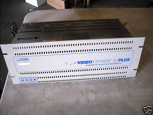

I was at work when I read your comments. Now that I am home and ready to try, I am still a bit confused. Would it be OK for me to post a picture of the VCII module so you guys can see it?
Thanks. I just wanted to make sure. I don't understand how this big bulky unit will fit with my 4DTV922 receiver. I may have bought the wrong one. Let me know what you think.

That's a commercial VC-2 to hook that up you would go baseband out of the 922 to the descrambler then run A/V leads to your tv.

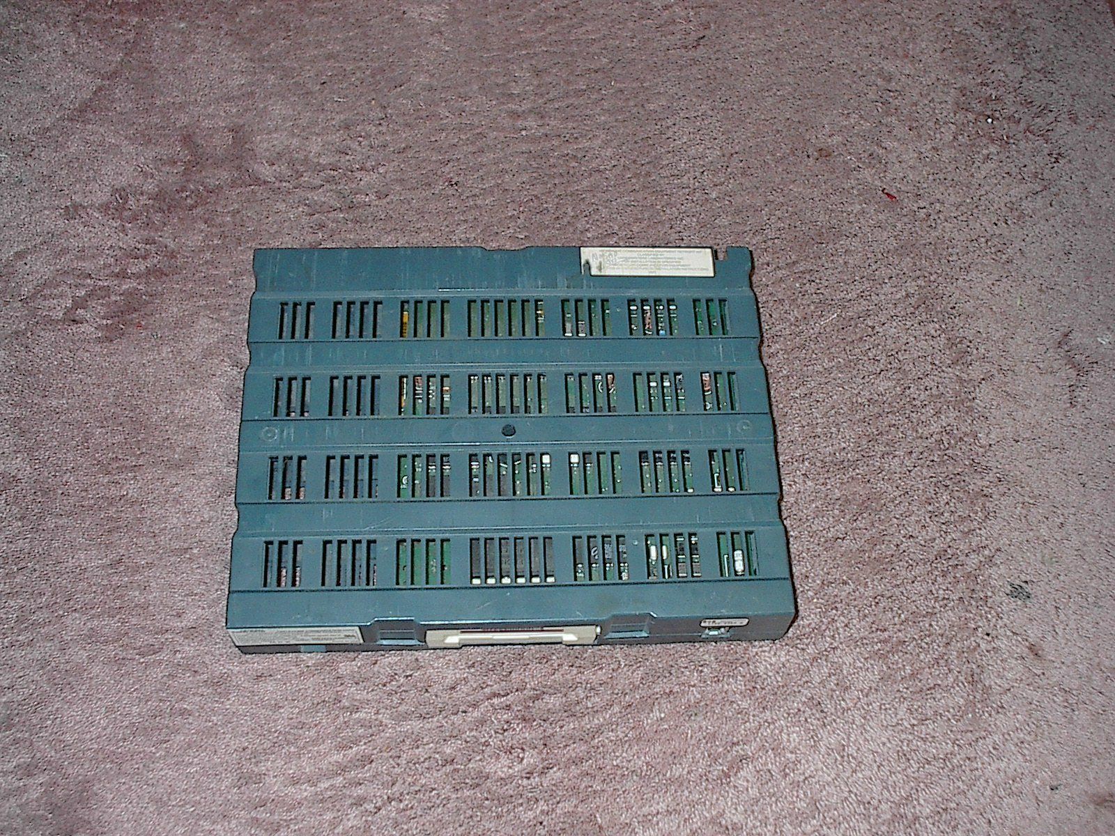

The VC-2 module for the 922 is the picture I'm attaching.
