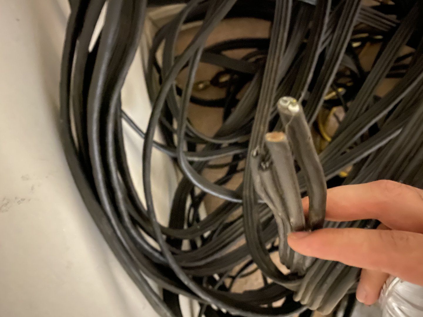

The dish is going to be put in my uncles backyard because I can't see the Clark belt from my backyard. We already started digging and bought a schedule 80 pole. Have to concrete it in and put up the dish. I got a 8 foot mesh dish brand new never used off a former installer, a local member will help me aim it. I also bought some ribbon cable which has coaxial cable and the wiring for the actulator and polarizer etc. We plan on running the wire along the fence. I think it will go well. But with the pandemic happening im self isolating so we've left everything on the back burner for now. But I plan on finishing the pole soon and assembling the dish and getting assistance on aiming it and after I've drilled some poles and placed the wiring setup the receivers and I can't wait to see that analog cspan channel and the wild feeds in HD.

Cyberham: believe it or not, Robbie posted it literally a day after I asked about the analog signals so I saw the video as soon as it was posted. Very interesting although his signal wasn't coming in so clear. Now as for my install I'm just waiting for my friend who will help me install the dish as I have all the parts for my dish now. Might have to extend my pole as the shed is kinda in the way but progress is coming along. I also saw something on galaxy 12 or 13 about ntsc feeds but doubt they're still up, can't really find out until I get my dish up. But I also saw some exciting videos on live wild feeds of various places they're digital but it seems fun to watch.
