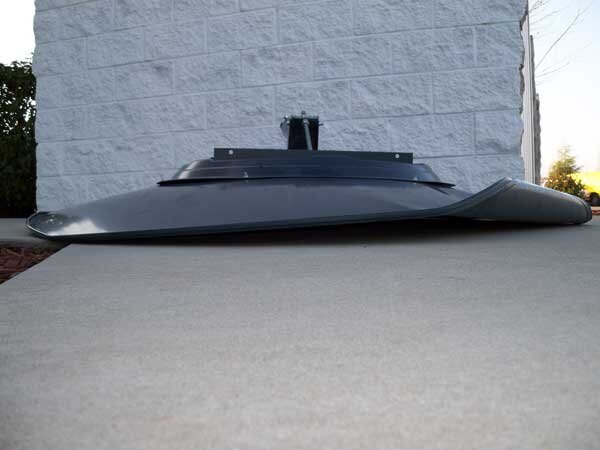

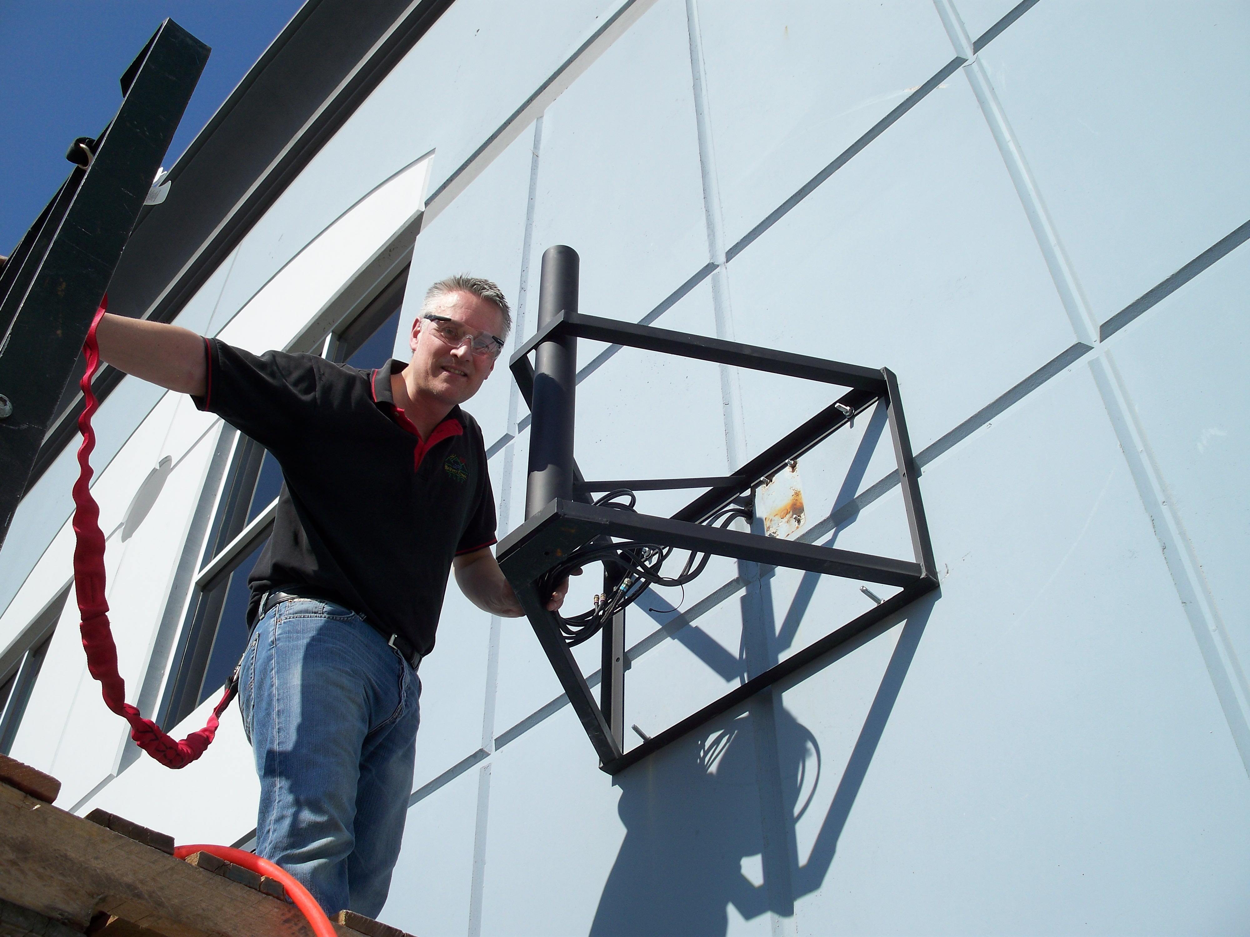

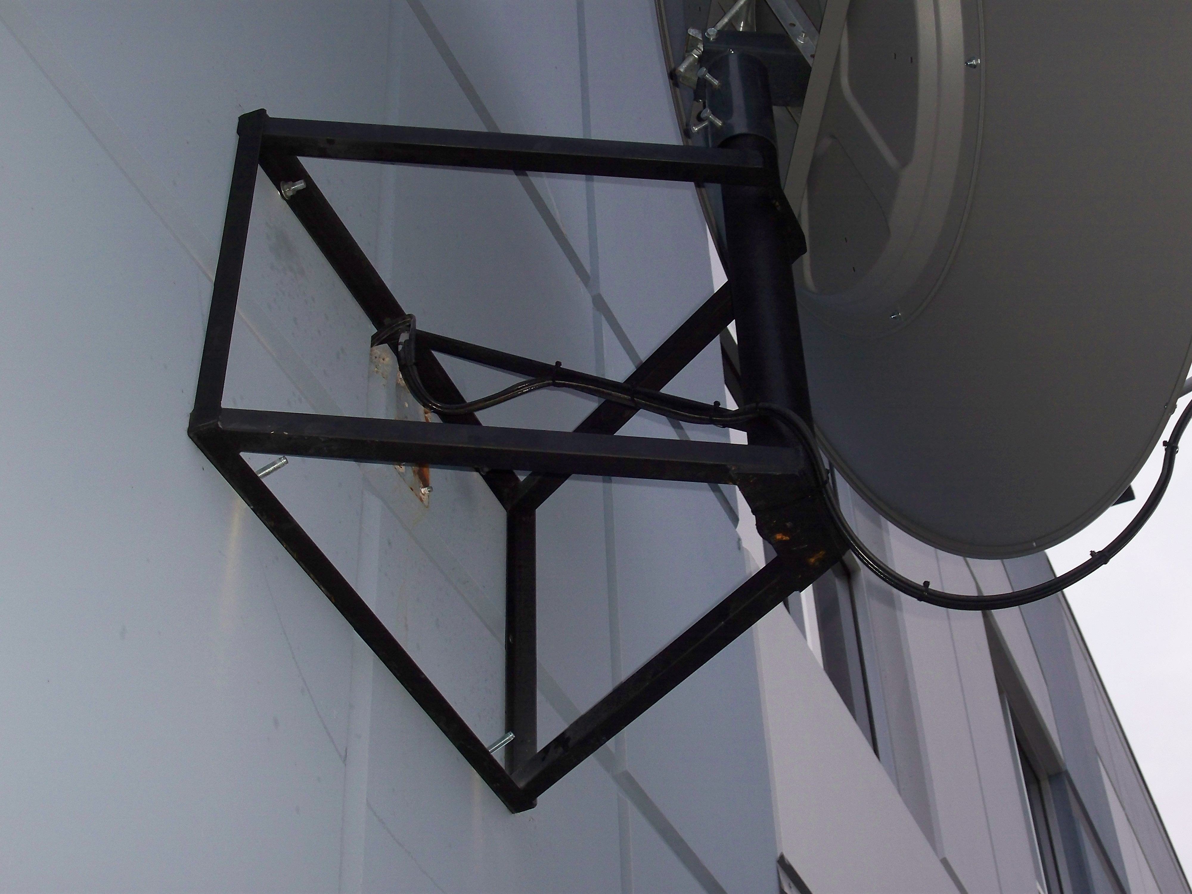

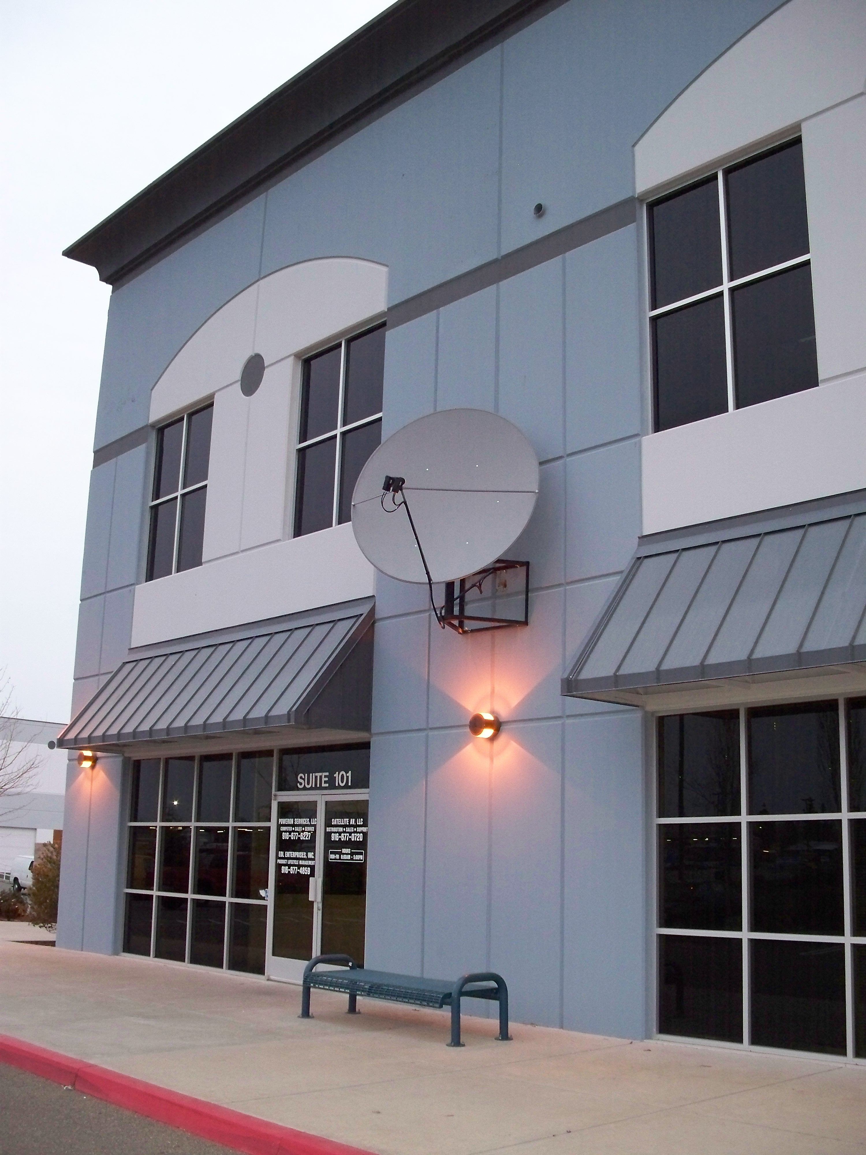

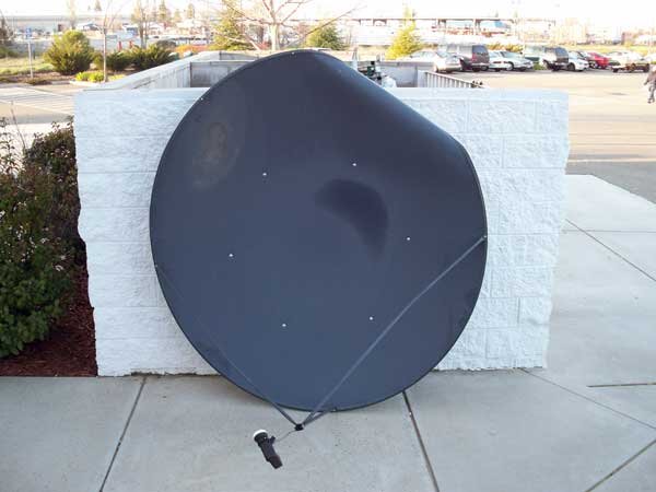

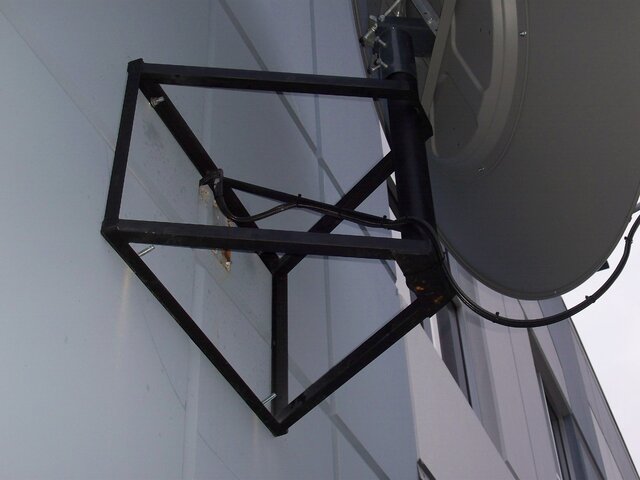

Here are some pictures showing what can happen with a 6' dish on a wall mount steel post with tripods in unusual heavy winds in Northern California (70 - 80+ mph gusts). The replacement mount was built by a local fab shop supports the GEOSATpro 1.8M on the front of our building.
I have a photo showing 4 of our warehouse guys doing chin-ups after the dish was mounted, but can't find the shot. :(
